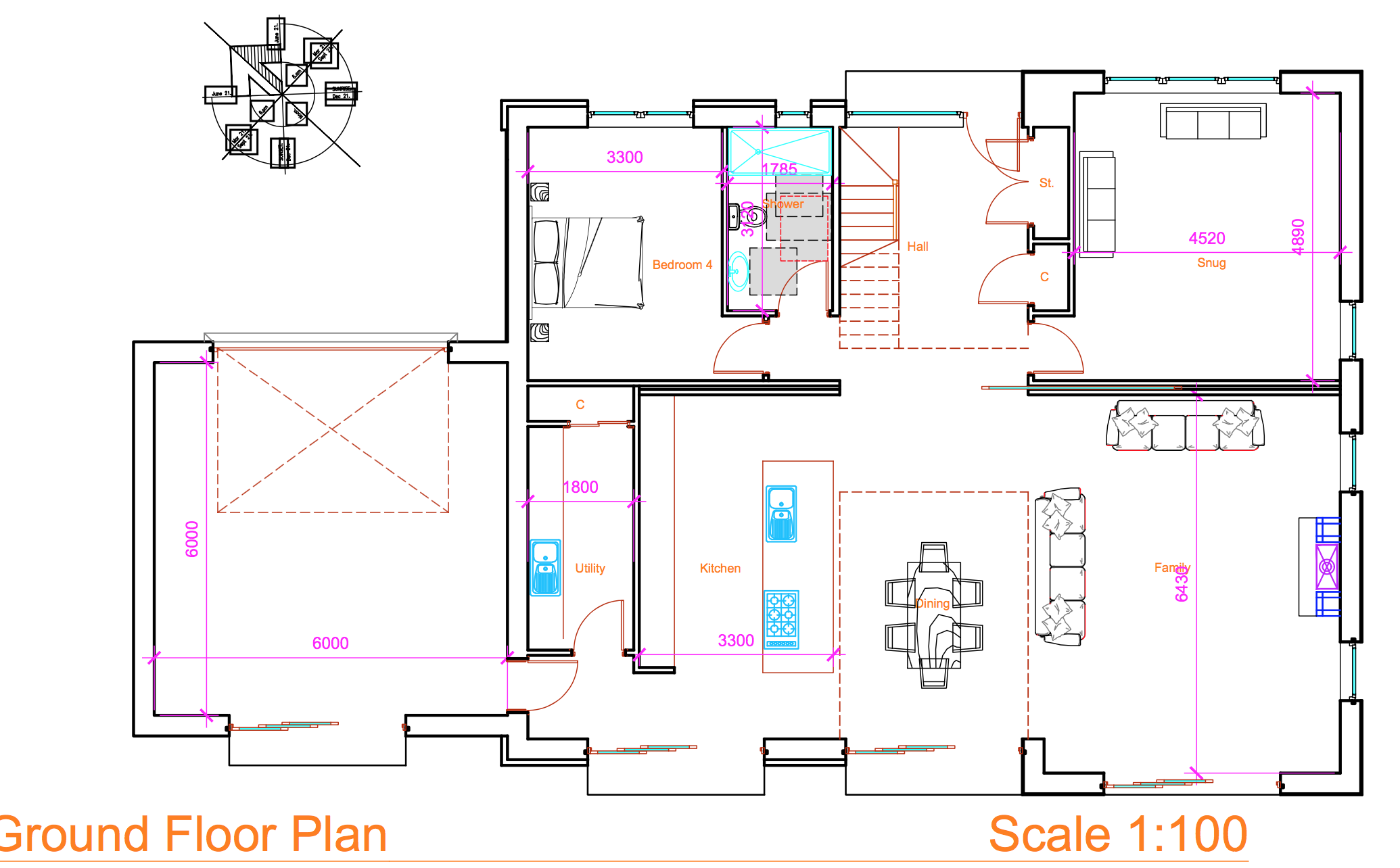

My new build will have UFH on the ground floor and radiators on the first floor.
I have been thinking about putting UFH in the attached garage (36 sqm) as I will be using the garage as a home gym. However i'm not sure if it's a good idea since I would only be using the gym for say 1 hour a day. Should I just go for radiators instead? The garage walls are timber frame and have same insulation levels as the rest of the house. The garage door will be an insulated sectional door.
I also thought putting in the UFH now along with the required floor insulation etc would mean the space could be easily converted into habitable space easily at a later date.
I would also need to check from a technical perspective that the UFH pipes would withstand the additional load of a car in the garage.

The only reason I thought radiators might be a better solution is from a cost perspective, the radiators could be turned on 30-60 mins before to bring the room up to a suitable temperature before I use it. Whereas would the UFH need to be on all the time which seams a bit extreme for a room that would be used 1 hour a day max?
