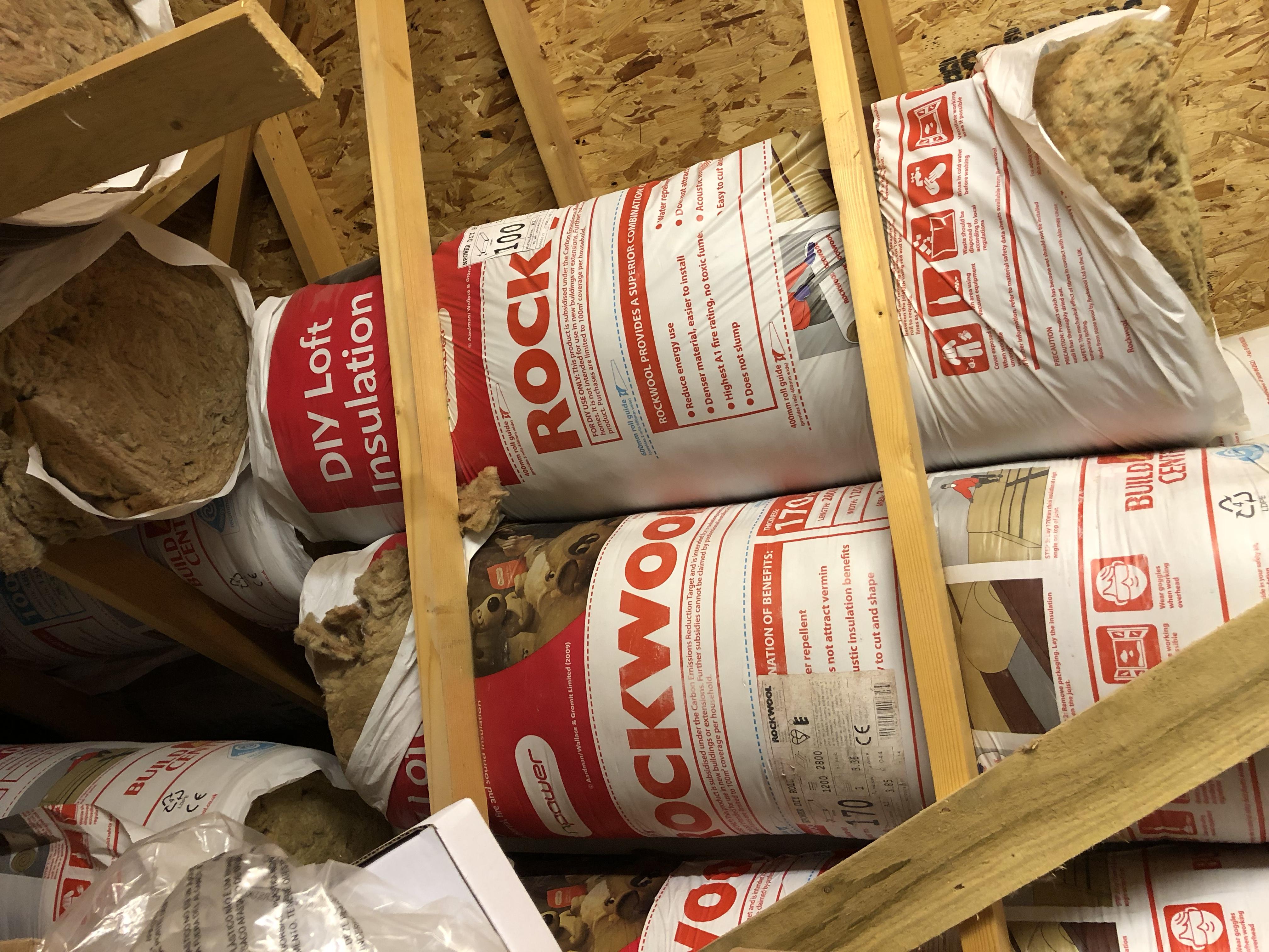

newhome Posted June 29, 2018 Share Posted June 29, 2018 There are quite a few rolls of rockwool insulation up in the loft that were unused. Wondered what I should do with them really. I guess the options are a. use them somewhere but where? b.leave them there as they are not in the way after all (I have never actually been in the loft!) or c. get them down and get rid of them. Views? Link to comment Share on other sites More sharing options...

PeterW Posted June 30, 2018 Share Posted June 30, 2018 14 hours ago, newhome said: There are quite a few rolls of rockwool insulation up in the loft that were unused. Wondered what I should do with them really. I guess the options are a. use them somewhere but where? b.leave them there as they are not in the way after all (I have never actually been in the loft!) or c. get them down and get rid of them. Views? No issue with adding more over the existing stuff - just keep it away from the edges. If its 100mm it’s probably 12m long rolls so just put it out over bedrooms etc that you use - assuming you can see the ceiling joists to stand on first ..! 1 Link to comment Share on other sites More sharing options...

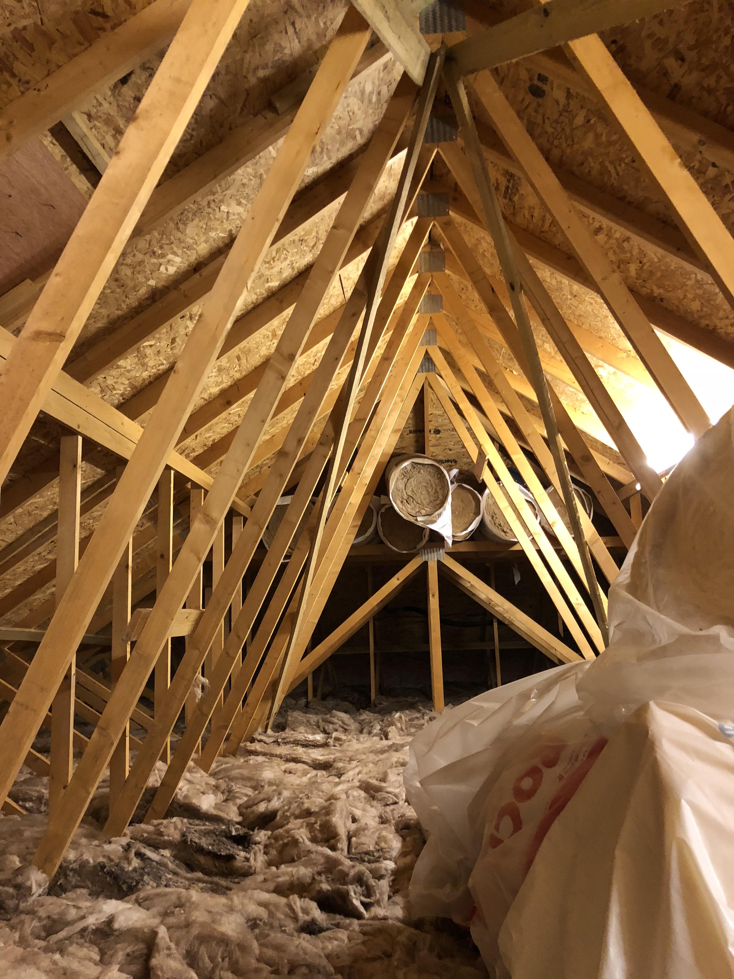

newhome Posted June 30, 2018 Author Share Posted June 30, 2018 4 hours ago, PeterW said: No issue with adding more over the existing stuff - just keep it away from the edges. If its 100mm it’s probably 12m long rolls so just put it out over bedrooms etc that you use - assuming you can see the ceiling joists to stand on first ..! Thought I had better brave a look in the loft. Upside there is a loft ladder and lights up there. Downside, ladders and heights in general terrify me. Made me feel dizzy just looking down from the top. Yes I know that’s pathetic lol. Anyway, there are about 30 spare rolls up there. Only a tiny bit of the loft has been boarded over and I can’t see the joists as the existing insulation seems to cover them up. I wouldn’t feel safe walking up there anyway in truth so the rolls are going to have to stay where they are Apart from the insulation at least there isn’t much else up there. A couple of suitcases, a stack of Pickfords boxes from the move and a few other random boxes so that’s a relief I guess. Link to comment Share on other sites More sharing options...
ProDave Posted June 30, 2018 Share Posted June 30, 2018 Someone over ordered. They won't do any harm left there. You could offer them on freecycle on the basis the collector gets them down from the loft (and if they put their foot through the ceiling pay for the repair) Link to comment Share on other sites More sharing options...
PeterW Posted June 30, 2018 Share Posted June 30, 2018 I wonder how much is laid ..?? Can you count the layers ..? I wouldn’t get rid if there is less than. 300mm as another layer would help a lot. Link to comment Share on other sites More sharing options...

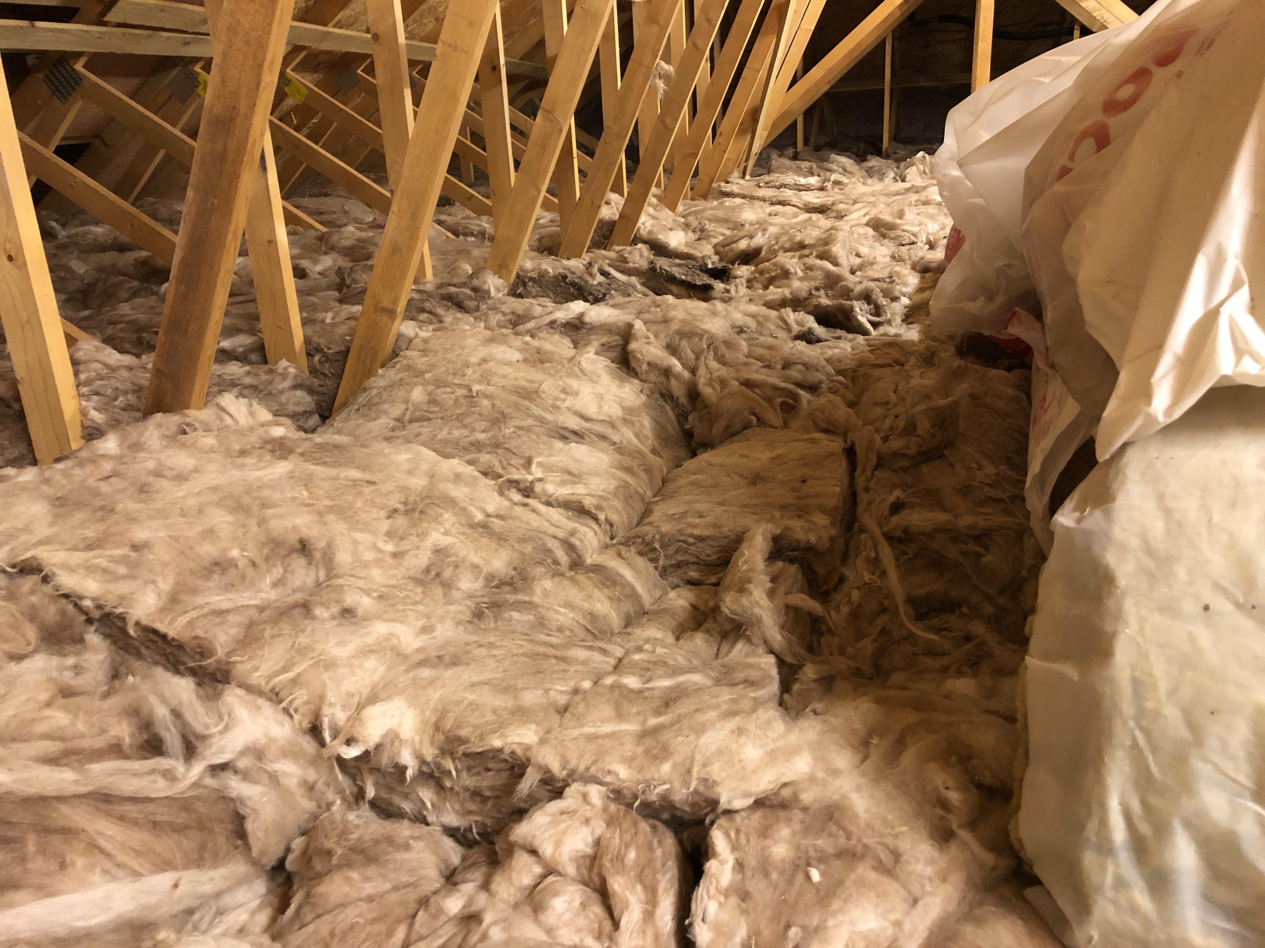

newhome Posted June 30, 2018 Author Share Posted June 30, 2018 (edited) 1 hour ago, PeterW said: I wonder how much is laid ..?? Can you count the layers ..? I wouldn’t get rid if there is less than. 300mm as another layer would help a lot. There seem to be 2 layers near the hatch. There are possibly 3 layers further over, see photo - I think that's 2 layers plus another one but it's hard to check when I can only stand in the tiny area that is boarded over. It's laid at 90 degrees to the layer underneath it seems, so difficult to tell easily and it seems to expand a lot. I'll leave it all alone and then one day that might be a job for someone to come and do. It's bloody horrible stuff! I wore gloves but it probably wasn't the brightest idea to kneel down up there in shorts. Am itching like mad now Edited June 30, 2018 by newhome Link to comment Share on other sites More sharing options...
Ferdinand Posted June 30, 2018 Share Posted June 30, 2018 (edited) 58 minutes ago, newhome said: There seem to be 2 layers near the hatch. There are possibly 3 layers further over, see photo - I think that's 2 layers plus another one but it's hard to check when I can only stand in the tiny area that is boarded over. It's laid at 90 degrees to the layer underneath it seems, so difficult to tell easily and it seems to expand a lot. I'll leave it all alone and then one day that might be a job for someone to come and do. It's bloody horrible stuff! I wore gloves but it probably wasn't the brightest idea to kneel down up there in shorts. Am itching like mad now Usially the bottom layer would be the depth of the joists, say 100mm in an old house, then the next would be At right angles, say 170mm in an old house. That gives 270mm which is approx the recommended optimum. Self Builders will do what we want. Shorts LOL. Well at least it wasn’t a bikini. Edited June 30, 2018 by Ferdinand 1 Link to comment Share on other sites More sharing options...
