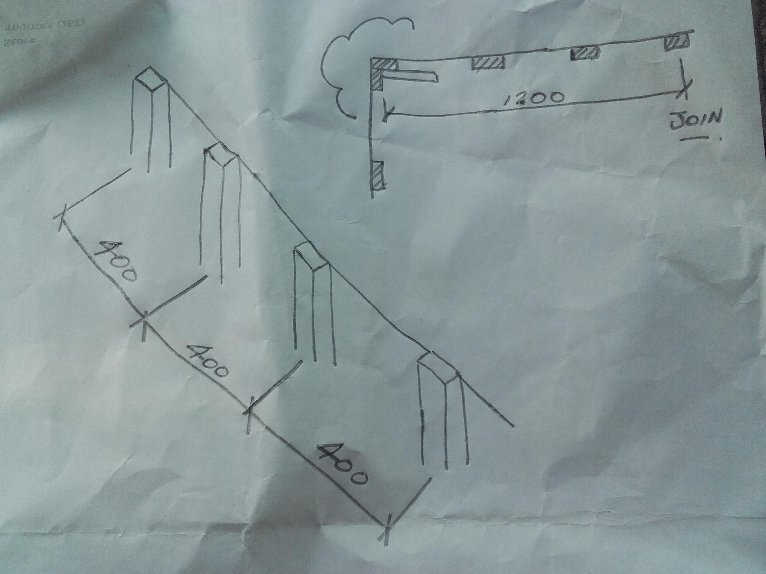

zoothorn Posted July 19, 2018 Author Posted July 19, 2018 Understtod onoff- Ive found an extention thing for the drill bits. What fixings for the 9mm PB > battens? Also taking off this coving.. is the idea to replace with something? [Im still not able to get notifcations of a reply in my hotmail inbox- is this possible?] thanks zoot
Onoff Posted July 19, 2018 Posted July 19, 2018 (edited) Fag packet sketch but THINK when you set your battens out with regards to corners! The ends of the boards need support for a start. Although 400 centres on the main run its less in the corner to make the join centre of a batten. 25mm pb screws would be fine. You can get special bits for the screws so you don't drive too deep into the board. You need to be a little more delicate cutting 9.5mm board out for sockets etc. I use a multitool. You can get away with a SHARP Stanley but try not to break out the back too much or it'll weaken the cut hole and you could get sockets pulling off if you use dry lining boxes. You can cut partly thru then cut from the other side to finish off. I neat pva any such holes cut in pb. You could likely use std 32mm metal back boxes screwed to the original wall tbh with 25mm battens and 9.5mm pb. Coving...won't the new boarding to up over that area? Edited July 19, 2018 by Onoff
