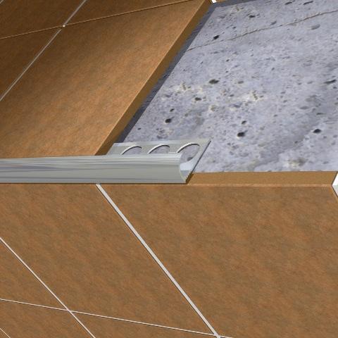

Onoff Posted October 16, 2018 Share Posted October 16, 2018 Whatever you're proposing is then now "unconventional" as in its not the norm! You should have used proper tile trim at the outset as you now realise. I was half wondering if you could still use convetional tile trim but hide the perforated side by filling and creating a bell mouth effect edging the window. Attach with small smears of "No Nails" type grab adhesive. That'd take some deft trowel work! You'd need to mask up the trim pre filling / painting the wall. In this pic then, ignore the tile above the trim and imagine that stuck to the pb. If you use timber then again attach with small blobs of "No Nails" type grab adhesive. Chrome angle? Would match the tap! Again fix with grab adhesive. Picked at random. https://www.northantstools.co.uk/product/geneisis-polished-chrome-aluminium-self-adhesive-edge-protector-2-5m-eaa100-91-10mm-x-10mm? Tbh with your woodwoorking skills I reckon stained timber. Maybe distress it a bit, wavy, bark like rear edge etc? Link to comment Share on other sites More sharing options...
PeterW Posted October 16, 2018 Share Posted October 16, 2018 UPVC unequal angle would look good too - 20x10 in 2mm uPVC would finish the tile edge too and not look obtrusive. Link to comment Share on other sites More sharing options...
zoothorn Posted October 17, 2018 Author Share Posted October 17, 2018 Alas I just can't see how any of these suggestions I could actually do. The tile pic above is n/a as the tiles are set.. there's nothing I could 'tuck' this "U" shaped piece of metal into surely so I don't understand this suggestion or the 'L' shaped metal corner (but where would this go- under tiles somehow??). Stained timber- but how would this be attatched? I have bought the screwfix 9.99 plastic corners, but again I just can't see how I can use it (or how to attatch it, nails just into the pB? surely not). The reason I didn't use the corners before the tiling job, as would now seen to be perfectly simple, is I had no idea of the process/ never used before, had no idea they attatched to the pB face prior to tiling so would stay put.. I thought they'd just fall down/ a nightmare to use without any experience of fitting them before. With any of these 'L' shaped corners I cannot understand why the suggestions of these type, such as PeterW's below are being made (to go -over- the tiles??)- I must be missing something glaringly obvious. again. On 16/10/2018 at 07:37, PeterW said: UPVC unequal angle would look good too - 20x10 in 2mm uPVC would finish the tile edge too and not look obtrusive. Link to comment Share on other sites More sharing options...
PeterW Posted October 17, 2018 Share Posted October 17, 2018 Yea - just bond over the tile edge. Link to comment Share on other sites More sharing options...
zoothorn Posted October 17, 2018 Author Share Posted October 17, 2018 Sorry Peter I'm not on board here. What does bond over tile edge mean? but bond what to the tile edge? I can't add any of the "L" shaped corner suggestions I don't think, as the tiles are set in place, if that's what you mean.. I'm only going to progress with.. a sketch (or a bodge job me guessing- I don't want to mess this up). Onoff can you come up trumps here-? Link to comment Share on other sites More sharing options...
PeterW Posted October 17, 2018 Share Posted October 17, 2018 Bond it over the front edge of the tile and onto the wall. It will cover the adhesive/grout behind the edge of the tile. Link to comment Share on other sites More sharing options...
Onoff Posted October 17, 2018 Share Posted October 17, 2018 What aren't you getting? Stick the feckin angle on with snot, jizzum or blue tac: If you use the stuff I suggested you will need to cut one side off with a Stanley - like you suggested. Stick the remaining side to the pb with the corner nib level with the tiles. Then back fill the edge. Link to comment Share on other sites More sharing options...
