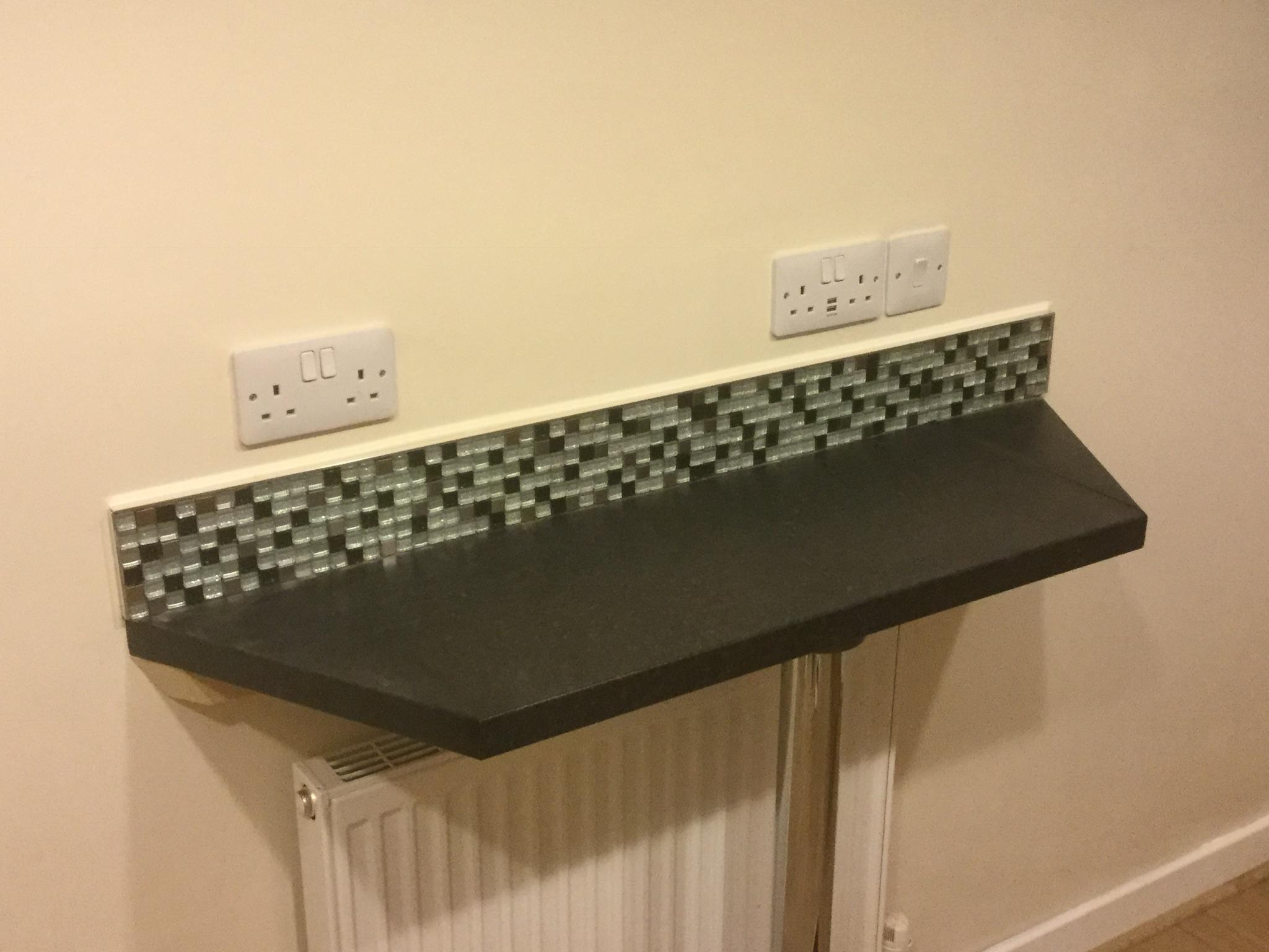

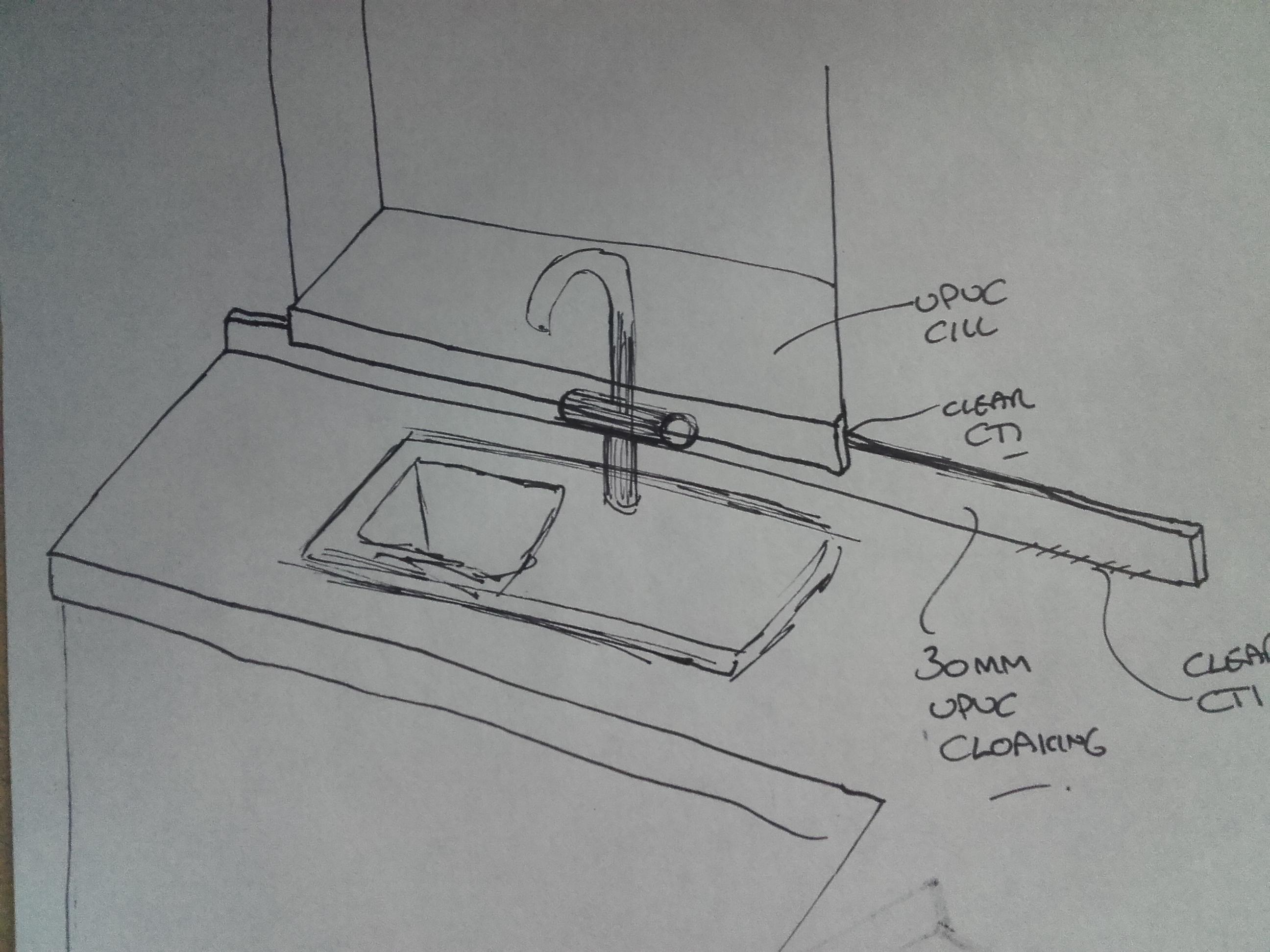

Onoff Posted September 13, 2018 Posted September 13, 2018 How about a white UPVC trim strip like this to match the sink: https://www.wickes.co.uk/Wickes-PVCu-White-Cloaking-Profile-45-x-2500mm/p/162621 Bed it on clear silicon and baby wipe the excess off. You can also get it in woodgrain effect.
zoothorn Posted September 13, 2018 Author Posted September 13, 2018 But what if Ive stuck down the sink, mastic's oozed out.. & moanin muggins here gone along edge bits like numpty stylee wiv a finger innit?
zoothorn Posted September 13, 2018 Author Posted September 13, 2018 I mean if Ive used the clear sealant stuff, to bond sink to top, what do I do with excess that squidges out? are you meant to totally clear all away.. or leave a shaped bead.. or clear away + then apply some other stuff (or is that not neccessary)-?
Onoff Posted September 13, 2018 Posted September 13, 2018 Most I think including me squidge the sink down on a thick bead of mastic, tighten the sink clamps on the underside then baby wipe the Hell out of it so it's all gone. You haven't done where the worktop butts up to the pb yet have you?

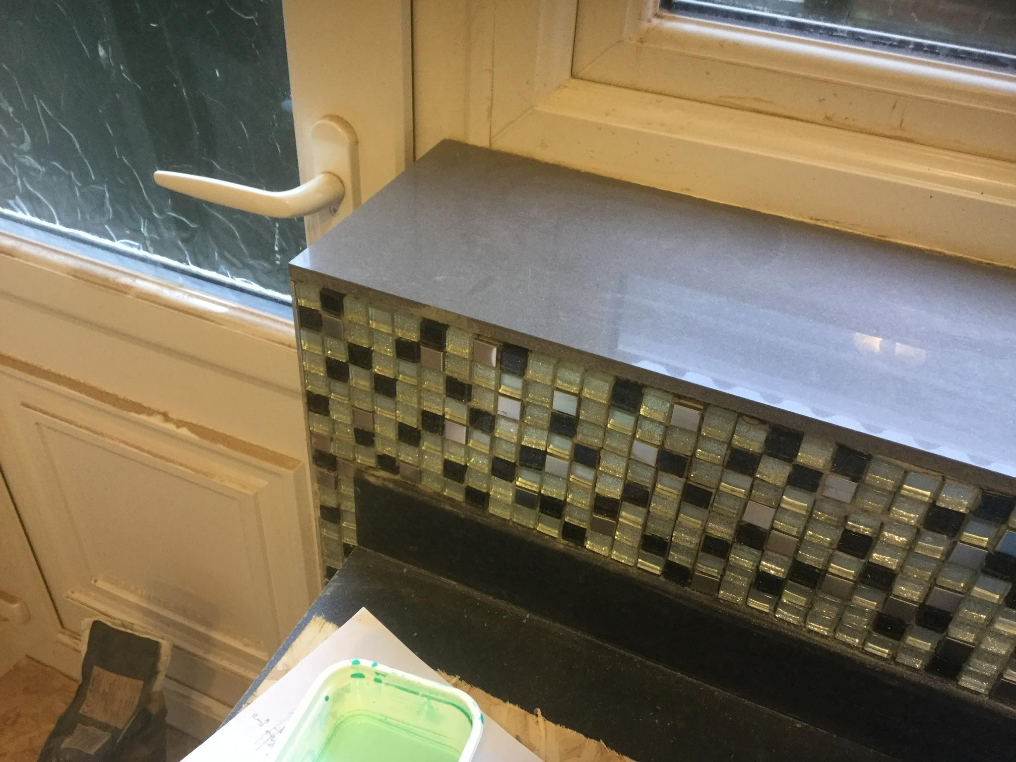

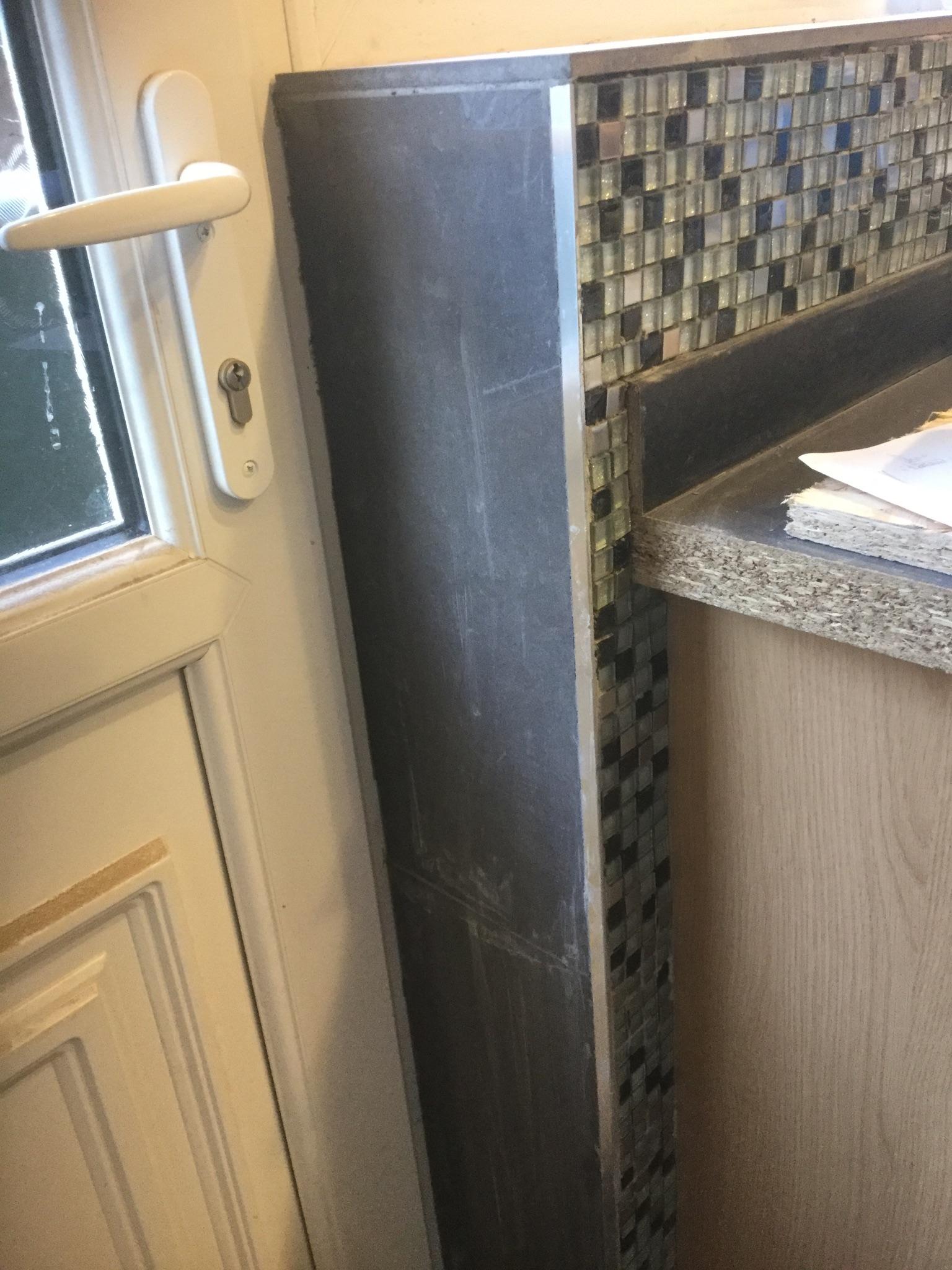

zoothorn Posted September 14, 2018 Author Posted September 14, 2018 Ok that's what I had half in mind when I did.. good, ok then I'll just carefully blade off -all- the excess so i can sand right up to the sink. The splashback.. is my hardwood strip feasable, or daft due to, well, its wood/ not exactly waterproof! i need to be considering the tiling then along with a splashback around the sill behind sink. Is tiling directly onto pB the idea? I often quiz plaster skim or tiles, onto pB due to the surface being paper: surely your just 'hanging' tiles from paper? IE it seems not exactly so well bonded to the plaster inside sometimes.. pulls off alarmingly easily I found with binned offcuts, & alot of weight with many tiles.
newhome Posted September 14, 2018 Posted September 14, 2018 What are your plans with the rest? Tiles and paint above? Do you intend doing anything to the doors? Need to have a plan that ties it all together now you are onto the decorative part.
zoothorn Posted September 14, 2018 Author Posted September 14, 2018 Doors can wait till very last/ cream paint + new knobs, one a time.. take my time. I need 2 cream strips below cabs to finish off woodwork too. The area around sink tho, even using tap carefully, causes splashes.. cos its a BIG DROP FKOFF TAP I need an action plan asap. Easiest to fix on is somesort of strip I guess, glue/ press, done. Tiling this piddly 3cm H bit.. a mighty faff in comparison surely (wood temporary strip looked quite good I thought, as basic idea too). Got a 5cm H "splashback" bit on other 1st window too, & sill.. prob best tile that too I'd think/ easiest. Overall plan: tiles on sill tops. Tiles up corner area ~50cm H. Other cooker side of kitchen tiles 50cm H behind top3, & around cnr 60cm W. Then I'll at least have a water resistant area/ I can relax a bit. Thanks, zootH

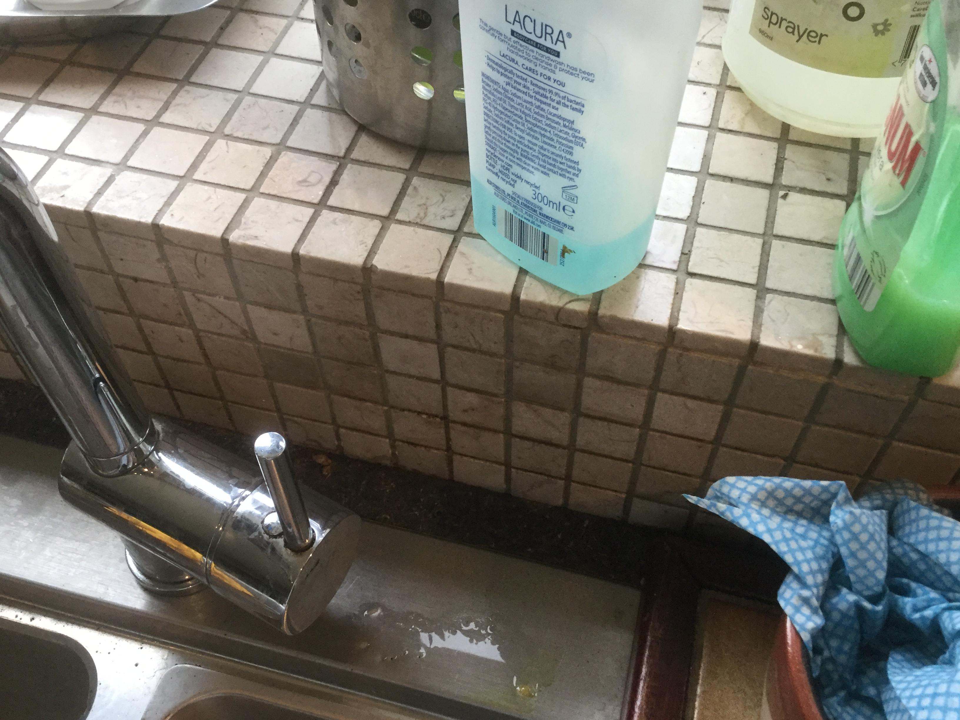

zoothorn Posted September 14, 2018 Author Posted September 14, 2018 Now I'll moan. The sink is cr*p. Alot of standing water on the draining board side which just stays there.. in a damp area this is exactly what you don't want as green mould will just set in. All under cups, the rack/ anything resting stays wet. Absolutely fkn Infuriating! Do not buy Franke sinks.
Onoff Posted September 14, 2018 Posted September 14, 2018 25 minutes ago, zoothorn said: Now I'll moan. The sink is cr*p. Alot of standing water on the draining board side which just stays there.. in a damp area this is exactly what you don't want as green mould will just set in. All under cups, the rack/ anything resting stays wet. Absolutely fkn Infuriating! Do not buy Franke sinks. Is the worktop level?

PeterW Posted September 14, 2018 Posted September 14, 2018 Yeh 400 is only w&d normally so that’s why I said it. Leave the sink as is and just wipe it dry when you’ve washed up.... I’ve seen expensive sinks do similar so don’t worry ..!!!
Ferdinand Posted September 14, 2018 Posted September 14, 2018 (edited) 1 hour ago, zoothorn said: Now I'll moan. The sink is cr*p. Alot of standing water on the draining board side which just stays there.. in a damp area this is exactly what you don't want as green mould will just set in. All under cups, the rack/ anything resting stays wet. Absolutely fkn Infuriating! Do not buy Franke sinks. What sort of Franke sink is it? They are an excellent brand. Mine came with a 50 year guarantee, and I think they will still be around. On the tap, try turning the water pressure down a little. Edited September 14, 2018 by Ferdinand
zoothorn Posted September 14, 2018 Author Posted September 14, 2018 "50 years" but I bet its only once its in the box or prior to fitting: if you've set it in, then they'll surely just argue "its the way its put in" (esp me not being a builder). And once I agree looked fine in box, then.. 'well did you check the draining section prior to fitting-?'. I just can't see how this 50 year guarantee applies, unless its obviously broken in the box. Am I being cynical or is that why its so big/ 50 yr..?
zoothorn Posted September 14, 2018 Author Posted September 14, 2018 Its a Franke tectonite cream sink, £100+. I will have to file these drop bits.. but that means removing the surface/ these areas may go dark soon but I have no choice. I'm onto Franke but I bet its "sorry, please return it FOC for a full refund"..

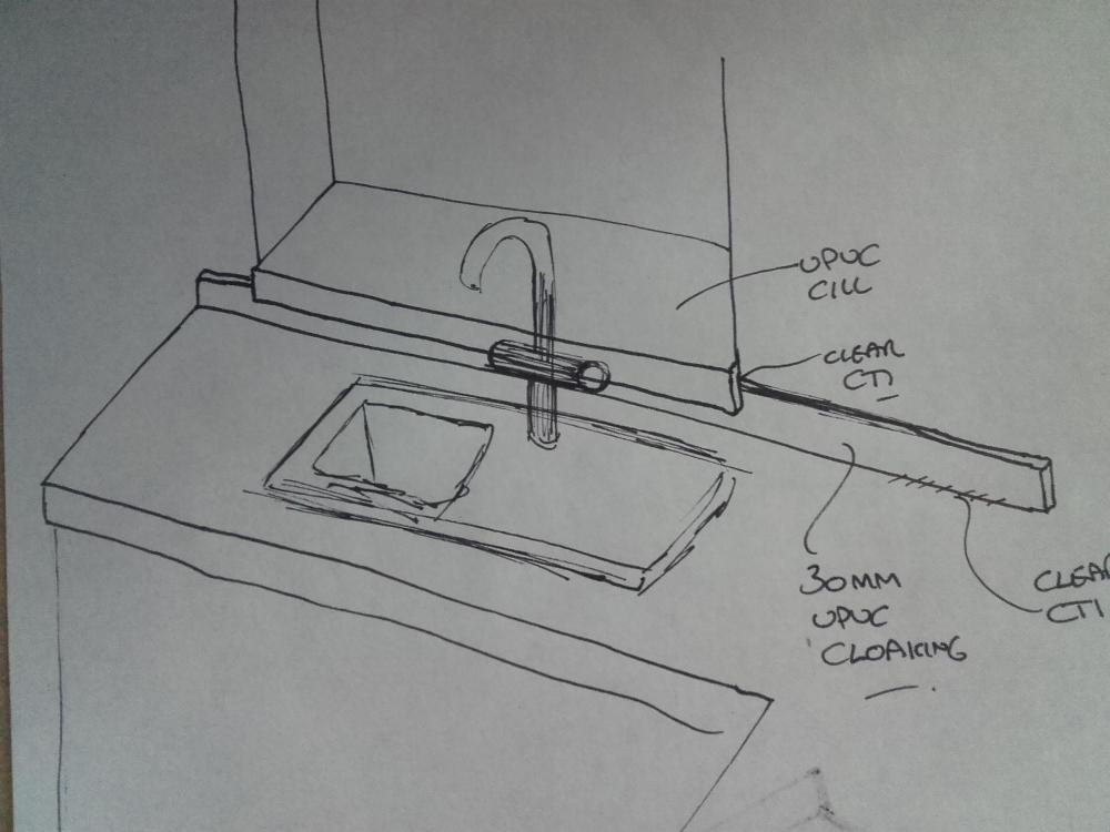

Onoff Posted September 16, 2018 Posted September 16, 2018 Just throwing ideas around: Put a 30mm upvc cloaking profile along behind the sink bedded down on a bead of clear CT1 between the cloaking edge and worktop. Stuck to the pb with same. You could tape and fill the walls either side and do in bathroom paint. https://www.wickes.co.uk/Wickes-PVCu-White-Cloaking-Profile-30-x-2500mm/p/162619 Then do the sill in a upvc capping board that would wrap over the 3cm upstand. For example, different widths available: https://www.trulypvc.com/window-door-parts/board-sill-trims/window-board-cill-capping-cover-1.25m? Waterproof, easy wipe etc. But is the upstand 3cm? Earlier you said 3-4cm...
Onoff Posted September 16, 2018 Posted September 16, 2018 Like this. Window sill is in fact that much wider than the sink. Done well should be no chance of water getting under the 3cm upstand or sill. And the white upvc will match the windows. 1
