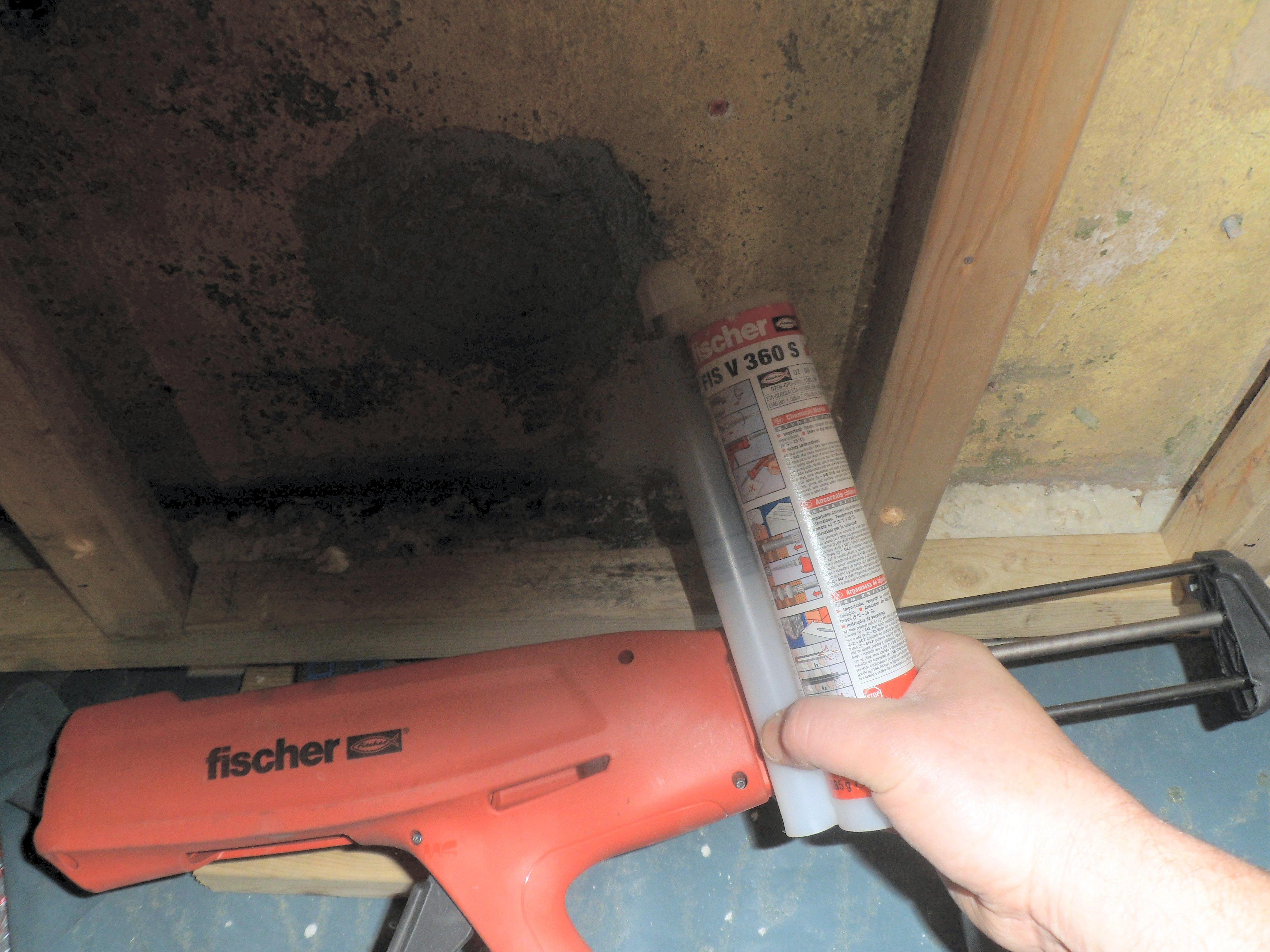

Onoff Posted August 24, 2018 Posted August 24, 2018 Gut feel is that the mice might be getting into the cavity somewhere then coming inside thru that bfo hole as it looks well sealed outside. Always unpleasant. That will need blocking up with a carefully bolstered lump of brick NOT FOAM! You could even break up a glass bottle when you mix your mortar up to fit the brick. Mind your fingers! (A lot of the old places down here have an over site of broken glass before a weak floor slab went down). Mice can get thru a hole the diameter of a pencil. Those pipes thru the close fitting holes in the cupboard back panel probably did you a favour! Is the floor there concrete? Are the rest of the floors concrete or suspended timber floors? Have a bloody good clean up / disinfect. Block the hole up then take stock.
zoothorn Posted August 24, 2018 Author Posted August 24, 2018 I've prepped the window/ just got sill mortar to do tmrw (I'll foamonster2 sill cavity this ev).. so maybe you can direct me on that block-up idea tmrw. I'm sure the mice are in the wall cavites yes.. in theory then once I block hole up they can't get in, so RIP in cavities.. I'd hope. One thing I touched on before/ a Q: if mice in cavities, then I guess they have access to & from the loft above kitchen, bc the top of cavities are 'open' not closed as a basic build rule.. is that correct? I'm thinking along the cold getting in here, the priority, rather than mice per se. I put the tight fitting stuff around the pipes in cupboard back recently, as mice got in here (also on worktops now & then.. urgh.. so would be good to tighten this situation up seriously first off). Floor is concrete, with zero insulation I can just feel it so (your feet/ lower legs feel the cold 1st). Tbh I think this is where the majority of the cold's coming from, but, I guess I can't do anything about it can I?

zoothorn Posted August 25, 2018 Author Posted August 25, 2018 Hi onoff.. yup similar next to consumer unit (crabtree iirc): 1x BIG gnd in from above, to a big junction here > joins power Co's BIG gnd lead coming in thru wall below. Leccy this end good; my unit repositioned by a pro recently (& new Pwr Co's lead in below only months ago too). I've disinfected area, eps in sill cavity.. & foamTHING2 has been innitiated. If I can I now ask you further on this mouse hole job. I have mortar mix & glass jar if needs be (I guess so if mice gnaw > no likey?).
Onoff Posted August 25, 2018 Posted August 25, 2018 (edited) I REALLY struggle with your abbreviated style sometimes... We (at least I) am going to forget all about the earth cables. Just leave them on the pipes. The hole: Dig out what looks like a bit of expanding foam on the left hand edge of the hole. Vac round the hole to clear the loose debris and dust. Channel your inner Michelangelo and shape with a bolster and hammer a piece of brick that fits that hole with no more than 10mm gaps all around it. Mix some mortar and in the mix chuck some finely smashed up glass. Work it into the hole around the pipe / the gaps around the shaped block. This is an old soil pipe hole I had to contend with: I core cut a bit of lightweight block: To hold in place: I tried foam but could still feel a draught. I used therefore an epoxy "mortar" that comes in a gun to completely seal the thing in there. (You can btw get epoxy resin like this in tubes that fit a standard mastic gun but you need a new nozzle each time). You do not have the core drill, besides the hole shape doesn't suit it. Nor to you have the resin gun kit or I doubt a mortar gun. You need to shape, by hand, with a bolster and chisel something to go in that irregular shaped hole. Try and taper it a bit so you can gently knock it in and it stays there while you get the mortar in all round. EDIT: Oh and its Mickey not Mikey Mouse! Edited August 25, 2018 by Onoff

Onoff Posted August 25, 2018 Posted August 25, 2018 A tip for mixing up mortar and filling small holes like this: Make up a milk container of 5:1 water/PVA. KEEP OUT OF REACH OF CHILDREN. Soak the gap you're filling and use instead of water to make up your mortar mix. Sticks like the proverbial to a blanket.
Onoff Posted August 25, 2018 Posted August 25, 2018 (edited) 12 minutes ago, newhome said: What about the waste pipe that goes through the wall? Doesn't that need to be somewhat loose so it can be pulled out if necessary? Or can it be stuck fast with the mortar? Also for later, there looks to be enough space to get the insulation and PB behind the grey waste pipe, but what about those copper pipes pressed right up against the wall? Do they get put behind the PB or do they have to be moved out? It'd come out with a good twist if need be. Wrap a bit of stiff plastic (dpm, etc) round the pipe and tape before filling round it - that'd give enough "slip" if worried. For later access to these pipes and that they look a bit green. I would replace them personally, in copper but with Hep2O fittings (for ease/speed) and bring down the face of the new pb and along. Can't see the op doing that though. I'd be worried about leaving soldered joints "in" the new wall. Edited August 25, 2018 by Onoff 1
zoothorn Posted August 25, 2018 Author Posted August 25, 2018 Ok thanks chaps, & for the suggestions onoff- I'm doing the shelf mortar tmrw, so will do mouse hole as you suggest with a brick & the mortar + 5:1 pva/ water.. & a slip around placcy pipe a good idea, thx Peter. When you say soak the gap tho, do you mean a mist spray (as per pre-soudal), or a big soak with a paintbrush? (& with the 5:1 or water?) Progress today..
Onoff Posted August 25, 2018 Posted August 25, 2018 Paint brush & slop it, 5:1 water (5 of water, 1 of PVA), in.
