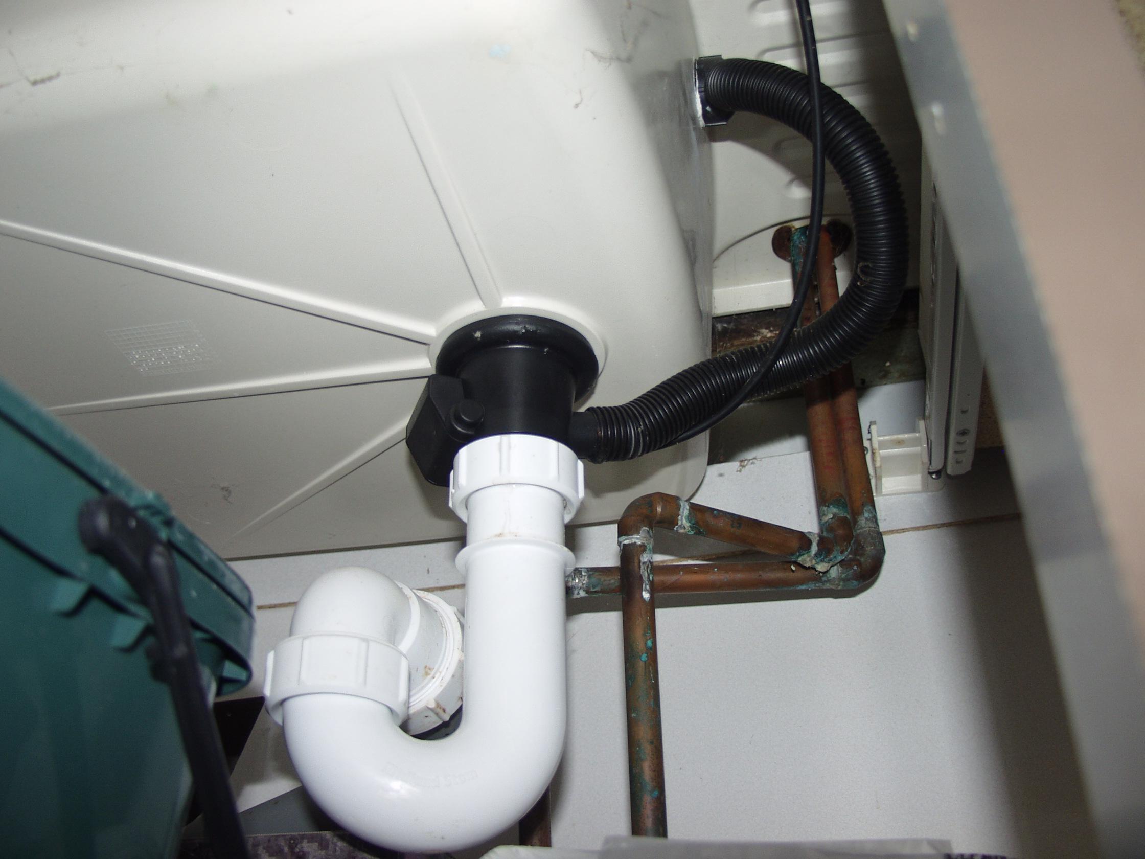

zoothorn Posted August 22, 2018 Author Posted August 22, 2018 I know what you mean newhome.. but that's fine if you know what you're doing/ have a plan for the next day, next etc & roughly can follow. But I'm in a different boat. I've never done any of this before. Each thing I thought relatively simple is instead a major headache.. the plumbing under the sink I cannot guage the size, therefore what needs replacing/ where to cut, & replace with what as all these recommended bits are new to me. Or the hob I thought a breeze to replace for a bit of progress/ relief from a week out of action staring at all this yet to do- is instead a total fkn n'mare: the new hob's 3" deeper than old. So only way to fit is to remove oven & sit it down way over an inch with gaps galore above & below, then how to.. seems only viable by taking the whole 3-unit thing apart & reconstructing. Ive given up & put old hob back in. Its becoming depressing & getting way on top of me, esp having to cut my ext cable now.
PeterW Posted August 22, 2018 Posted August 22, 2018 Right... Screwfix order ... pair of pushfit Hep2O 15mm isolators Pair of tectite 1/2” to 15mm adapters pair of Hep2O elbows couple of Hep2O connectors. 2m of copper 15mm pipe with that lot you can remove the old unit and isolate the supplies, shift the pipework to where it’s easy to work on and then reconnect it all. I haven’t got a photo but I’ve just moved a sink tap connection to the right of the bowl so it’s easier to work on - better than having to reach up behind sinks !

zoothorn Posted August 22, 2018 Author Posted August 22, 2018 1 hour ago, PeterW said: Right... Screwfix order ... pair of pushfit Hep2O 15mm isolators Pair of tectite 1/2” to 15mm adapters pair of Hep2O elbows couple of Hep2O connectors. 2m of copper 15mm pipe with that lot you can remove the old unit and isolate the supplies, shift the pipework to where it’s easy to work on and then reconnect it all. I haven’t got a photo but I’ve just moved a sink tap connection to the right of the bowl so it’s easier to work on - better than having to reach up behind sinks ! Understood. There is decent plumbing underneath ~spot on where the new tap will be tho. Its just a Q of guaging where to cut & doing it right the 1st time maybe, if going with what's there. I'm not sure how the PB goes onto this area tho so maybe your idea is best with this in mind. I'll weigh it up tmrw once I stick a pic up. I need a break- & I haven't done anything! Aprreciated.

PeterW Posted August 22, 2018 Posted August 22, 2018 25 minutes ago, zoothorn said: New tap will be almost smack in line with old one.. Not wishing to rain on your parade but that pipework is a little green... I would clean the pipes up level with that waste trap with some fine wet and dry and then when they are clean I would cut them off and put the isolators on. Then rebuild with clean pipe and a couple of elbows.

zoothorn Posted August 22, 2018 Author Posted August 22, 2018 11 minutes ago, PeterW said: Not wishing to rain on your parade but that pipework is a little green... I would clean the pipes up level with that waste trap with some fine wet and dry and then when they are clean I would cut them off and put the isolators on. Then rebuild with clean pipe and a couple of elbows. The waste trap being.. the bottom of the 'U'? not just after where they go sideways? can hs20 type isolators have an elbow in, or are we talking 2 units separated by copper pipe (or 3 units if 2 elbows + an isolator valve/ per side?). I was hoping it would be simpler tbh. I can't quite follow/ picture what the idea is.
