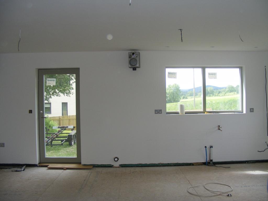

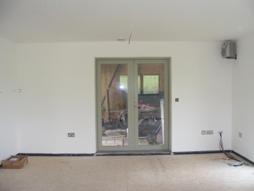

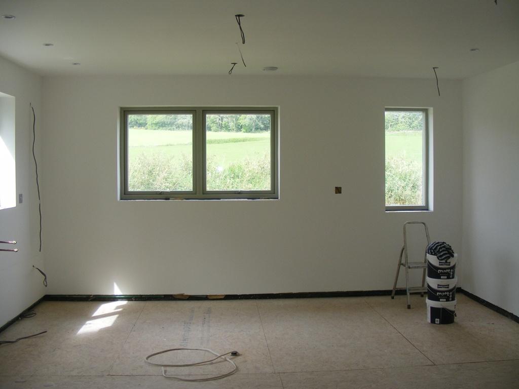

ProDave Posted June 12, 2018 Share Posted June 12, 2018 The main kitchen / living room downstairs is progressing well. Now plastered and painted. More on the blog at http://www.willowburn.net/ Look for the entry Main living room / kitchen Next step under floor heating and Oak flooring. Then a kitchen and we move in........ 8 Link to comment Share on other sites More sharing options...

ProDave Posted June 12, 2018 Author Share Posted June 12, 2018 25mm by 50mm battens following the joists. Then engineered oak flooring, with the UFH in the gap. The OSB that has been our temporary floor for well over a year remains with the sole job of supporting the UFH pipes. That will be the next job. Kitchen choosing starts soon. 1 Link to comment Share on other sites More sharing options...

MikeSharp01 Posted June 12, 2018 Share Posted June 12, 2018 (edited) looking great Dave, love the double door colour, what RAL is that? Edited June 12, 2018 by MikeSharp01 Link to comment Share on other sites More sharing options...

ProDave Posted June 12, 2018 Author Share Posted June 12, 2018 We are having engineered Oak as that's all you can have with UFH. At the last house we had solid Maple as the only solid wood anyone would guarantee for UFH and then only in 90mm wide planks. This time we wanted wider planks so engineered was the only choice. All the doors and windows are RAL7032 Pebble Grey Link to comment Share on other sites More sharing options...
