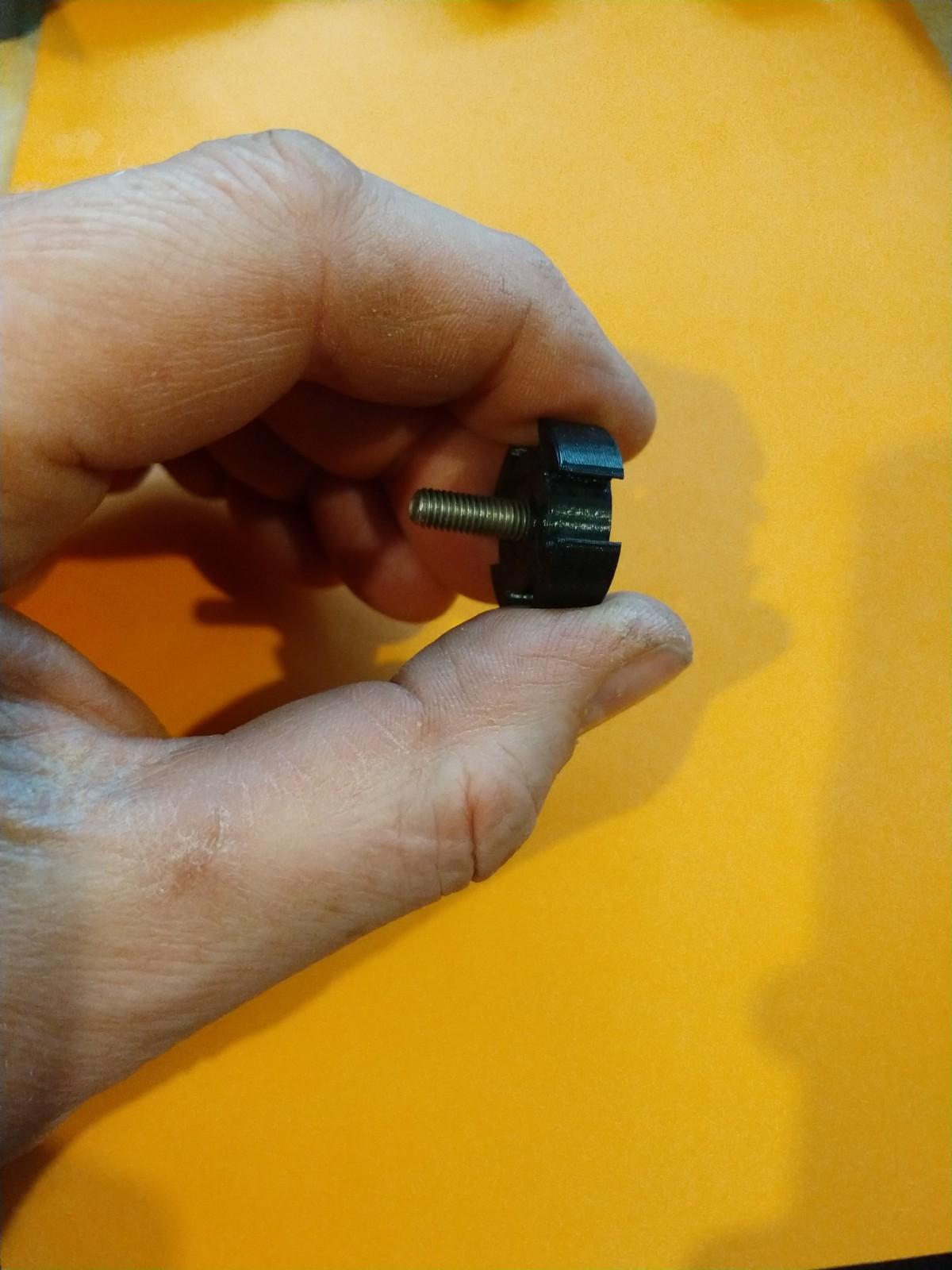

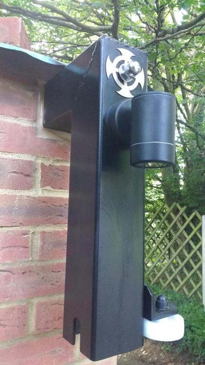

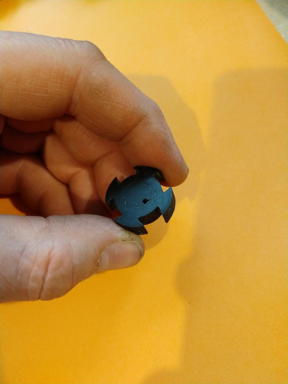

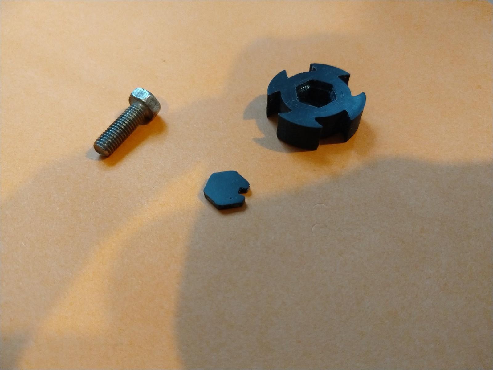

Onoff Posted April 28, 2022 Author Share Posted April 28, 2022 Some thumbscrews in black PETG with little removable covers. Ordered some M5x16 A2 bolts to go in them. I popped the cover on and rubbed down on 120 then 80 grit wet and dry. They're to hold some decorative cover panels on the gate pillars that cover the electrical boxes. Shape wise, a nod to the Celtic Cross stainless bits a guy on the MIG welding forum did me a while back: Link to comment Share on other sites More sharing options...

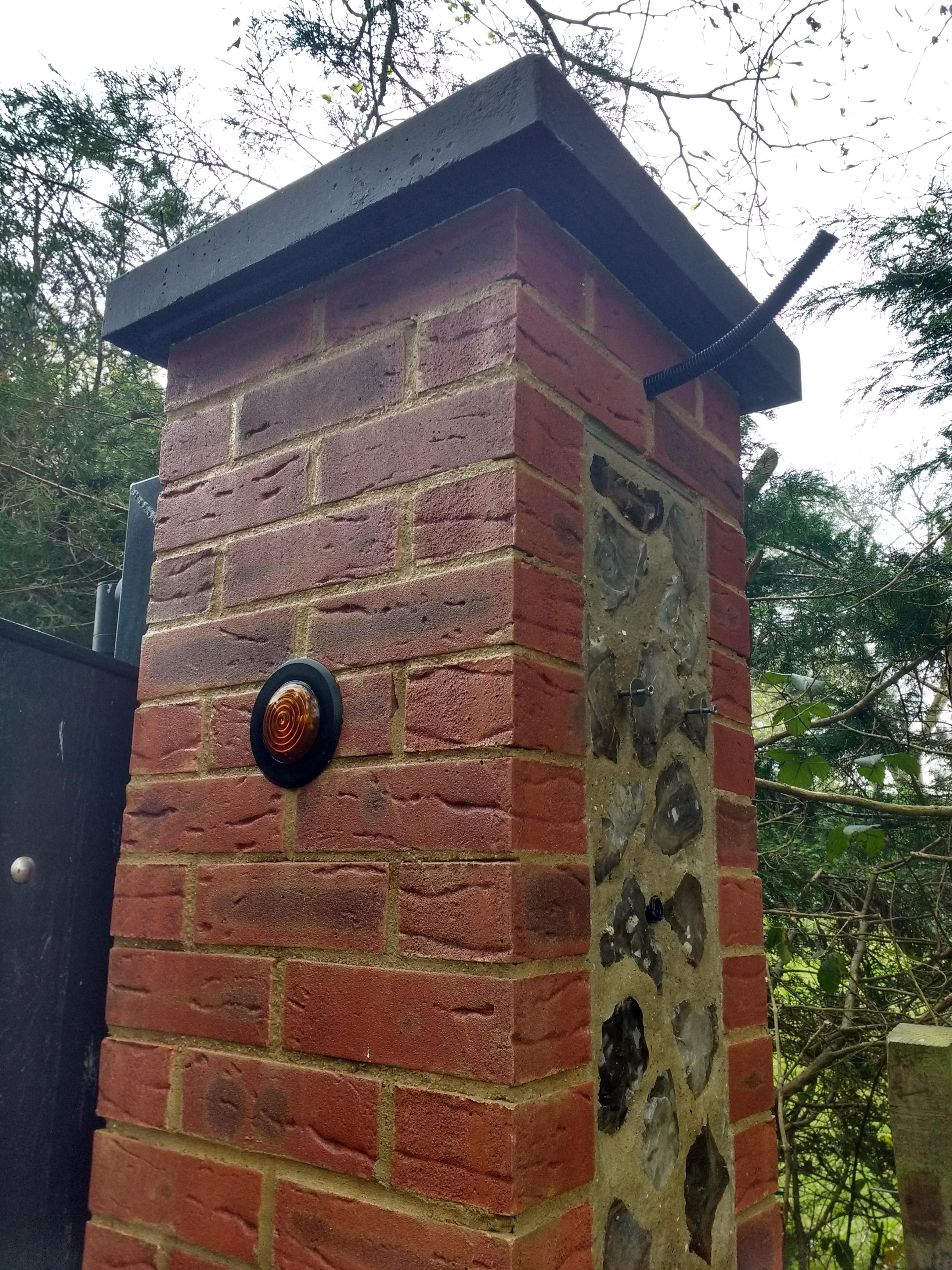

Onoff Posted May 3, 2022 Author Share Posted May 3, 2022 Tonight's mistake! Fitted the amber warning light that will flash as the gate opens. The black ring is 3D printed PLA, primed and sprayed black. The actual flashing beacon is nigh on the depth of a brick. I didn't like that, looked far too "council gritter". Probably shouldn't have stuck it in with CT1...bulb changing will be fun! Why did I do that? Didn't have any cheap clear silicone, could have got some tomorrow...by the same token could have re-printed in black PETG...sometimes I'm so impulsive! Still, it looks nice and pleased with the sheen on the bricks and flints from where I sprayed the concrete sealer on yesterday. Link to comment Share on other sites More sharing options...

Radian Posted May 3, 2022 Share Posted May 3, 2022 1 hour ago, Onoff said: The black ring is 3D printed PLA Outdoors PLA lasts about a year in my bitter experience. Yours may do better as you painted it. Link to comment Share on other sites More sharing options...
Onoff Posted May 3, 2022 Author Share Posted May 3, 2022 14 minutes ago, Radian said: Outdoors PLA lasts about a year in my bitter experience. Yours may do better as you painted it. Have you not seen those PLA benchies someone printed and anchored to a rock on the beach? A couple of years down the line and no degradation just a little bleaching. Link to comment Share on other sites More sharing options...

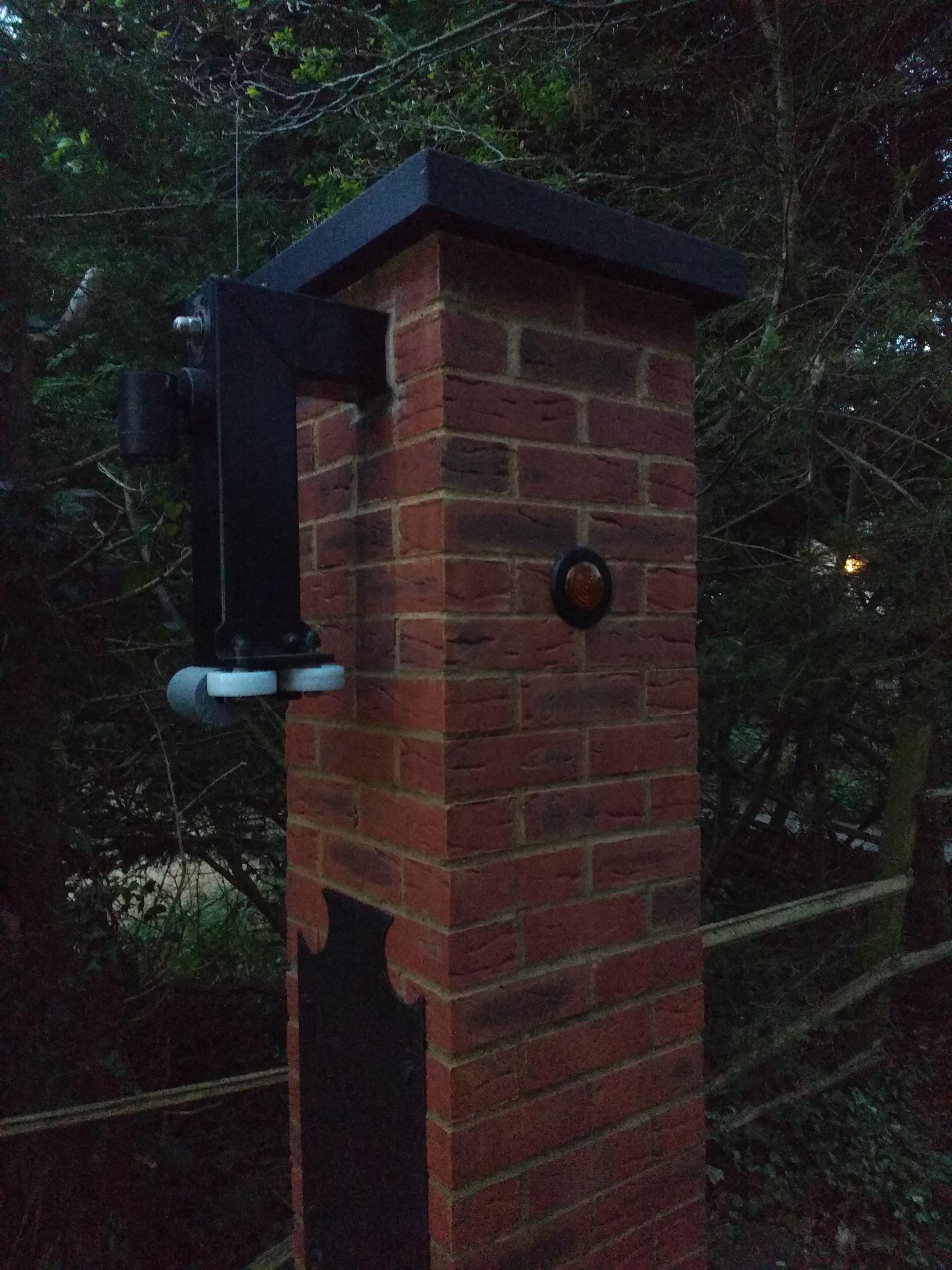

Onoff Posted May 4, 2022 Author Share Posted May 4, 2022 Looks smart enough in the light of the dawn! How long the PLA will last, who knows. Link to comment Share on other sites More sharing options...
Onoff Posted May 4, 2022 Author Share Posted May 4, 2022 Was debating printing a set of rollers in black PETG rather than the white nylon ones that are there now. One issue though is a potential to hit your head as you come up underneath it...maybe leave the white so it catches your eye (not literally). Link to comment Share on other sites More sharing options...

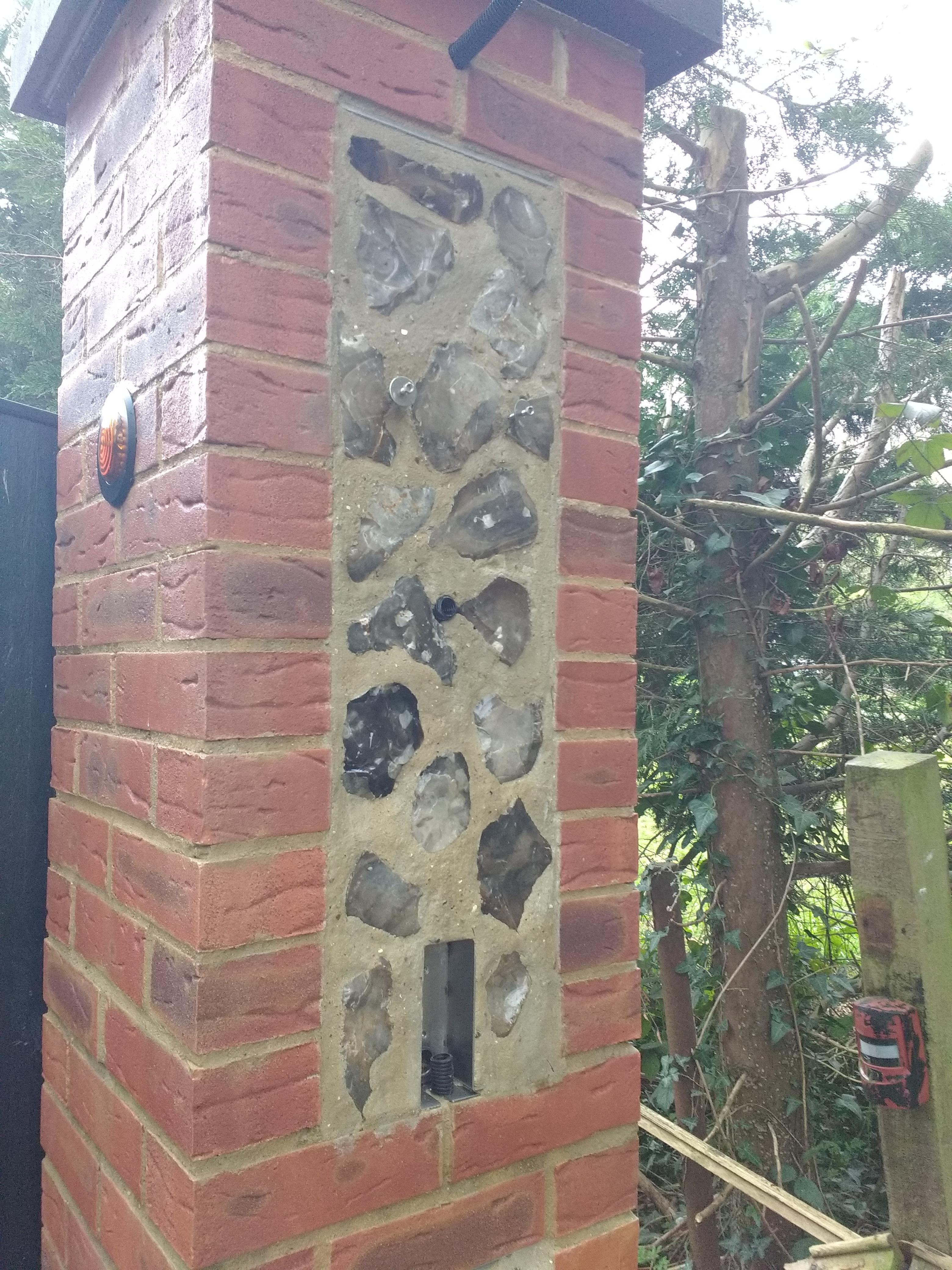

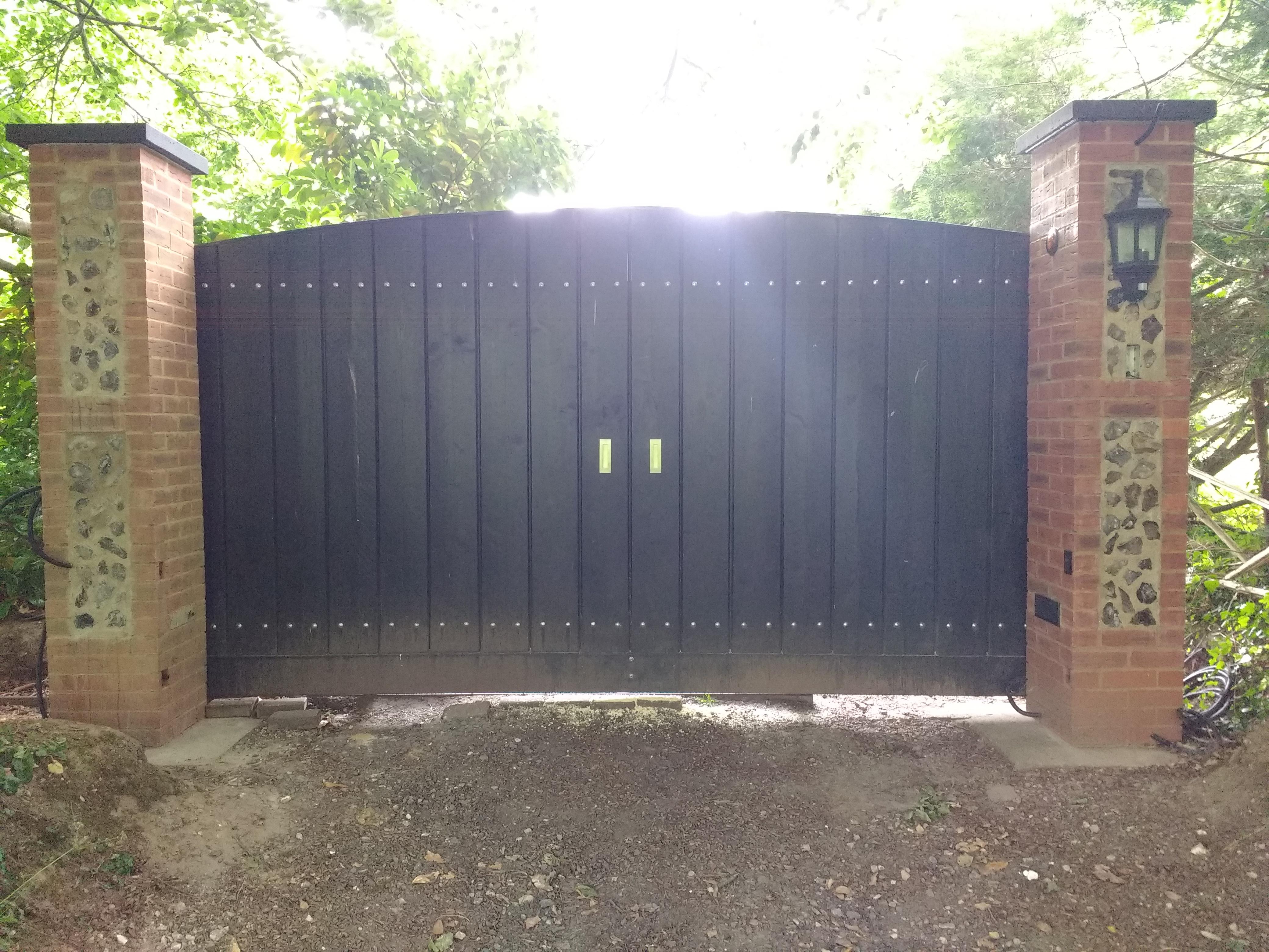

Onoff Posted July 3, 2022 Author Share Posted July 3, 2022 Flints nearly done in the second pillar. Needs a good clean when gone off a bit. Then concrete sealer sprayed on. Got to figure infill panels left and right. Probably a welded steel frame with more black stained scaffold boards like the gate. I might even think about powering it up... 1 Link to comment Share on other sites More sharing options...

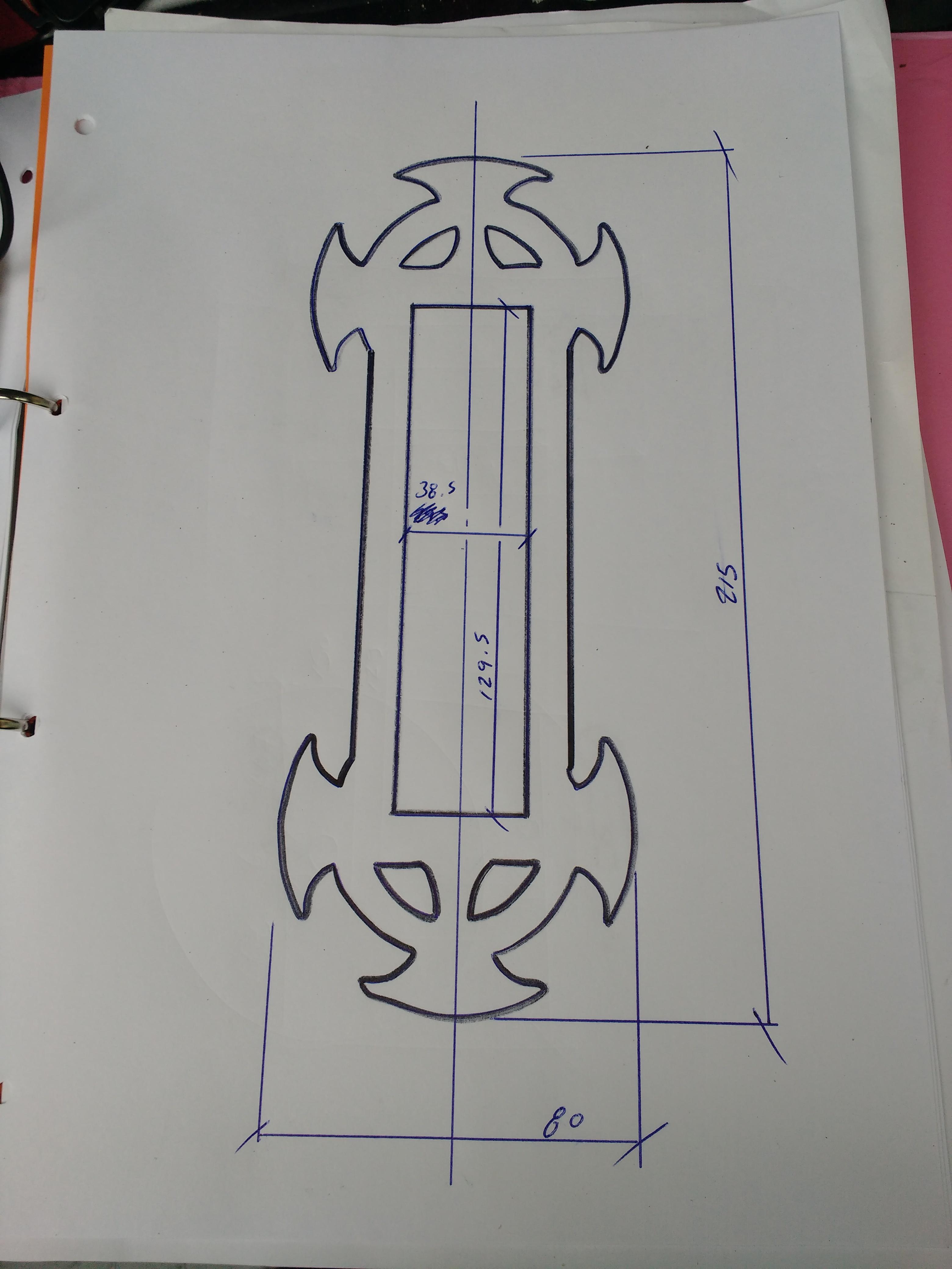

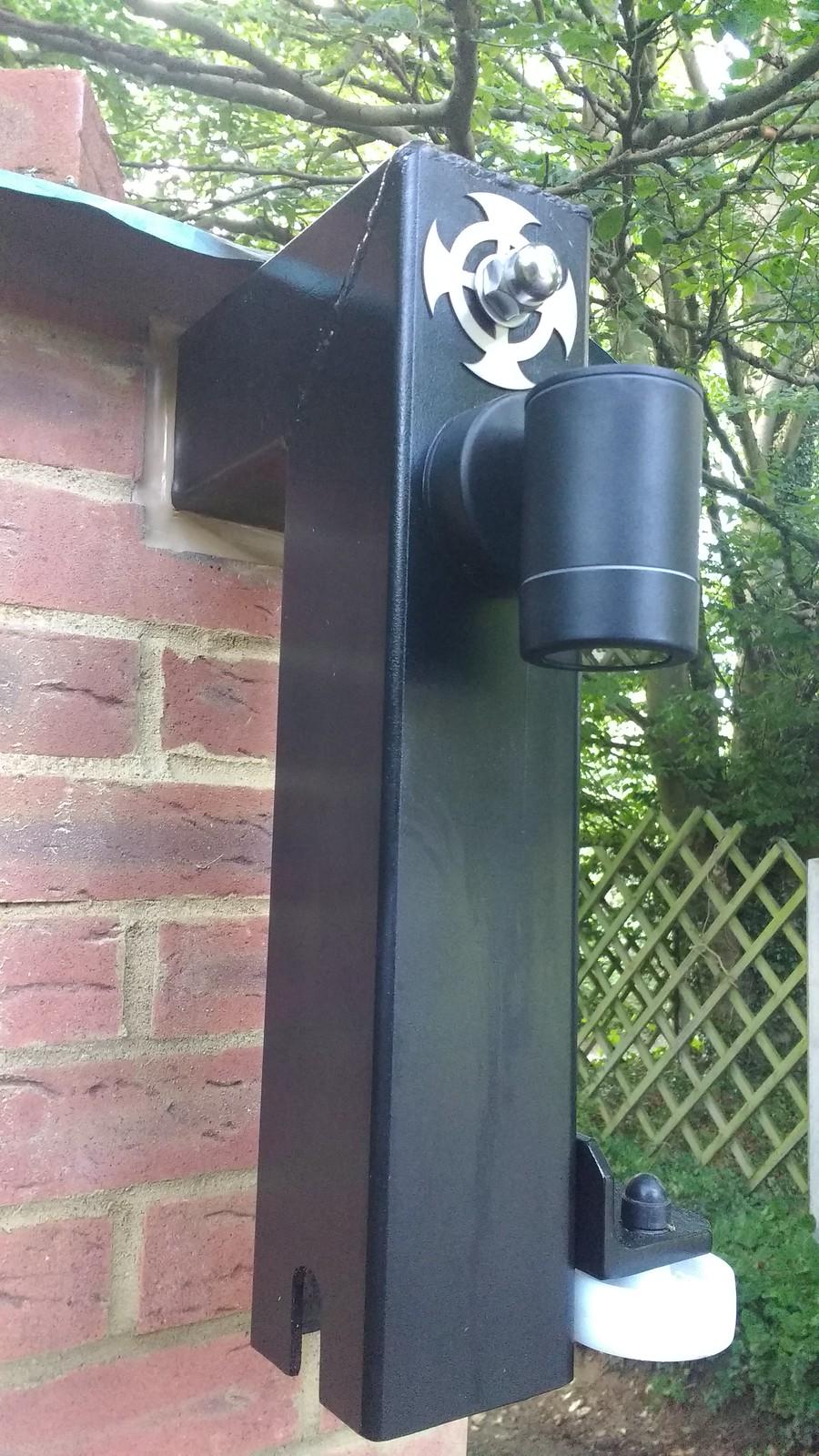

Onoff Posted July 7, 2022 Author Share Posted July 7, 2022 Made a jig, fired the router up and let in some totally unnecessary, Chinesium stainless, pull plates, just for effect. I've a price for a couple of laser cut stainless surrounds to bling them up a bit but they're a bit spendy for me at the mo so will have to wait. Rough draft, I'll draw as a DXF if I go for them. Link to comment Share on other sites More sharing options...
