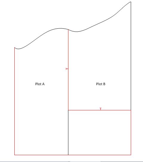

jack Posted July 7, 2016 Posted July 7, 2016 Yay, first topic in this subforum! We had an amazing stroke of luck a while ago. Our neighbour's house came on the market at the perfect time during our build. My wife's family bought it as a family project, largely to allow us to buy the rear part of the garden that's adjacent our house (which is set back from the road relative to next door). While they were extending and tarting up next door, we fenced off the relevant part of the garden. They've nearly finished and the renovated house will be put on the market in a few weeks. We now need to update the land registry for both properties. We've downloaded the relevant forms and they seem simple enough. Still, I have a few questions: 1. Is there anything in particular I need to consider when defining the boundaries? For example, if we wanted to own the fences, I assume we just show them as being clearly and wholly on our property. Is that just a matter of making sure the line on the plan is clearly in that position? Should we mention distances (eg, "50 mm from the face of the fence")? 2. When doing the drawings, I know that there isn't a great need for perfect accuracy as long as the boundaries are clear when read in the context of what's on the ground. I assume that means we can do the drawings ourselves. Should we show measurements on the plan (eg, showing boundary and cornerdistances from permanent structures such as houses and hard landscaping features)? 3. I'm not sure how enthusiastic my inlaws will be about the idea, but we're considering whether to ask them to include some covenants. The main one would be no biomass burners. Others might be things like not building structures within a certain distance of their rear boundary (would overshadow us), not attaching things to "our" fence without permission, that sort of thing. First, do you think covenants like that are likely to have much of an impact on people's decision to buy a property? Second, if not, what other covenants do you think might be useful to consider? In case it matters, this is South East England, and it's almost guaranteed that the house will be bought by a DFL (down from Londoner) moving here with young kids for the schools and their first back garden. The house has been renovated to a fairly high standard and the garden is still pretty big despite us snipping off its bottom. Many thanks in advance for any thoughts, advice or info. 1
PeterW Posted July 7, 2016 Posted July 7, 2016 Normal method for identifying who owns the boundary is by the use of a "T" on the fence. In the picture above, the boundary to the right of Plot A owns the fence, in the Plot B they own the bottom fence. Does that help...???

jack Posted July 7, 2016 Author Posted July 7, 2016 14 minutes ago, PeterW said: Normal method for identifying who owns the boundary is by the use of a "T" on the fence. In the picture above, the boundary to the right of Plot A owns the fence, in the Plot B they own the bottom fence. Does that help...??? Very much so, thanks!
