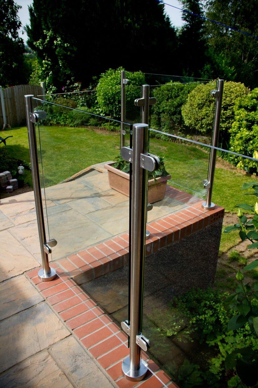

daiking Posted June 5, 2018 Posted June 5, 2018 Products? Suppliers? Experiences? We have friends who have gone with the bottom fixing frameless look. Mounts are ££££ extra thick glass is ££££. We will be happy with a simpler (cheaper) post arrangement. The perimeter of the patio is a double thickness brick/block wall and top surface will be a vit. Porcelain slab on a dry bed. The bricks are engineering bricks with holes in them so I’m not sure whether we should fill these before the slabs are laid. And then appropriate fixings will be needed for the chosen barrier format. Comments?

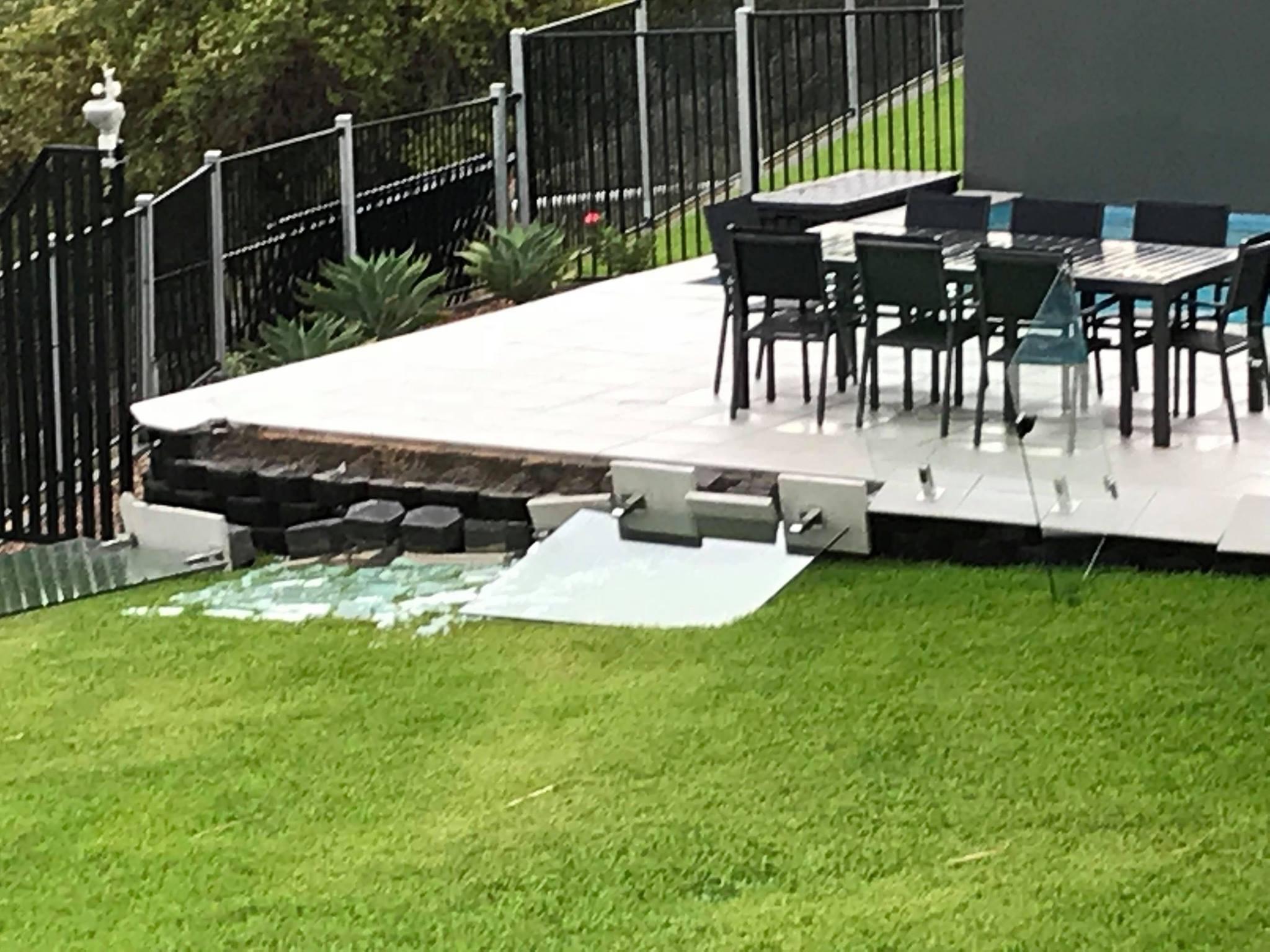

daiking Posted June 5, 2018 Author Posted June 5, 2018 1 minute ago, Russell griffiths said: Just don’t do this. Exactly. This is what I’m worried about happening Just now, Mr Punter said: What is the height of fall? 10 brick courses? ?
Russell griffiths Posted June 5, 2018 Posted June 5, 2018 I would think your slabs on top of the wall will need wet solid bedding, and all fixings pass through and into the brick work. I would be very thoroug on filling all those holes with a good strong mix to try and avoid any voids.

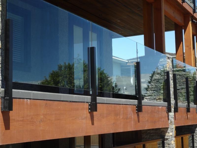

joe90 Posted June 5, 2018 Posted June 5, 2018 (edited) Could you not bolt the posts to the outside of the wall and extend your patio slabs out to just under the glass? just crossed post with mr punter, great minds think alike ? Edited June 5, 2018 by joe90
daiking Posted June 5, 2018 Author Posted June 5, 2018 3 hours ago, Russell griffiths said: I would think your slabs on top of the wall will need wet solid bedding, and all fixings pass through and into the brick work. I would be very thoroug on filling all those holes with a good strong mix to try and avoid any voids. I’ll speak to the guy when we get to that. Discuss what he would do if something we to be bolted though into the wall. 3 hours ago, Mr Punter said: Why not face fix the posts to the brickwork? 3 hours ago, joe90 said: Could you not bolt the posts to the outside of the wall and extend your patio slabs out to just under the glass? just crossed post with mr punter, great minds think alike ? Fugly...
daiking Posted June 5, 2018 Author Posted June 5, 2018 (edited) 21 minutes ago, Russell griffiths said: Any good. Ive seen these sort, seem quite reasonably priced, <£100 a baluster. Do you need to buy specific sized and drilled glass or can any glass co provide them. To be be honest I’ve got to measure up the 2 sides to determine how much I need and check the regs for glass thickness and distance between uprights. Been a while since I’ve checked the requirements. 12 minutes ago, Russell griffiths said: Or you could A possible but a bit fugly. Still going to be going into those Swiss cheese bricks. Edited June 5, 2018 by daiking
