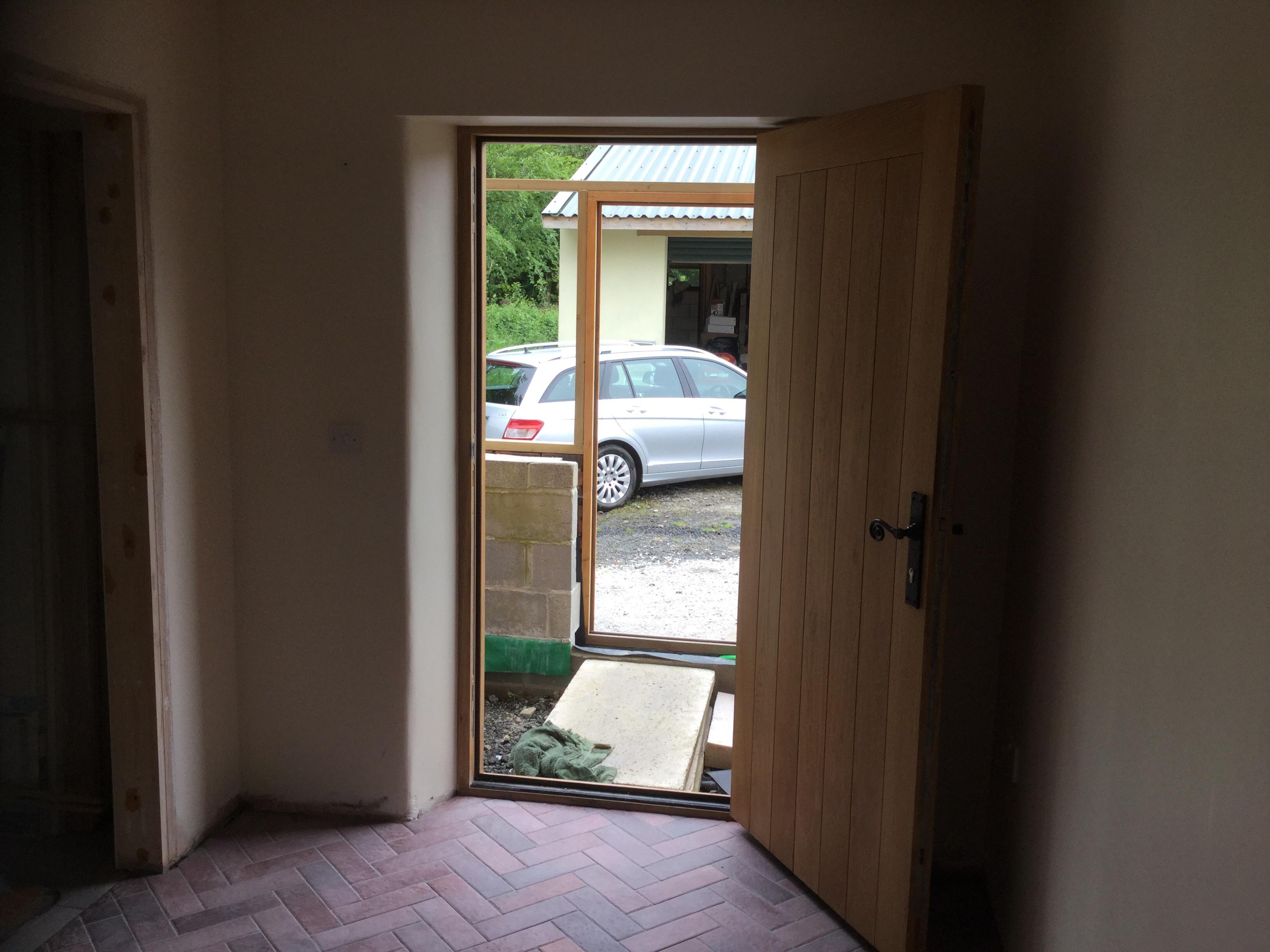

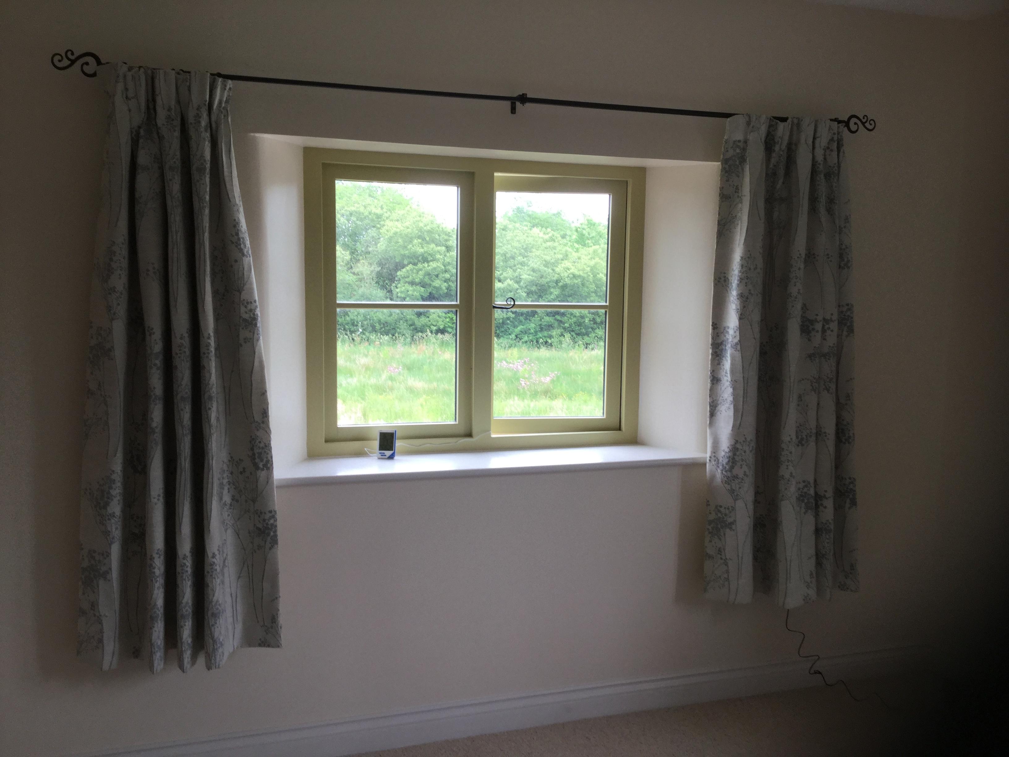

joe90 Posted June 5, 2018 Posted June 5, 2018 No I haven’t, I had 200mm full fill cavity with rock wall, brick outer and heavy concrete block inner with full wet render and plaster inside. The reveals were designed by me to be cottage style and they are great ( for us). I like option three to give you flexibility with your second fix etc but I do like solid walls to stop temp swings ( high thermal capacity) and also solid to hang everything on.
Declan52 Posted June 5, 2018 Posted June 5, 2018 (edited) The easy option is to put all the insulation in the cavity. Go for 150mm and get the beads blown in. Will be better for the brickies as they don't have to put the insulation in. Better for you as you will end up with no gaps in the cavity. Plus you don't need to fork out the cash to get the beads done until way later on in your build. You will on loose 100mm from wall to wall. To get round the bigger reveal you can do a splayed window opening. Easy done with a concrete saw and blocks. Wet plaster the inside. Seals it up much better. Edited June 5, 2018 by Declan52 1
joe90 Posted June 5, 2018 Posted June 5, 2018 My reveals were done in plasterboard, the inner skin was 150mm larger each side than the outer skin ( which helped loads when fitting the windows in check reveals , windows fixed to back of external brick). I also did this with doorways and gives a much better Access ( doors open past 90’)

joe90 Posted June 5, 2018 Posted June 5, 2018 Everyone said I would have smaller rooms but I designed the room sizes I wanted then put the walls around them!!! (Unless you are limited on footprint size ). Our builder had no problem inserting the rock wall insulation as they went ( and it was fairly cheap) . In fairness our brickie told me he did not like full fill cavity but the rock wall had a bba cert for full fill. Our west wall gets lots of driven rain, close to the Atlantic coast, and when core drilling fir ASHP pipes I found the outer 1” of the insulation in the cavity was a little wet ( wettest year on record in Devon) but it had not soaked in any further so I am happy.

joe90 Posted June 5, 2018 Posted June 5, 2018 If you do angled reveals I will draw what we did if you like, there is one detail my builder talked me out of that in hindsite I wish I had done which has caused a little cracking due to wooden windows expanding/ contracting.

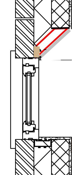

Matt64 Posted September 5, 2020 Posted September 5, 2020 @joe90Thanks for the pics on this thread, I'm new and this is my first post. I've been searching for angled/splayed window reveal details with little luck. My 60's semi and extension has standard cavity wall 300mm (brick,insulation,block) buildup, and wonder if this sort of reveal is possible with uPVC windows? As typical details use standard cavity closers, which I can't see working at an angle, so was thinking about just using some PIR board cut at an angle as a closer instead (a bit like this http://tonyshouse.readinguk.org/air-sealing-windows-and-doors/) I have butchered one of my architects drawings to show what I was thinking, a bit of timber against the brick face to support uPVC frame, then angled PIR board (red) for cavity closer with plasterboard on angle (maybe with a bit of ply underneath it?) I really like your angled door reveals as well, so I suppose same question applies for uPVC composite door detail. Any suggestions much appreciated!
PeterW Posted September 5, 2020 Posted September 5, 2020 You would need to be careful with that as it will create a significant cold bridge next to the window. BCO would also need some sort of vertical DPC between the inner and outer leaf. You’ll also need to change all your lintels as they will need to be significantly wider on the internal leaf - I would expect you would have to use split lintels or something substantially longer which may show on the front face.
Matt64 Posted September 5, 2020 Posted September 5, 2020 Thanks Peter - this detail would be on some narrow slot windows (460mm wide) and lintels are easily wide enough to cover lost blockwork. Cold bridge and DPC are very good points, that's what I'm not quite clear on. Also I'm not clear how the typical uPVC frame is fixed, would I even need the timber bit? Is it the frame only attached to the brick? If so i could remove the thermal bridge and add a DPC.
joe90 Posted September 5, 2020 Posted September 5, 2020 @Matt64 similar to my set up but my windows were on the back of the external brickwork, will do a little sketch in the morning. 1
