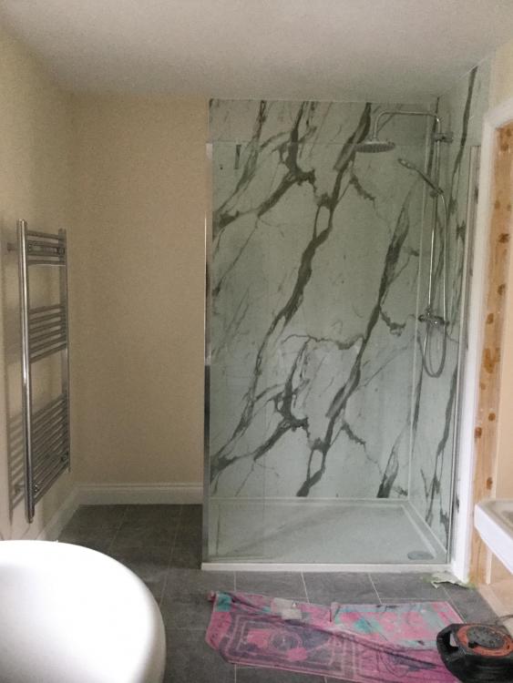

joe90 Posted June 2, 2018 Posted June 2, 2018 (edited) I have two shower trays 1000 x 800 and have screens with flipper panels. I wanted 800 doors on the end but could find none. We get a little water on the floor but generally they work very well. I don’t like sliders for all the nooks and crannies that get mucky, we like minimalist , glass with no frame. Edited June 2, 2018 by joe90

Jude1234 Posted June 2, 2018 Author Posted June 2, 2018 13 minutes ago, joe90 said: I have two shower trays 1000 x 800 and have screens with flipper panels. I wanted 800 doors on the end but could find none. We get a little water on the floor but generally they work very well. I don’t like sliders for all the nooks and crannies that get mucky, we like minimalist , glass with no frame. Looks good, where did you get the shower screens from?

joe90 Posted June 3, 2018 Posted June 3, 2018 17 hours ago, Jude1234 said: Looks good, where did you get the shower screens from? Shower wall. They were expensive but I have grown to hate grout around tiles!!!, I even used an off cut to make a splash back for the sink so it matched the shower. http://www.showerwall.co.uk/
