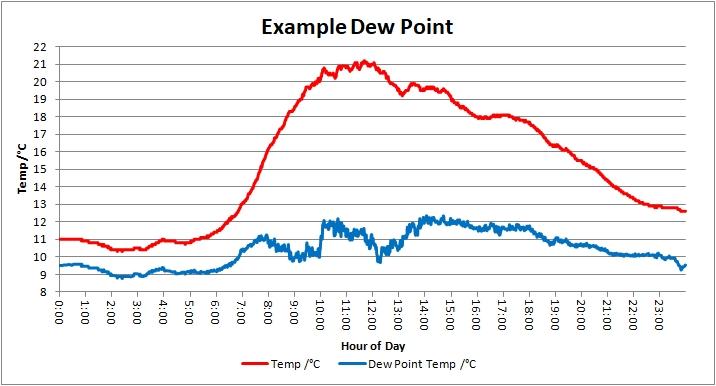

SteamyTea Posted May 24, 2018 Author Posted May 24, 2018 (edited) So here is a time series chart from yesterday, as long as the ASHP turns off (or reduces power output) before the air after the radiator is above 12.35°C (the highest dew point temperature), then there should be no serious frosting (though the radiator fins may be colder). By finding the sweet spot between the ambient air temperature and the 'exhaust' temperature, it should be possible to run at a higher CoP over a given time period. Obviously there is a minimum desired temperature for any hot water and the ASHP may not be able to deliver that, but that just leaves less of a top up. What it really boils down to is reducing the defrost cycles, but without cycling the ASHP too often during for frosting avoidance. Edited May 24, 2018 by SteamyTea
pdf27 Posted May 24, 2018 Posted May 24, 2018 Actually, I think the big lesson from that is the potential value of weather forecasts to improving COP. Most of the hot water will be used in the morning in an average household, and not further required until the evening. Putting an inhibit on the unit until 10am and then working at max power would be a very effective strategy on that day - whereas if it was cold all day then the best strategy would be to run at lowish power rates intermittently throughout the day and leave the unit to defrost naturally in between. The whole Internet Of Things will actually make this quite easy to implement. 1
