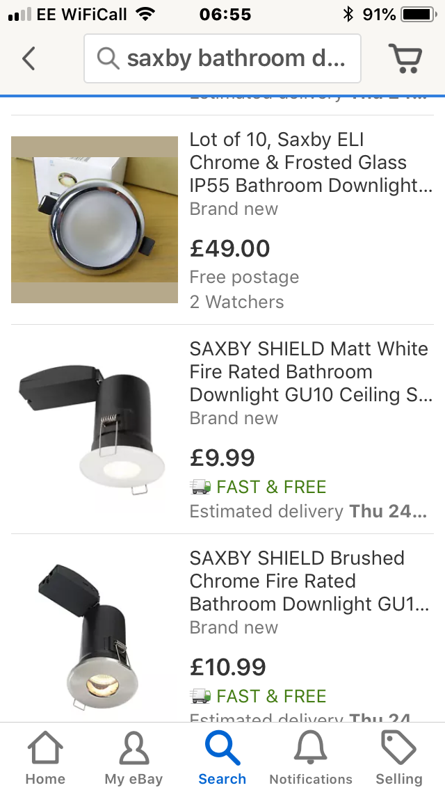

nod Posted May 20, 2018 Posted May 20, 2018 I have fifteen bathroom downlights I intend insulating the loft with 450 insulation My electrician friend has sugested that it isn’t a good idea to cover the downlights and to cut round them even though they are LED Leaving fifteen cold spots I think I can rember Dave perhaps suggesting covering with a plant pot Or is it safe to cover with insulation

nod Posted May 21, 2018 Author Posted May 21, 2018 I just wondered what you guys are doing The bathroom rated lights I have are quite bulky

Nickfromwales Posted May 21, 2018 Posted May 21, 2018 34 minutes ago, nod said: I just wondered what you guys are doing The bathroom rated lights I have are quite bulky I use These now as I hate the horrible, deep IP rated bathroom spots. The bulb is very high in them too so you get very little dispersion and a nasty shaft of light just pointing straight down. That means you need lots of them to adequately light even a small room . Those flat panel lights are fantastic. I used the 9w ones last and the light is just so much better compared to a downlight. Put them in the ridge of the boys attic room too, 5 of, and it completely fills the room with bright, crisp light. I wasn't so happy with the 6w, a very bluey light but maybe just that seller, so always buy a sample first and see if you like the type of light / colour before ordering all you need.
dpmiller Posted May 21, 2018 Posted May 21, 2018 ^ agree with Nick. Ordered some 6W variants to appraise and they're stunningly good. Even, glare-free light. Dunno about anyone else but as they're alloy body and steel backplate I'm happy to accept them as fire-rated too.
