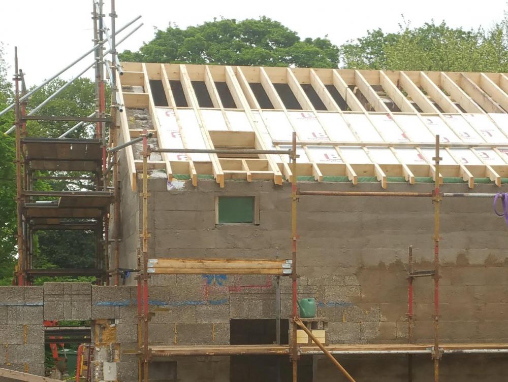

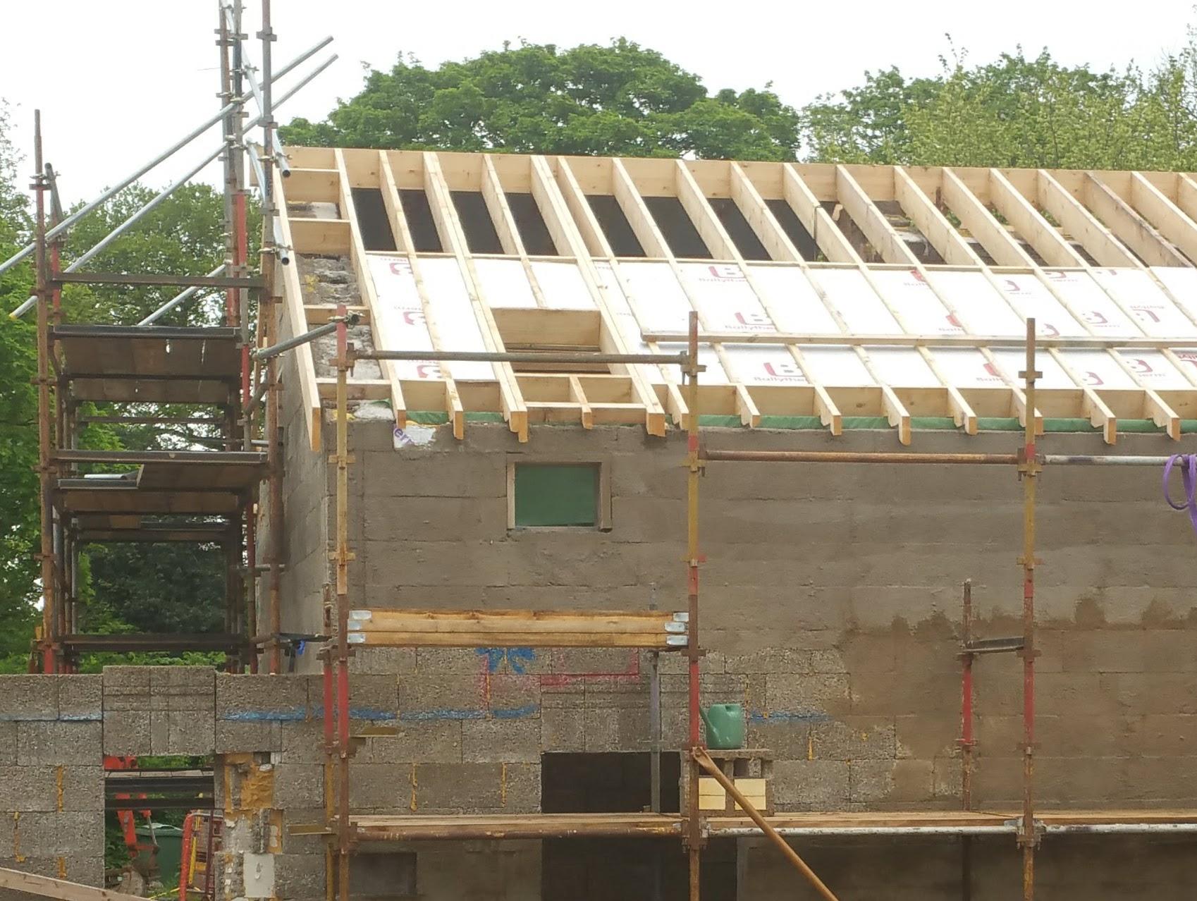

ToughButterCup Posted May 16, 2018 Share Posted May 16, 2018 Either side of the Velux in our roof, is a doubled rafter. Have a look: There's a slight gap between them, one or two mm: not much, but enough to make me think that something needs to be done. One rafter has a slight twist in it.... Foam? Bolt? Screw? Ignore? Foam and bolt? Get a life? Link to comment Share on other sites More sharing options...
PeterW Posted May 16, 2018 Share Posted May 16, 2018 Does the spec not say what should be done ..?? Either side of mine the doubles are screwed together and under the dormer cheeks it’s M12 bolts with washers etc Link to comment Share on other sites More sharing options...
joe90 Posted May 16, 2018 Share Posted May 16, 2018 (edited) That’s my boy, attention to detail all the way. I would have thought bolting them together would get rid of the twist, make them stronger, avoid a gap and stop future movement. I am surprised bolting was not specified, ah crossed posted with Peter. Edited May 16, 2018 by joe90 Cross posted Link to comment Share on other sites More sharing options...
ToughButterCup Posted May 16, 2018 Author Share Posted May 16, 2018 1 hour ago, joe90 said: [...] I am surprised bolting was not specified, [...] I'm not @joe90 Right, thanks, I'll get on with it. Now where's that @epsilonGreedy chap? He's full of beans at the moment. If you see him tell him to get his arse down here and do some work. Link to comment Share on other sites More sharing options...
PeterW Posted May 16, 2018 Share Posted May 16, 2018 Bolts on smaller Velux windows and doublers are not needed unless you really go past 800mm width as it’s normally to support the trimmers top and bottom and the shortened or removed rafters. A coach screw every 600mm will suffice - nothing too difficult to retrofit. Link to comment Share on other sites More sharing options...

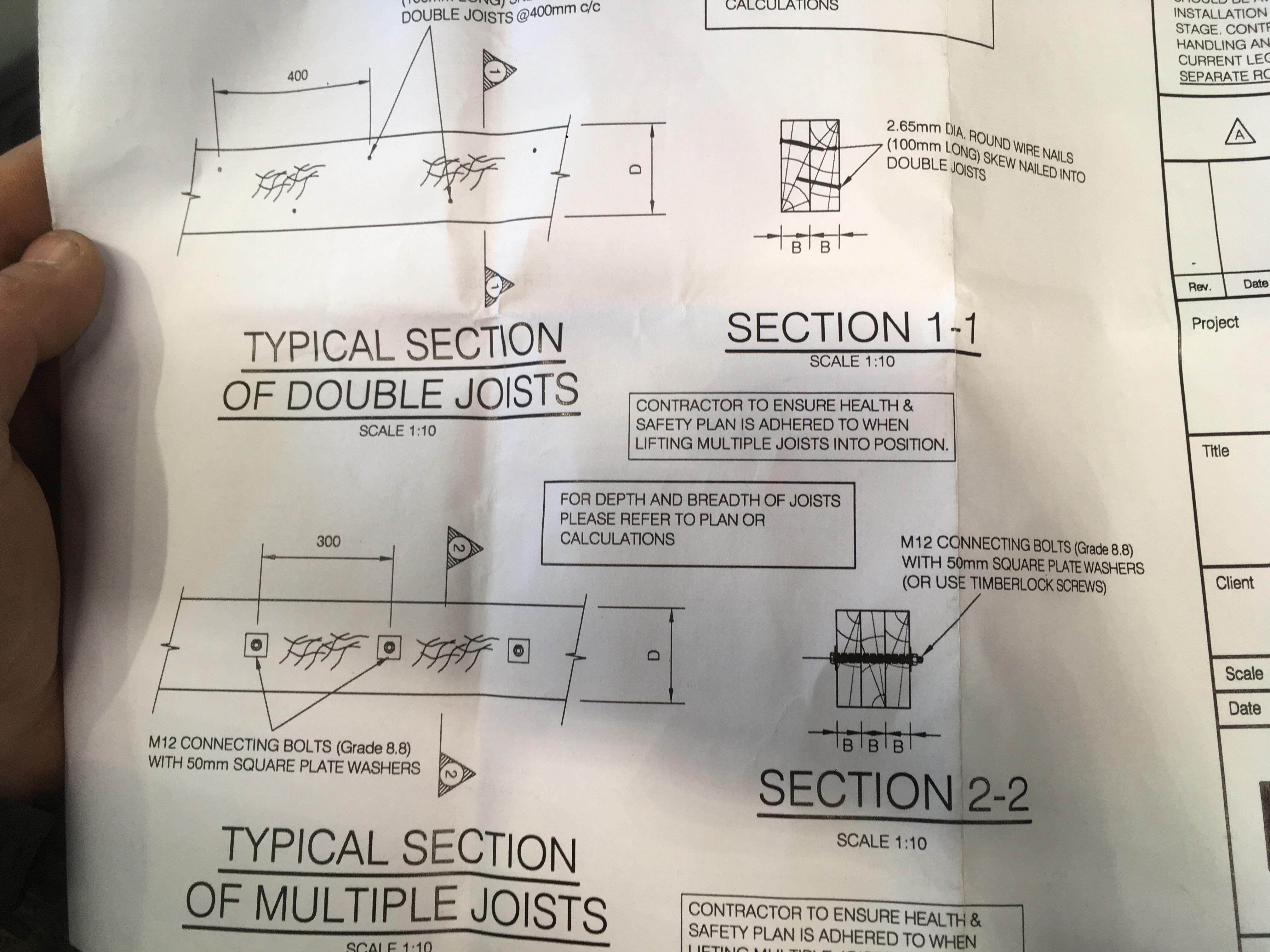

Construction Channel Posted May 17, 2018 Share Posted May 17, 2018 Sorry I’m late. But this is the detail we use from our SE Link to comment Share on other sites More sharing options...

Onoff Posted May 20, 2018 Share Posted May 20, 2018 On 17/05/2018 at 11:11, Construction Channel said: Sorry I’m late. But this is the detail we use from our SE You don't use dog tooth washers between abutted joists? Link to comment Share on other sites More sharing options...
Nickfromwales Posted May 20, 2018 Share Posted May 20, 2018 6 minutes ago, Onoff said: You don't use dog tooth washers between abutted joists? The good old days mate. I've not had that specified for an age, really not necessary unless it's a super-diverse scenario. Wood is nice and uniform these days so a lot better than before ( the old sawn stuff ). For belt n braces I just glue as well as bolt. When the glues gone off you could prob take the bolts out as that's a lot of surface area bonded to the same. Link to comment Share on other sites More sharing options...
