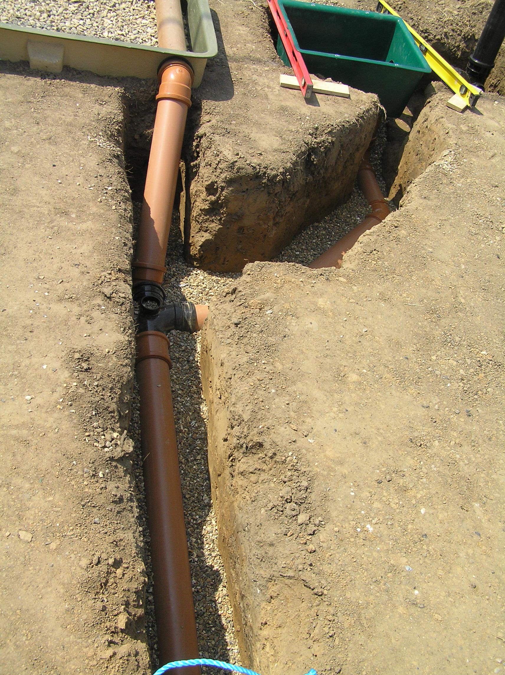

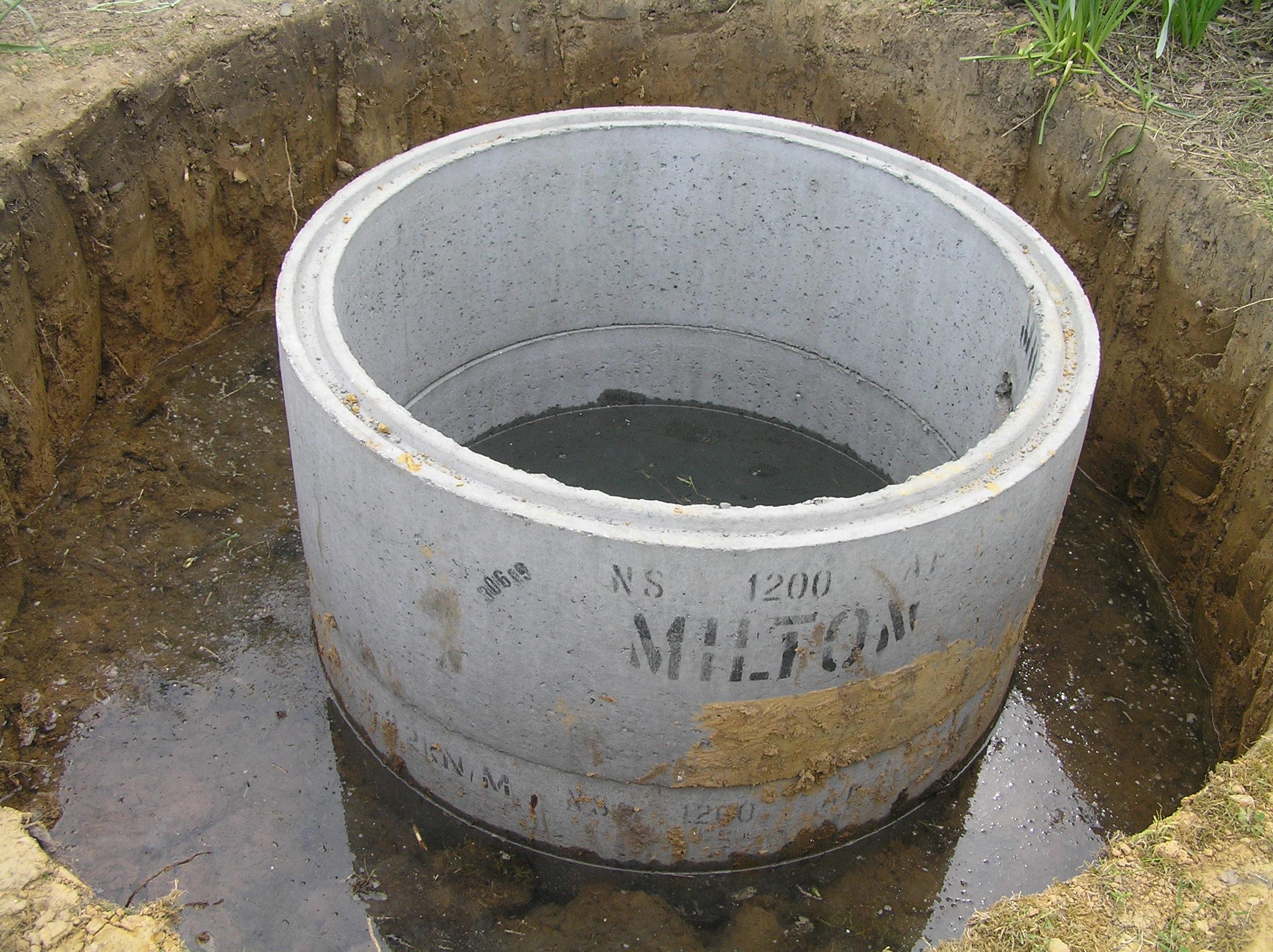

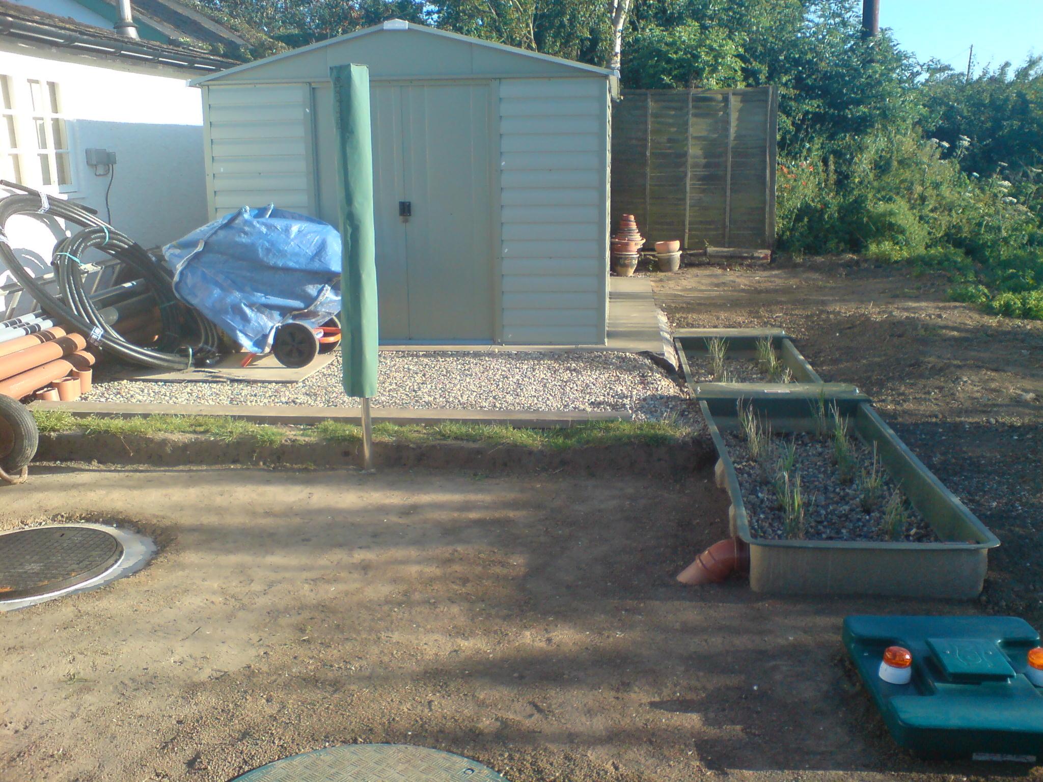

Gone West Posted January 11, 2019 Share Posted January 11, 2019 5 hours ago, Roz said: Do any of you remember what your install costs were for these? Trying to get price indications at the moment but we haven't had a percolation test done yet so not 100% sure on the system we will have. We also installed ours ourselves with some help from the local farmer. We dug the hole by hand down to the water table then the farmer dug the rest out. We didn't use concrete to hold the tank down but used galvanised irons with chains. The hole was backfilled with type1. The output goes into a reed bed system and then into a soakaway. The air pump housing has the two warning lights and is semi-buried. Link to comment Share on other sites More sharing options...
Jeremy Harris Posted January 11, 2019 Share Posted January 11, 2019 7 hours ago, Roz said: Do any of you remember what your install costs were for these? Trying to get price indications at the moment but we haven't had a percolation test done yet so not 100% sure on the system we will have. Hard to be sure what the cost was, as it was included in a big ground works contract, but around £1500 to install a pumped outlet Biopure. That included putting an outlet pipe across the lane and into the stream, so no land drains. Link to comment Share on other sites More sharing options...

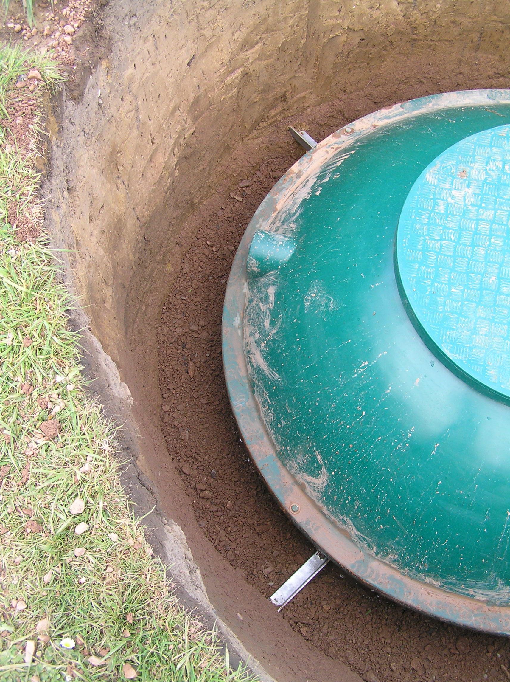

ProDave Posted January 11, 2019 Share Posted January 11, 2019 5 hours ago, PeterStarck said: We also installed ours ourselves with some help from the local farmer. We dug the hole by hand down to the water table then the farmer dug the rest out. We didn't use concrete to hold the tank down but used galvanised irons with chains. The hole was backfilled with type1. The output goes into a reed bed system and then into a soakaway. The air pump housing has the two warning lights and is semi-buried. That is one hell of a neat hole that. Well done. 1 Link to comment Share on other sites More sharing options...

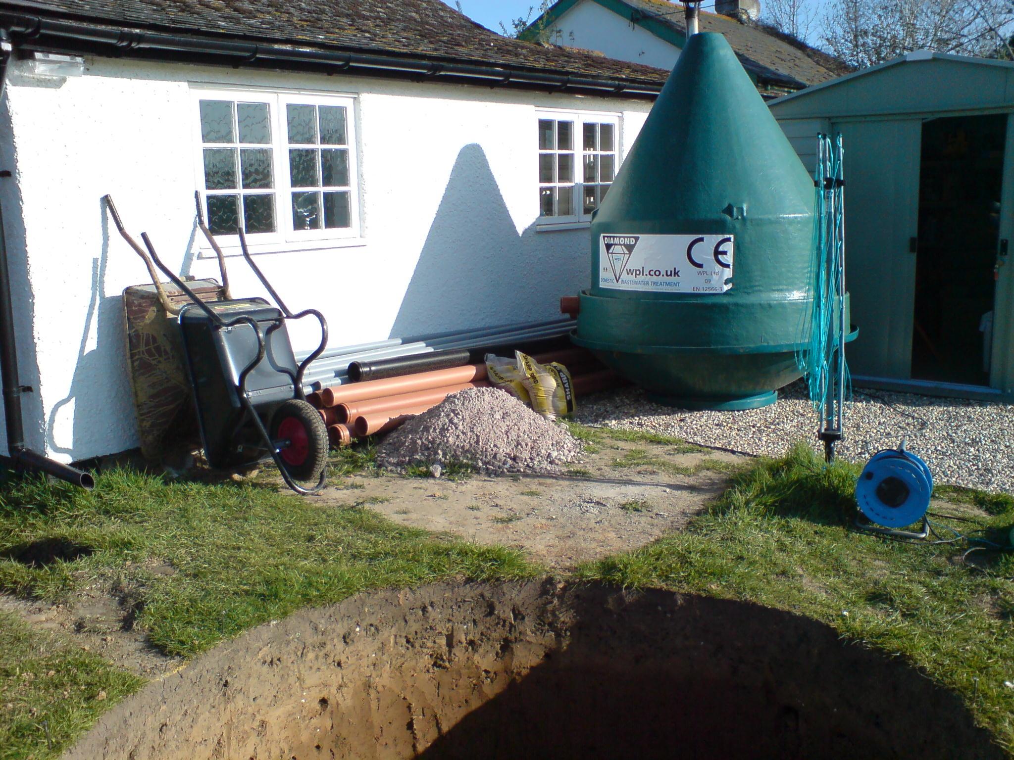

Roz Posted January 12, 2019 Share Posted January 12, 2019 On 11/01/2019 at 16:42, PeterStarck said: We also installed ours ourselves with some help from the local farmer. We dug the hole by hand down to the water table then the farmer dug the rest out. We didn't use concrete to hold the tank down but used galvanised irons with chains. The hole was backfilled with type1. The output goes into a reed bed system and then into a soakaway. The air pump housing has the two warning lights and is semi-buried. wow, how long did it take you to dig that by hand? Link to comment Share on other sites More sharing options...
Gone West Posted January 12, 2019 Share Posted January 12, 2019 5 minutes ago, Roz said: wow, how long did it take you to dig that by hand? IIRC about a day or so. Mind you it was nearly nine years ago and I was a lot fitter then as I was doing a lot of digging at the time. Link to comment Share on other sites More sharing options...
Onoff Posted January 12, 2019 Share Posted January 12, 2019 2 hours ago, PeterStarck said: IIRC about a day or so. Mind you it was nearly nine years ago and I was a lot fitter then as I was doing a lot of digging at the time. Look at that soil! You don't miss the clay up this way then? Link to comment Share on other sites More sharing options...
Gone West Posted January 13, 2019 Share Posted January 13, 2019 13 hours ago, Onoff said: Look at that soil! You don't miss the clay up this way then? No, there's a lot of sandy clay around here although the geology in this area changes very quickly over a short distance as we are on an old coast line with the marshes. Here, is Overland, which as the name suggests was a raised area of land on the edge of the marshes. Link to comment Share on other sites More sharing options...
