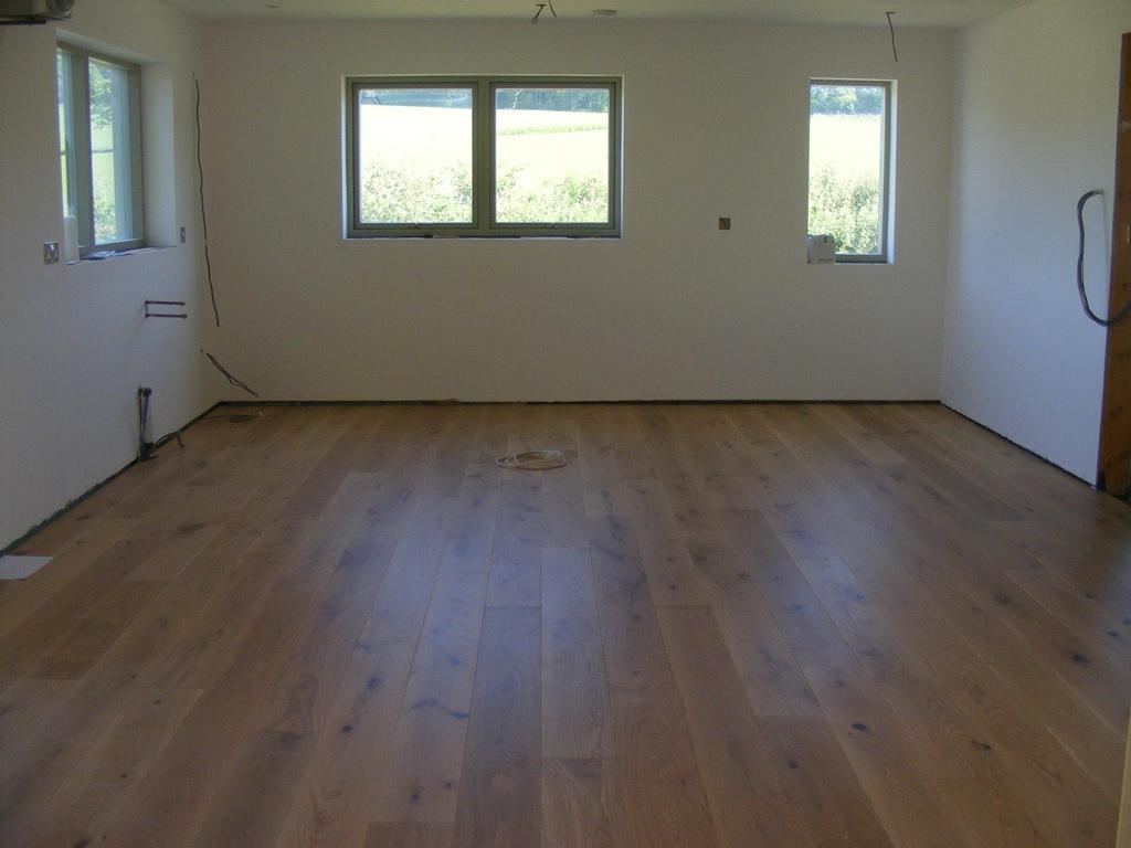

ProDave Posted June 10, 2018 Author Posted June 10, 2018 I forgot to come back and say we chose engineered Oak in the end for the whole room. In fact I collected it earlier in the week, all 700Kg of it a full trailer and car load but done in one trip. Room is plastered and painted, UFH to go down soon, then we start flooring. 1
ProDave Posted June 29, 2018 Author Posted June 29, 2018 Here are the long awaited photos of that floor. Battens, UFH and start of the biscuit mix And the oak flooring laid More pictures on the blog, look for the entry "Under Floor Heating and Oak flooring" 2
