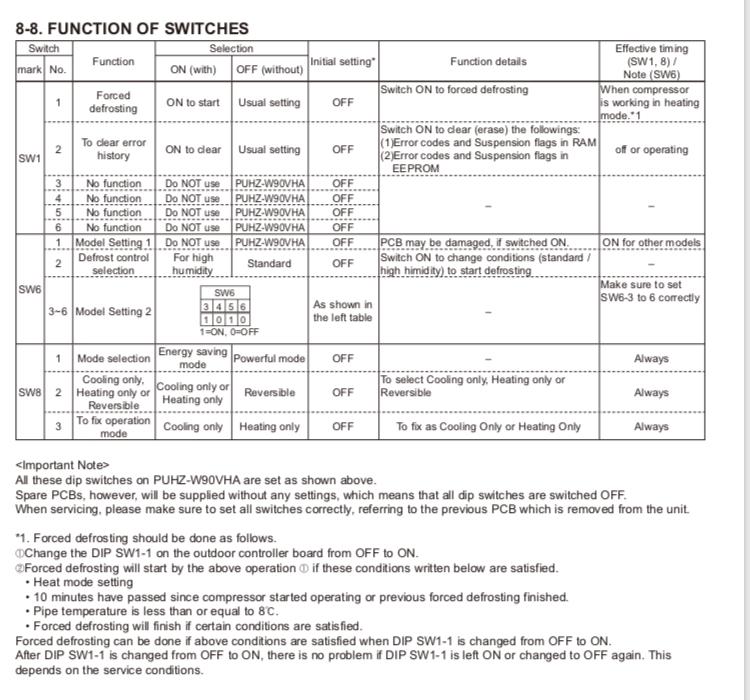

PeterW Posted August 31, 2018 Share Posted August 31, 2018 So... The IVT unit is from the IVT AirCombo 60 that they no longer sell. IVT have been really helpful - it’s apparently a rebadged (wait for it .....) Mitsubishi Unit as used in the Ecodan series ..! Correct model is the PUHZ-W90VHA, however it interfaces with the rather nice Ecodan controller that is north of £900.... The A terminals are inputs, the B terminals are error or output. Just trying to get some more info on what each one is as it’s not that complicated to use by the look of it and it’s either PMW or 0-24v on one of those pins And @JSHarris it has a cooling function too..! Link to comment Share on other sites More sharing options...
Jeremy Harris Posted August 31, 2018 Share Posted August 31, 2018 10 minutes ago, PeterW said: And @JSHarris it has a cooling function too..! They all have a cooling function, as they have to in order to defrost. The problem is that to be sold in the UK as an MCS approved product, that's eligible for RHI, the cooling functionality has to be hidden from the installer or user instructions. I had to reverse engineer mine to find it, which wasn't hard as the installation instructions showed that two no-volt connections had to be switched to ground to make the ASHP turn on. I tried just grounding one and the heat pump didn't turn on, so then tried just grounding the other and it turned on, but in cooling mode. A quick test with grounding the other connection showed that all it did was switch the unit to heating mode if grounded or cooling mode if left open circuit. Link to comment Share on other sites More sharing options...
PeterW Posted August 31, 2018 Share Posted August 31, 2018 @DeeJunFan @readiescards @joe90 These have a fairly simple binary output tree - if I get more info I will let you know. Other issue is there is a set of DIP switches that control the defrost cycle - switch one and two must be off.... Link to comment Share on other sites More sharing options...

PeterW Posted August 31, 2018 Share Posted August 31, 2018 So in the interests of sharing what I have been provided by a very helpful IVT support engineer : The A-inputs acts like a “binary staircase”. So each signal is either on or off, 24V (not PWM). Step A1 A2 A3 Power 0 0 0 0 0% 1 0 0 1 30% 2 0 1 0 42% 3 0 1 1 53% 4 1 0 0 65% 5 1 0 1 77% 6 1 1 0 88% 7 1 1 1 100% For the B-outputs : B3 B2 Operating mode 1 1 Normal 1 0 Restricted 0 1 Defrost 0 0 Failure/Power off Looking at the wiring, A5 and B1 are bridged to a common point (need to confirm 24v or GND) which leaves the A4 terminal all lonely .... Anyone hazard a guess as to what it actually does ..? I think cooling ..! Just to add to this, these are the DIP switch settings : I will share the service manual for the Mitsubishi unit if anyone wants it but it’s avaialble online 2 Link to comment Share on other sites More sharing options...
