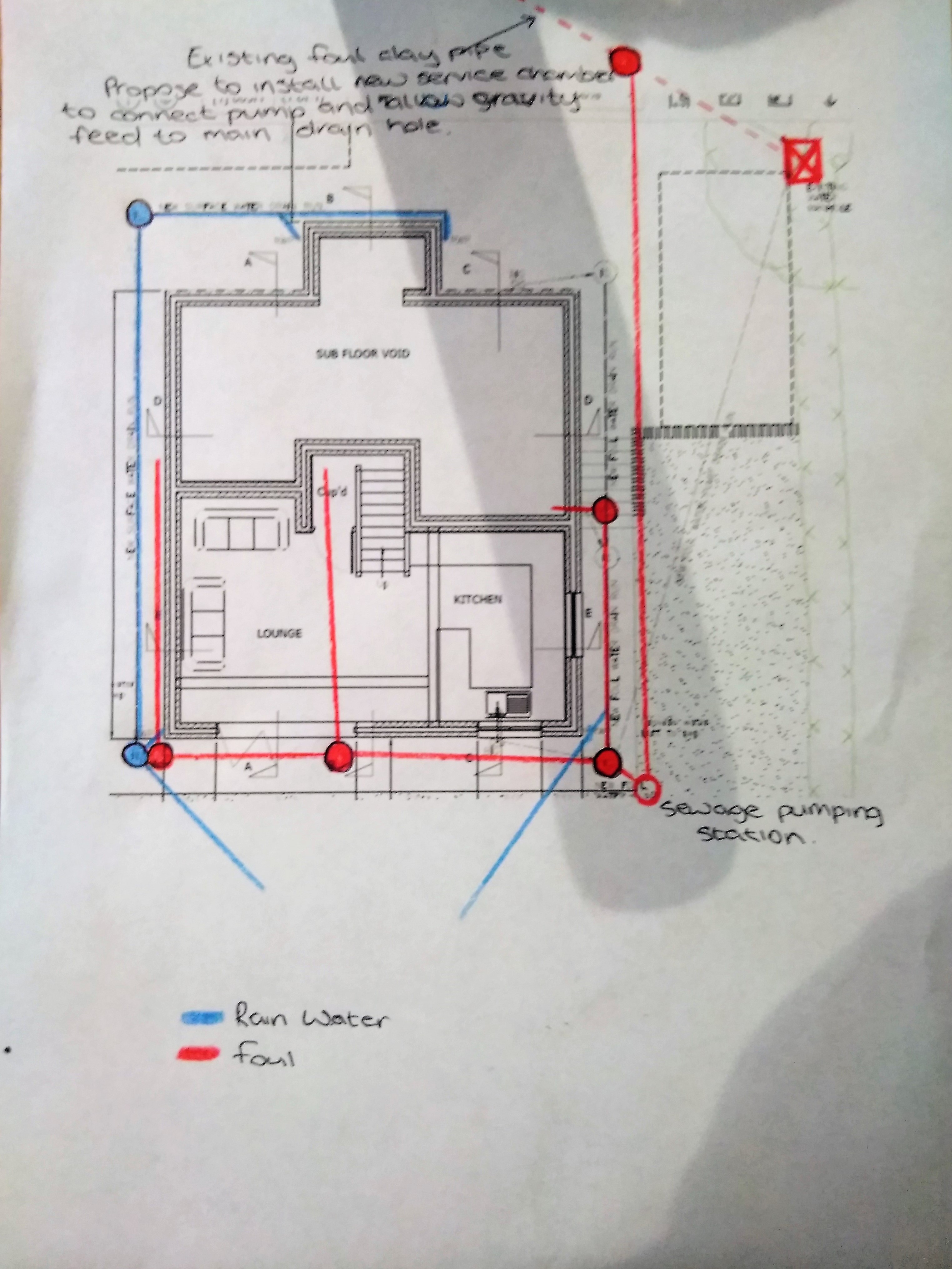

Hecateh Posted April 23, 2018 Posted April 23, 2018 Does anyone know anything about connecting to the sewers. I can't get a gravity feed as the chamber is under next doors garage so have opted for a pump We were intending to pump up and straight into a brick built chamber that is just within my garden but the water authorities have said no, it has to be a gravity feed - but there isn't anywhere high enough to put a chamber that can gravity feed into the pipe anywhere on the property. There has to be a solution surely Attached plan shows layout High Croft Bungalow b regs-005M.pdf
epsilonGreedy Posted April 23, 2018 Posted April 23, 2018 You could ask your architect Taylor Tuxford how they propose to resolve their design error. Would it be possible to pump just the grey water from the kitchen up to the main foul drain level on the mid floor and let gravity work from there?
Mr Punter Posted April 23, 2018 Posted April 23, 2018 Can you move the rising main over to the left, then have a 45 degree bend on either side of new 450mm plastic chamber to feed into the brick chamber? Admitted that the length of gravity pipe is short but the new chamber and change of direction should attenuate the flow. I have marked on the attached. High Croft Bungalow b regs-005M.pdf

Hecateh Posted April 23, 2018 Author Posted April 23, 2018 Sorry - I wasn't very clear I already have the pump in place as that is the way we were going. Architects marked it straight into the brick chamber. That is what the water board won't have. they want it going to a chamber and then gravity feed to the pipe or the chamber I'm not sure which. @Mr Punter is what I was looking at doing - I have drawn something very similar. Bb doesn't think that works but I can't see why not.

Mr Punter Posted April 23, 2018 Posted April 23, 2018 17 minutes ago, Hecateh said: Sorry - I wasn't very clear I already have the pump in place as that is the way we were going. Architects marked it straight into the brick chamber. That is what the water board won't have. they want it going to a chamber and then gravity feed to the pipe or the chamber I'm not sure which. @Mr Punter is what I was looking at doing - I have drawn something very similar. Bb doesn't think that works but I can't see why not. It should be fine if you add in the extra chamber before the final one. Who is Bb? 1
Hecateh Posted April 23, 2018 Author Posted April 23, 2018 22 minutes ago, Mr Punter said: It should be fine if you add in the extra chamber before the final one. Who is Bb? billy the builder This is his plan

Mr Punter Posted April 23, 2018 Posted April 23, 2018 1 hour ago, Hecateh said: billy the builder This is his plan OK but I would not cut into the neighbours sewer line - just put in a new IC and connect this to the brick IC
Hecateh Posted April 23, 2018 Author Posted April 23, 2018 5 minutes ago, Mr Punter said: OK but I would not cut into the neighbours sewer line - just put in a new IC and connect this to the brick IC The 'neighbour' is currently me. There is an inspection chamber on my current bungalow land that takes mine and my neighbours drain. Where he is planning on cutting into it it is already on the new house land and the existing chamber is also now on the new property. The water board seem to prefer joining pipes rather than going direct into the chamber. I thought I may send them the 2 options and let them decide which they prefer.
