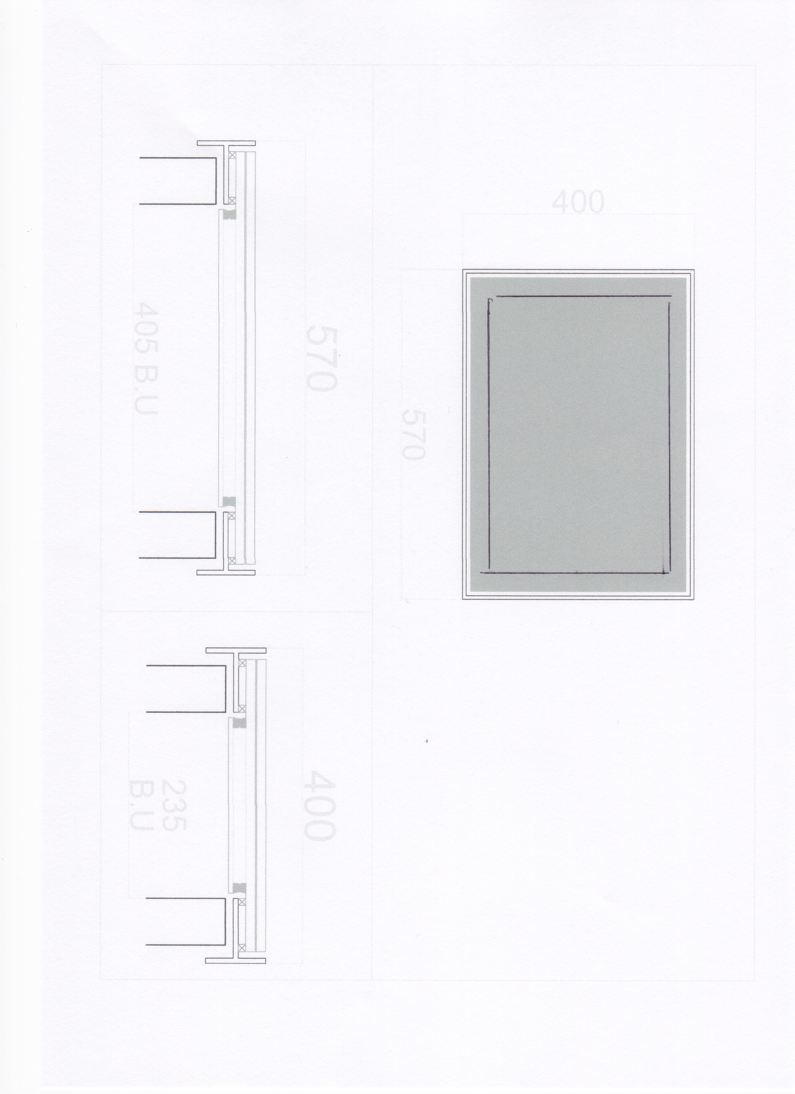

So first photo...hole in slab is massively over size?
The skylight on the right of the hole consists of a really thick black frame and a piddly little window in the middle?
So make the hole smaller? Drill a line of holes into the slab edge, fit studs say M16 and resin anchor them in. Shutter up in ply and recast the edge of the hole.
Yeah I did think of that . But as you say it’s piddly . These are for an underground living space so light is important. ?

TBH I think there is fault on both sides.
They knew they were going to sit on up stands .
And yes the drawing has dimensions I signed off. But I think their drawing should of been:

I agree . But the fact others agree the drawings can be misleading means errors on both sides . The only dimension I could give the company is the size of the holes . Walk on glass sits on it not in it ...

Sorry about the cock-up.  Whose plans did they base their drawing on?  I would be really interested to see a proper section, showing the concrete, insulation, waterproofing, upstand and surface finish if you have such a thing?
Perhaps you could at least get the supplier to make the replacements at the same cost as the originals - even though they will be a fair bit bigger?
I just supplied the hole dimensions that’s it

For when the replacements are arranged, the fitting tolerance between the inner pane and the upstand looks very tight.  Also the upstands do not look very wide - 70mm?  Are they insulated?
50mm non insulated
1 hour ago, pocster said:
50mm non insulated
I think you will need some insulation to stop the moisture from the warm air in the house condensing on the upstands.
Yeah I was going to insulate the up stand outside and in
I’ve looked at the drawings again, the plan view shows a glass panel of the dimensions shown on the section,  it bears no resemblance with what they’ve actually supplied. I’d say the fault is entirely theirs.

I'm hoping they do too! For something as spendy as these windows were if that's all the paperwork you got it's a bit crap TBH! You can alway say you're on a big self build forum ;)
