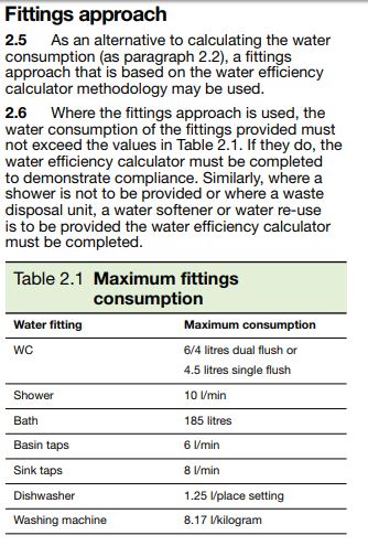

lizzie Posted April 18, 2018 Posted April 18, 2018 Can anyone tell me if to get their build completion sign off they have had to provide a cert from plumber or someone for Part G water regs. I saw in our BC submission there was reference to caluclations at no more than 125l, I have never seen any detail on these calculations but in an old e-mail from around the the time the architect was suggesting flow limiters on taps and shower to achieve this. As far as I know we have not installed any flow limiters (but guess if we need them they can be retro fitted?) I am not clear who should give me the cert for building control......we had one plumber to do plant room and hot and cold feeds to supply points per drawings then a completely different plumber to do a first fix from the supply feeds ready for second fix. He did second fix plumbing as well. So two questions please...do I need a cert and if so who does it.

ADLIan Posted April 18, 2018 Posted April 18, 2018 As an alternative simply confirm all fittings comply with Table 2.1 in AD G! 1 2
Mr Punter Posted April 18, 2018 Posted April 18, 2018 58 minutes ago, ADLIan said: As an alternative simply confirm all fittings comply with Table 2.1 in AD G! Excellent. I was still going by the old version. 1
Mr Punter Posted April 18, 2018 Posted April 18, 2018 14 minutes ago, PeterW said: Which is here... Approved Doc G Shamefully I was still using the 2010 edition!! Have now downloaded the fresh one. 1

Mr Punter Posted April 19, 2018 Posted April 19, 2018 To be clear, as @PeterW pointed out, the Building regs have changed (since the edition I was referencing!) and you no longer have to complete the spreadsheet, just confirm that none of the fittings exceed the values in table 2.1. You don't even need to know what is in table 2.1, just confirm. 1
lizzie Posted April 19, 2018 Author Posted April 19, 2018 4 minutes ago, Mr Punter said: To be clear, as @PeterW pointed out, the Building regs have changed (since the edition I was referencing!) and you no longer have to complete the spreadsheet, just confirm that none of the fittings exceed the values in table 2.1. You don't even need to know what is in table 2.1, just confirm. Ah sorry I had not grasped that. Thank you!
