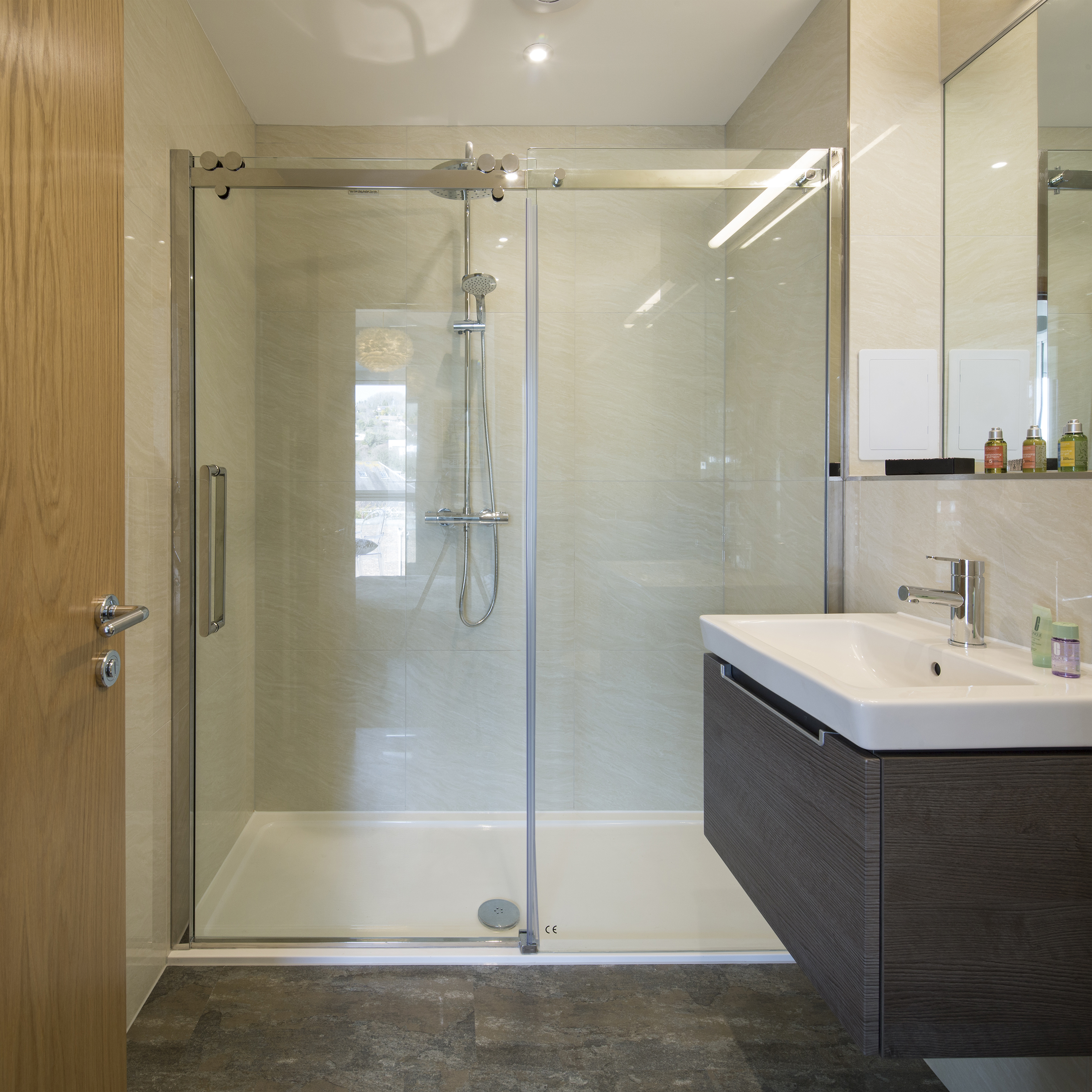

Mr Punter Posted April 19, 2018 Posted April 19, 2018 We have very shallow trays and have screwed 18mm ply on the shower room floors, finished with LVT, so they are level with adjacent oak floors and the trays are only about 30mm higher.
vivienz Posted April 19, 2018 Posted April 19, 2018 24 minutes ago, Mr Punter said: We have very shallow trays and have screwed 18mm ply on the shower room floors, finished with LVT, so they are level with adjacent oak floors and the trays are only about 30mm higher. I like the sink and cabinet - may I ask where you bought them?
Nickfromwales Posted April 19, 2018 Posted April 19, 2018 1 hour ago, Mr Punter said: We have very shallow trays and have screwed 18mm ply on the shower room floors, finished with LVT, so they are level with adjacent oak floors and the trays are only about 30mm higher. You took the words right out of my mouth. In @Visti's case, I'd have the screed shuttered out a bit and set the tray so it's 15mm proud of the finished floor covering. That creates an almost sunken look to the tray and removes almost all of the lip, so nigh-on level entry. A good way to create a sleek look, minimum effort and guaranteed results.
