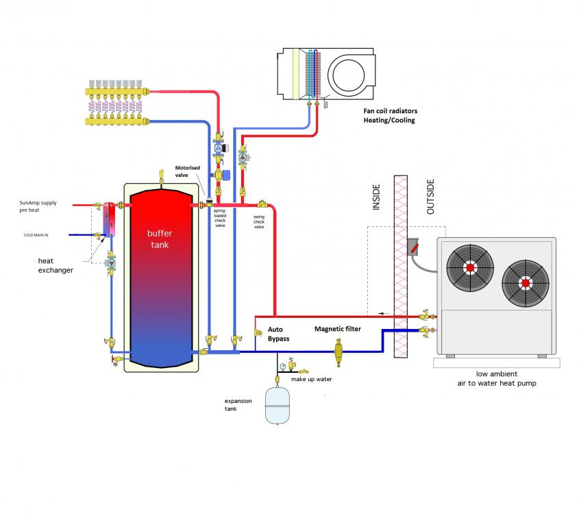

Triassic Posted April 17, 2018 Author Posted April 17, 2018 (edited) I've read various rather complex posts on heating and hot water systems, I tend to be better able to understand a system when I have a diagram. Does anyone have a heating and DHW stem diagram that includes the use of a Sunamp? Edited April 17, 2018 by Triassic

Nickfromwales Posted April 17, 2018 Posted April 17, 2018 15 minutes ago, Triassic said: I've read various rather complex posts on heating and hot water systems, I tend to be better able to understand a system when I have a diagram. Does anyone have a heating and DHW stem diagram that includes the use of a Sunamp? Didn't someone email you a diagram a while ago?
Nickfromwales Posted April 17, 2018 Posted April 17, 2018 Just now, Triassic said: Ahh you might be right, Ill do a search. That one is specific to a customer so just use that to get your head around it
Triassic Posted April 17, 2018 Author Posted April 17, 2018 (edited) @dogman kindly produced this diagram of his UFH heating system. I was wondering how much of this kit can be eliminated, thus saving money, by using a Sunamp to do both DHW and UFH? Edited April 17, 2018 by Triassic
Nickfromwales Posted April 17, 2018 Posted April 17, 2018 4 hours ago, Triassic said: @dogman kindly produced this diagram of his UFH heating system. I was wondering how much of this kit can be eliminated, thus saving money, by using a Sunampto do both DHW and UFH? As it stands, with the PCM34 on ice due to technical problems, not that much TBH. See the last comment in my post here...... ....where ive had to revert back to a buffer tank instead of a pair of 6kW PCM34 Sunamp units. As it says, im just juggling the anti-freeze isolation issue ( minimising the volume of antifreeze rich water by not having the buffer full of that water ) a bit more before I cement a design to overcome this problem.
oranjeboom Posted April 17, 2018 Posted April 17, 2018 31 minutes ago, Triassic said: I was wondering how much of this kit can be eliminated, thus saving money, by using a Sunamp to do both DHW and UFH? That's been on my mind also these past few days. Just been trawling 20+ pages on ebuild on sunamp discussions, but still none the wiser. I suspect that with a Sunamp stack (having sufficient cells) could do both DHW and UFH, but would probably still need a combi if using PV or other heat source (for those Cumbrian weeks where you get no sun) or perhaps an ASHP....and then still need a buffer tank. But that plumber chap from the Valley's will be along soon enough no doubt with his wisdom.
Alexphd1 Posted April 17, 2018 Posted April 17, 2018 Is that diagram based for a system with ASHP cooling set up?
Nickfromwales Posted April 18, 2018 Posted April 18, 2018 3 hours ago, oranjeboom said: That's been on my mind also these past few days. Just been trawling 20+ pages on ebuild on sunamp discussions, but still none the wiser. I suspect that with a Sunamp stack (having sufficient cells) could do both DHW and UFH, but would probably still need a combi if using PV or other heat source (for those Cumbrian weeks where you get no sun) or perhaps an ASHP....and then still need a buffer tank. But that plumber chap from the Valley's will be along soon enough no doubt with his wisdom. Depends if you want cooling. If you don't, you could go all Sunamp for space heating and DHW via E10 grid electricity and fortify with PV where budget allows.
