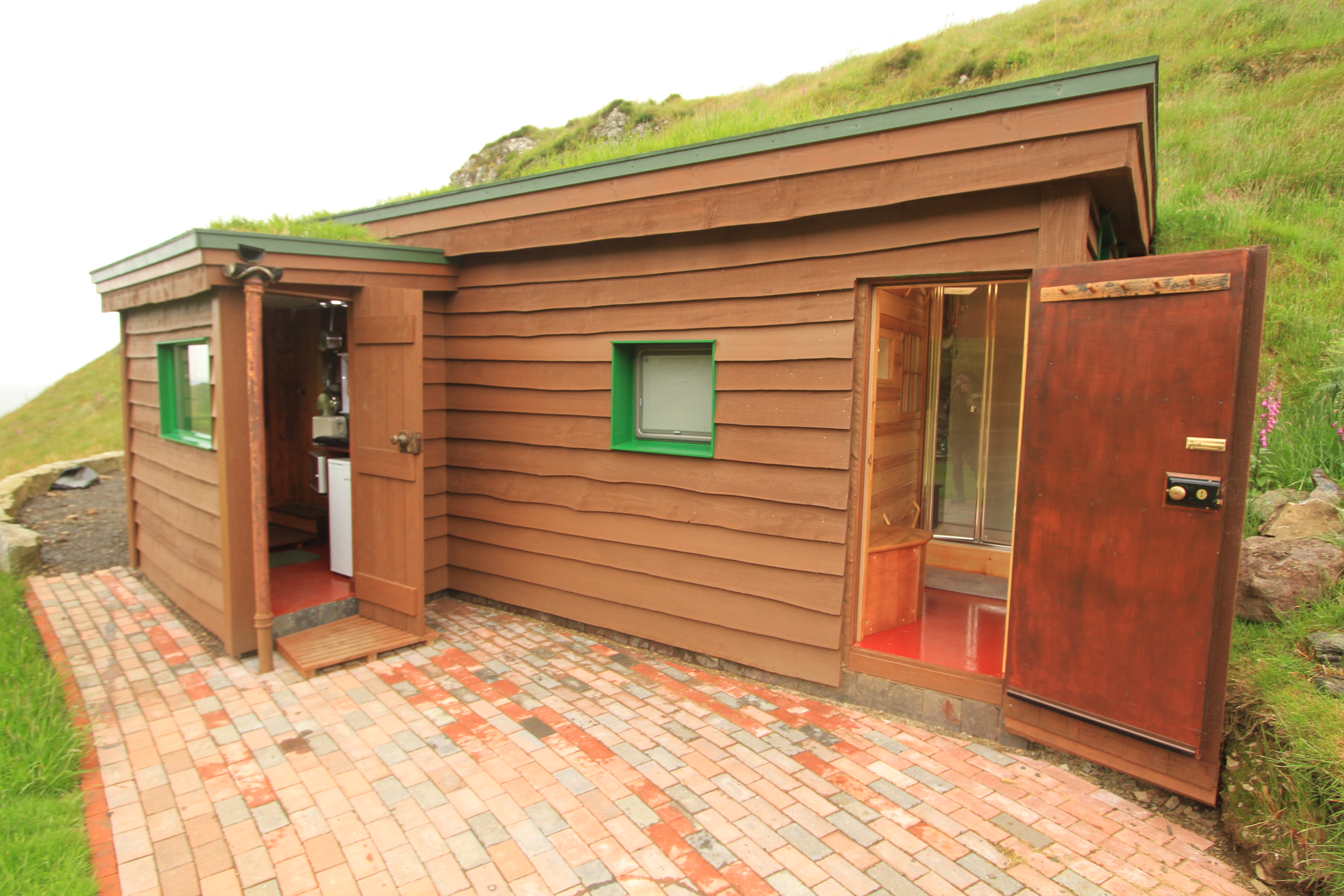

Cpd Posted April 18, 2018 Posted April 18, 2018 9 minutes ago, Tennentslager said: Very nice hut you got there @Cpd? Thanks, love building stuff.......
