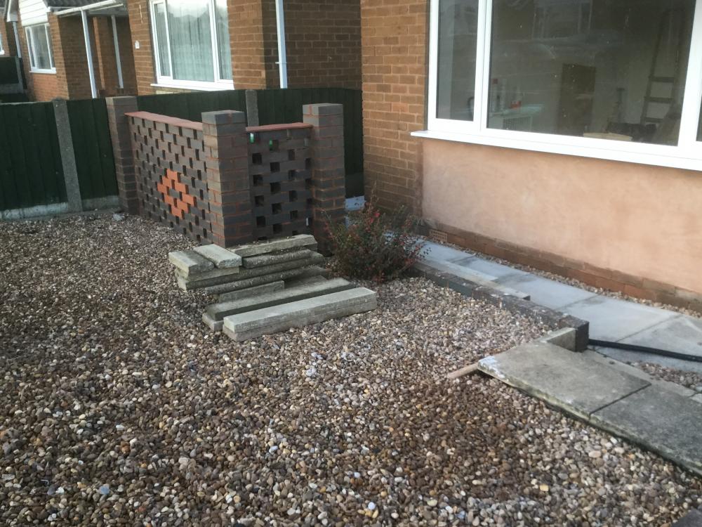

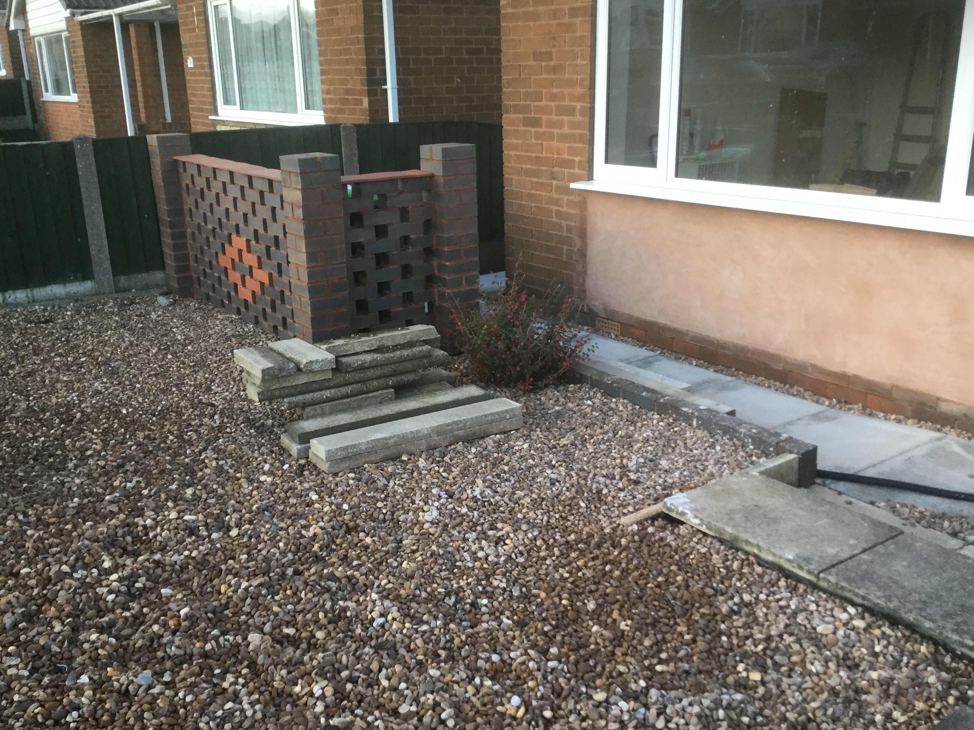

Ferdinand Posted March 29, 2018 Share Posted March 29, 2018 (edited) If you rely on sand for colour, make sure that each undivided visual section uses a consistent colour and buy enough in each purchase to cover that ... because they will not necessarily be consistent over time. And buy enough ! My garden wall at the Little brown Bungalow deliberately used red sand from a particular local BM that was redder tan everybody else’s sand, and it caused a problem when we ran out at a weekend when they were closed. The render in this pic is entirely coloured by the sand, and uses normal cement. Ferdinand Edited March 29, 2018 by Ferdinand Link to comment Share on other sites More sharing options...
