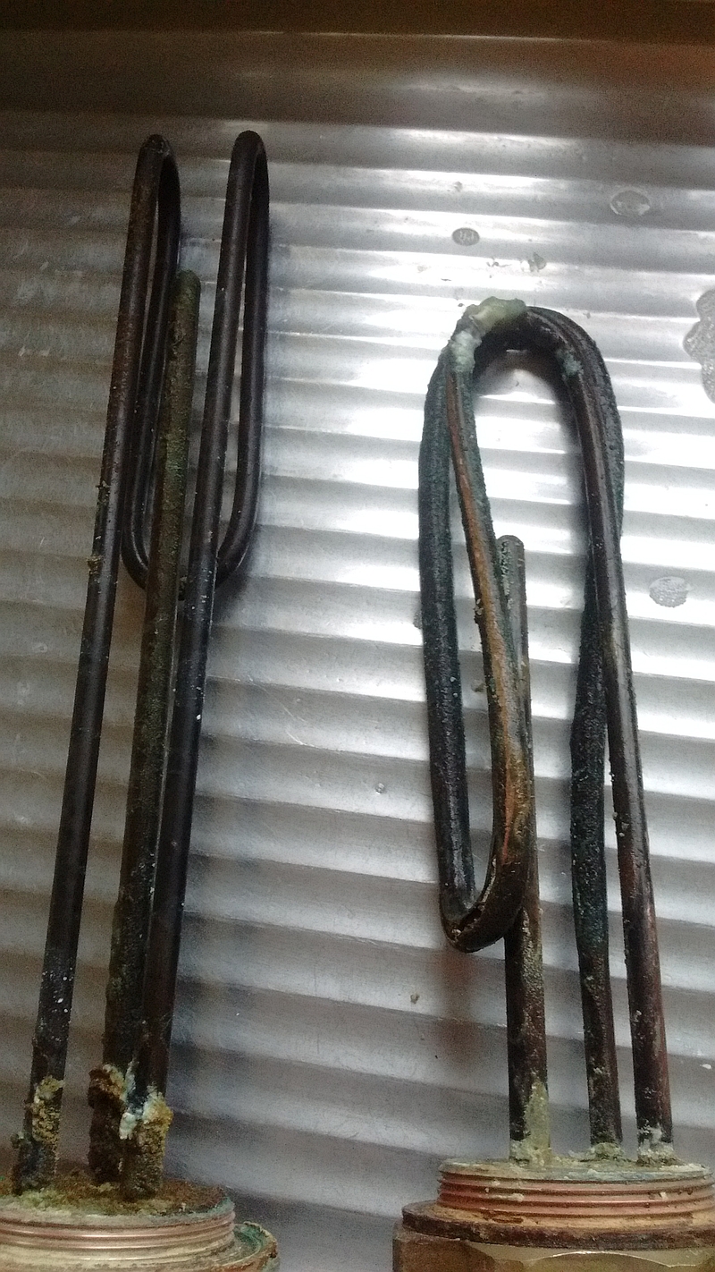

Thought I would drag out the 31 year old elements from my old cylinder.  They came out easier than expected.
The one on the right is the lower 'night' element and lasted 30 years before it went, the one of the left is the top element and is still good.
What is that jelly though, have I created a new life form.

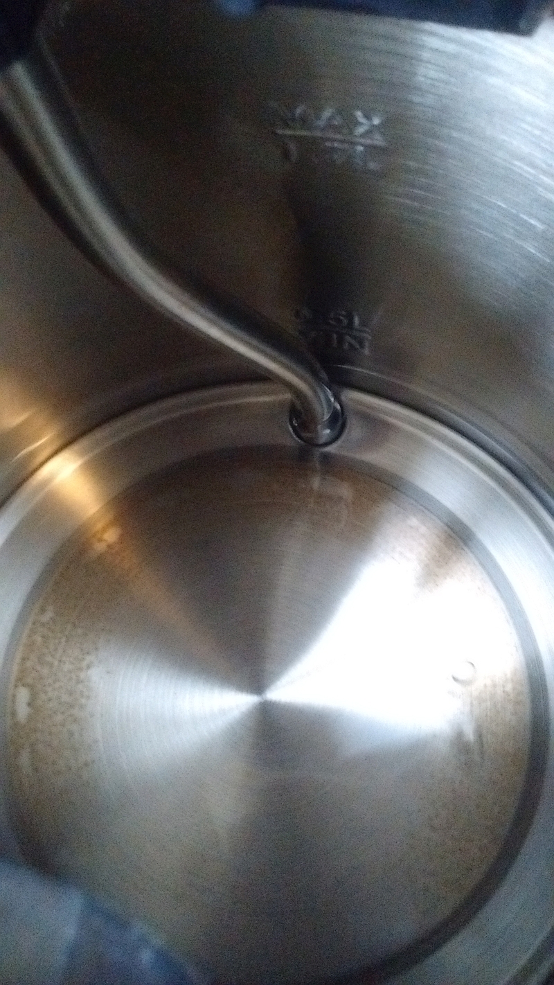

This is the inside of the kettle.
Was the one from work so boiled about 20 times a day and is probably 5 years old.

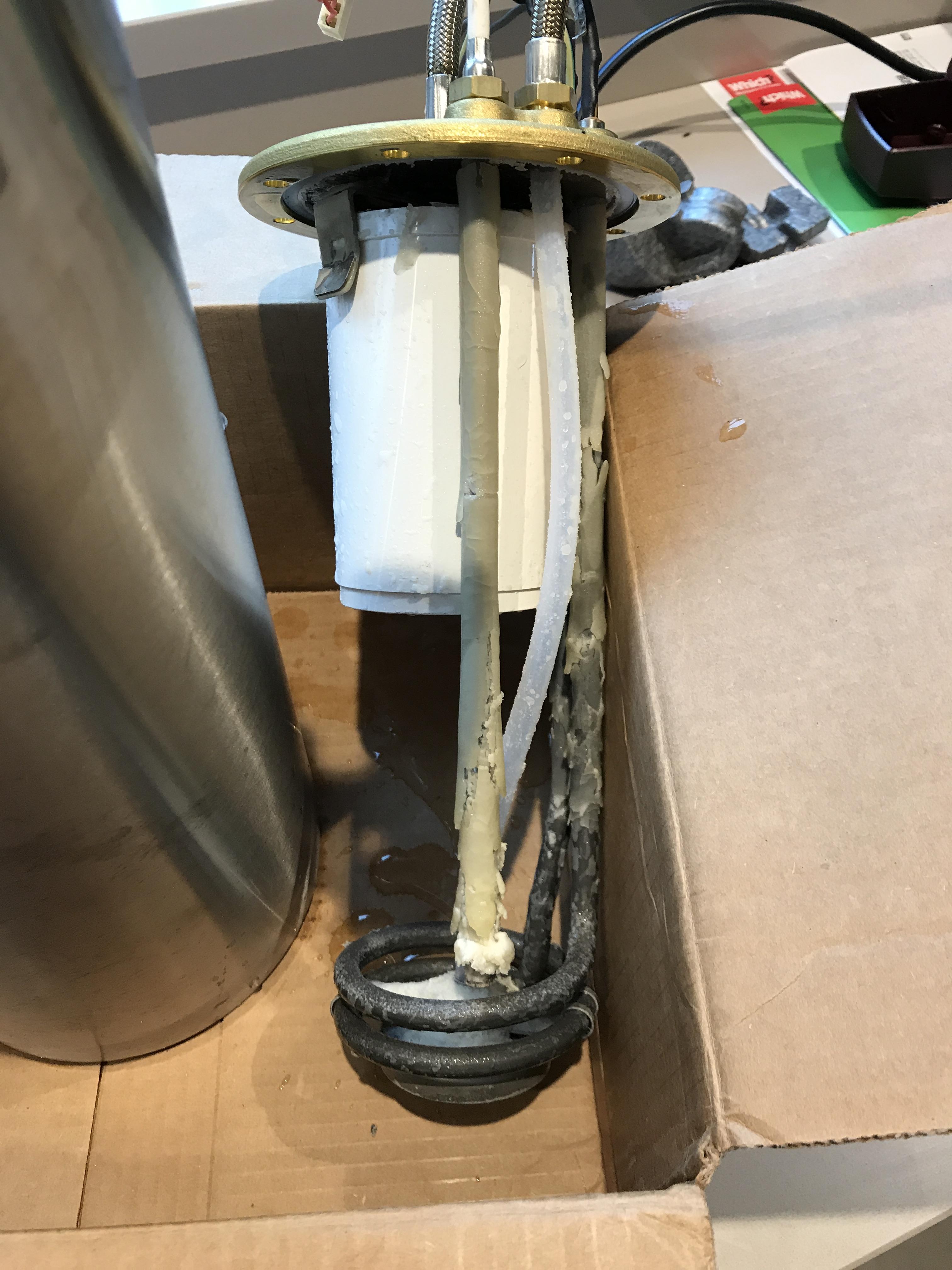

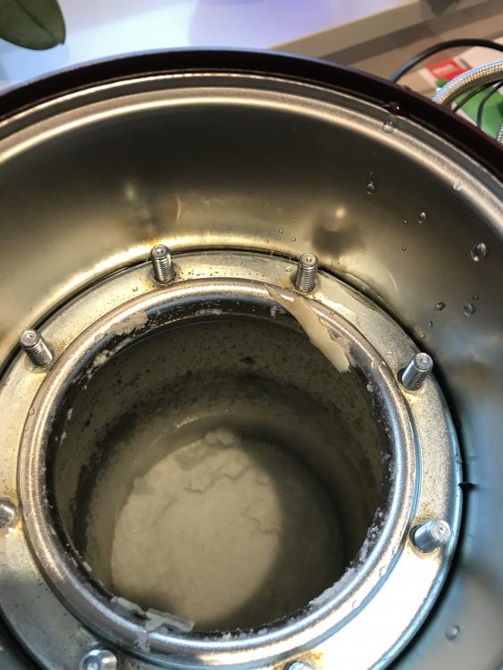

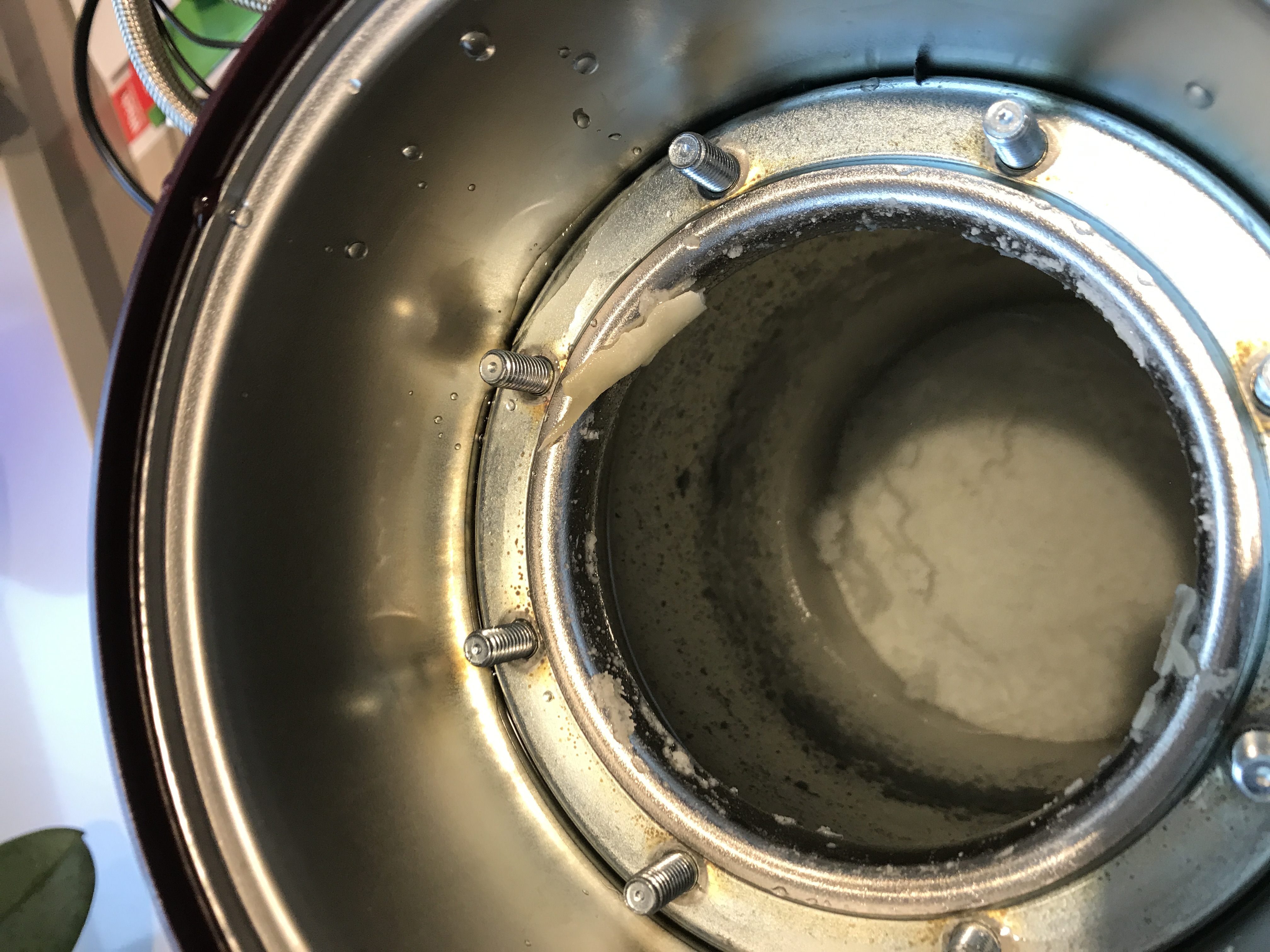

Finally got round to descaling it yesterday (has been running for 18 months) with the free kit they post out. Easy enough process.
Extracted 450g of scale from the 3l tank! Won’t leave it as long next time ...
