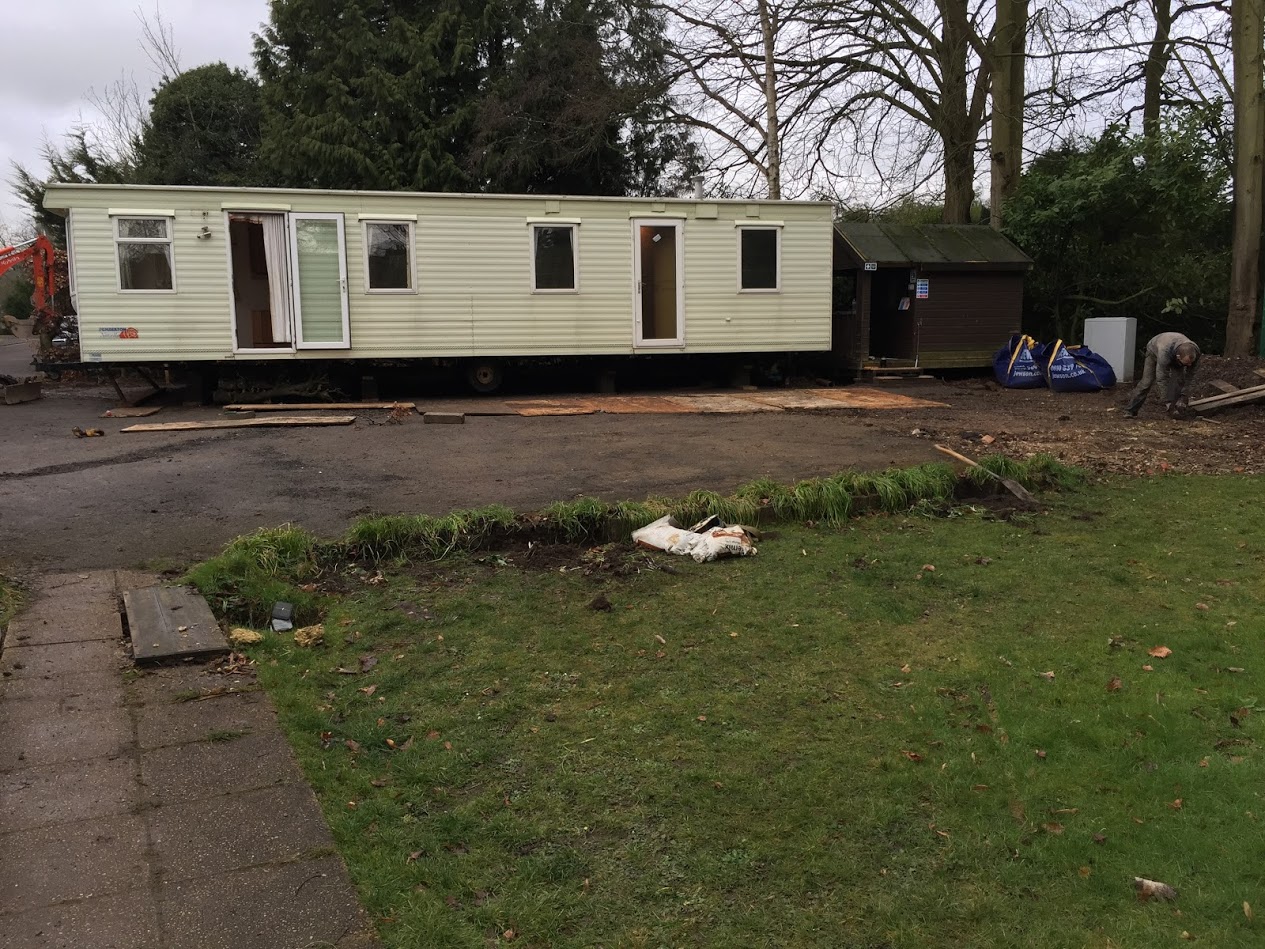

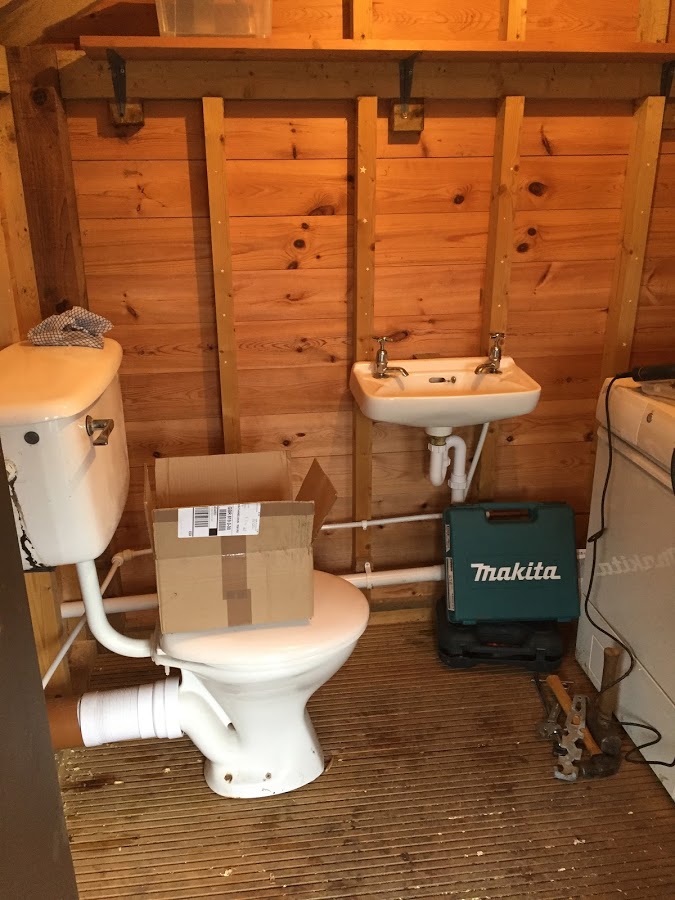

Weebles Posted March 15, 2018 Share Posted March 15, 2018 The caravan is here! My question is do we need an LPG registered gas engineer to connect up to the two 47kg LPG units? And what about when we need to change them? Or can we do this ourselves (the pigtails are already on the end of the caravan and the boiler has been serviced before we got it). For interest, the shed (ex-playhouse) to the right hand side is the outside toilet cum laundry. Fitting it out has kept him indoors happily occupied for a good couple of weekends..... Link to comment Share on other sites More sharing options...

Nickfromwales Posted March 16, 2018 Share Posted March 16, 2018 2 minutes ago, Bitpipe said: You also need to make sure the bottles can't fall over accidentally - I sunk two fenceposts into the ground with post-crete and put a ring on each one with level slabs in front. Chained each bottle to the post behind it and chained them to each other and a third post for security. This is FUNDAMENTALLY important!!! Do not think that as this is a 'van it's any less of a risk to life. The botttles being chained so they can't fall over is part of gas safe criteria. 4 minutes ago, Bitpipe said: We got a Gas Safe plumber to install the new one and check the water heater and fire. CO alarm mandatory next to your water heater. Don't ever even think about recommissioning a gas burning appliance without doing so. A gas leak ( drop / tightness ) test and thorough inspection of the flue and how it's connected to the boiler must be carried out. Dont mess with gas, or anything that either produces CO1 or can blow up ! Link to comment Share on other sites More sharing options...
Weebles Posted March 17, 2018 Author Share Posted March 17, 2018 We have a gas safety certificate for the caravan boiler (dated Nov 2017, so it's a while ago). @Nickfromwales just to be clear, are you saying to get a gas safe plumber in to double check it all (post transportation) before connecting to the cylinders? Don't want any explosions. Thanks for advice re securing cylinders. Will get onto that straight away. We can chain them to the playhouse but some fence posts sunk in either side will make sure of it. Will post some pics..... @Luckylad we are going to be in this beauty for about 18 months we reckon. Glad we are not in it tonight though (-3). Good tip @Bitpipere the gas fire. We've got a dehumidifier in there already - cleaned the floor today and it was never going to dry in these temperatures....... the marriage just survived someone letting all the oil out of the hydraulic bottle jack (whilst trying to release the air) in the middle of levelling the caravan in the rain this week ? Link to comment Share on other sites More sharing options...

Nickfromwales Posted March 17, 2018 Share Posted March 17, 2018 47 minutes ago, Weebles said: We can chain them to the playhouse So.........not content with the lunacy of self-building you now want to attach a big sail to your gas bottles 47 minutes ago, Weebles said: just to be clear, are you saying to get a gas safe plumber in to double check it all (post transportation) before connecting to the cylinders? Too damn right. The alternative is you connect it and jump in bed hoping it's ok . CO1 detectors detect products of combustion eg they don't tell you there's a gas leak, but the light switch will Gas = due diligence. . You'll need the bottles there when the GSR'd plumber arrives, so it can be pressurised and tested. Nowt can be done if the bottles aren't there. Link to comment Share on other sites More sharing options...

Weebles Posted March 18, 2018 Author Share Posted March 18, 2018 Thanks @Nickfromwales - we'll be getting the bottles and the man to check it all out and connect it properly. Wise words indeed and your guidance is much appreciated. Going to need a twister to move that playhouse - it's now on mains drainage and doubles up as site toilet and teenage boy toilet ? as well as a laundrette / first aid station and general site storage. Figured it saved us the site toilet rental though it has taken a lot of time to sort out. 1 Link to comment Share on other sites More sharing options...
