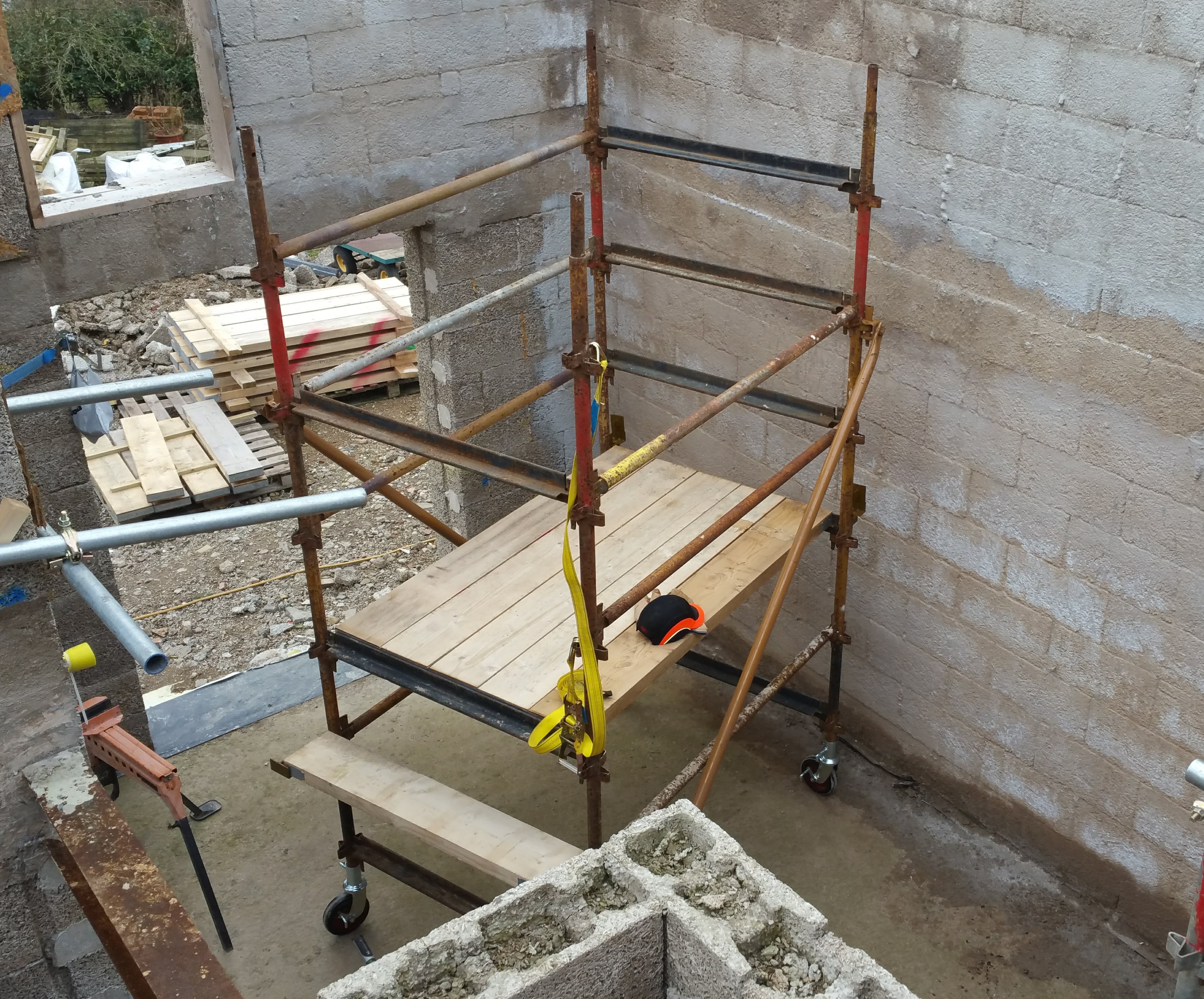

ToughButterCup Posted March 14, 2018 Share Posted March 14, 2018 Since you are going to need scaffold later, try a bit of kwikstage. Buy four casters and you have yourself a mobile platform, like this. 1 Link to comment Share on other sites More sharing options...

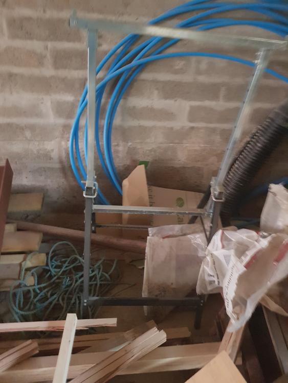

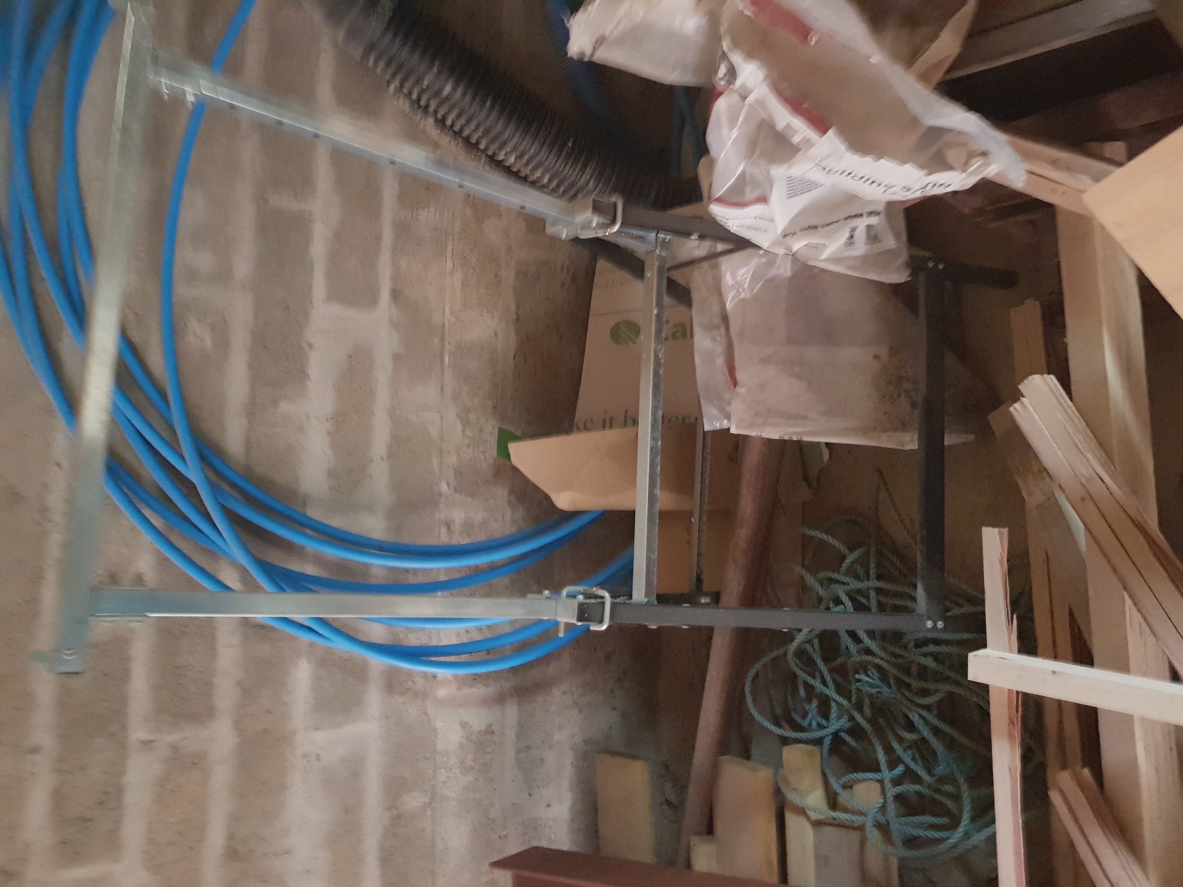

Alexphd1 Posted March 16, 2018 Share Posted March 16, 2018 @Ferdinand We bought three of these assembled one then returned two. Wasn't impressed. 1 Link to comment Share on other sites More sharing options...

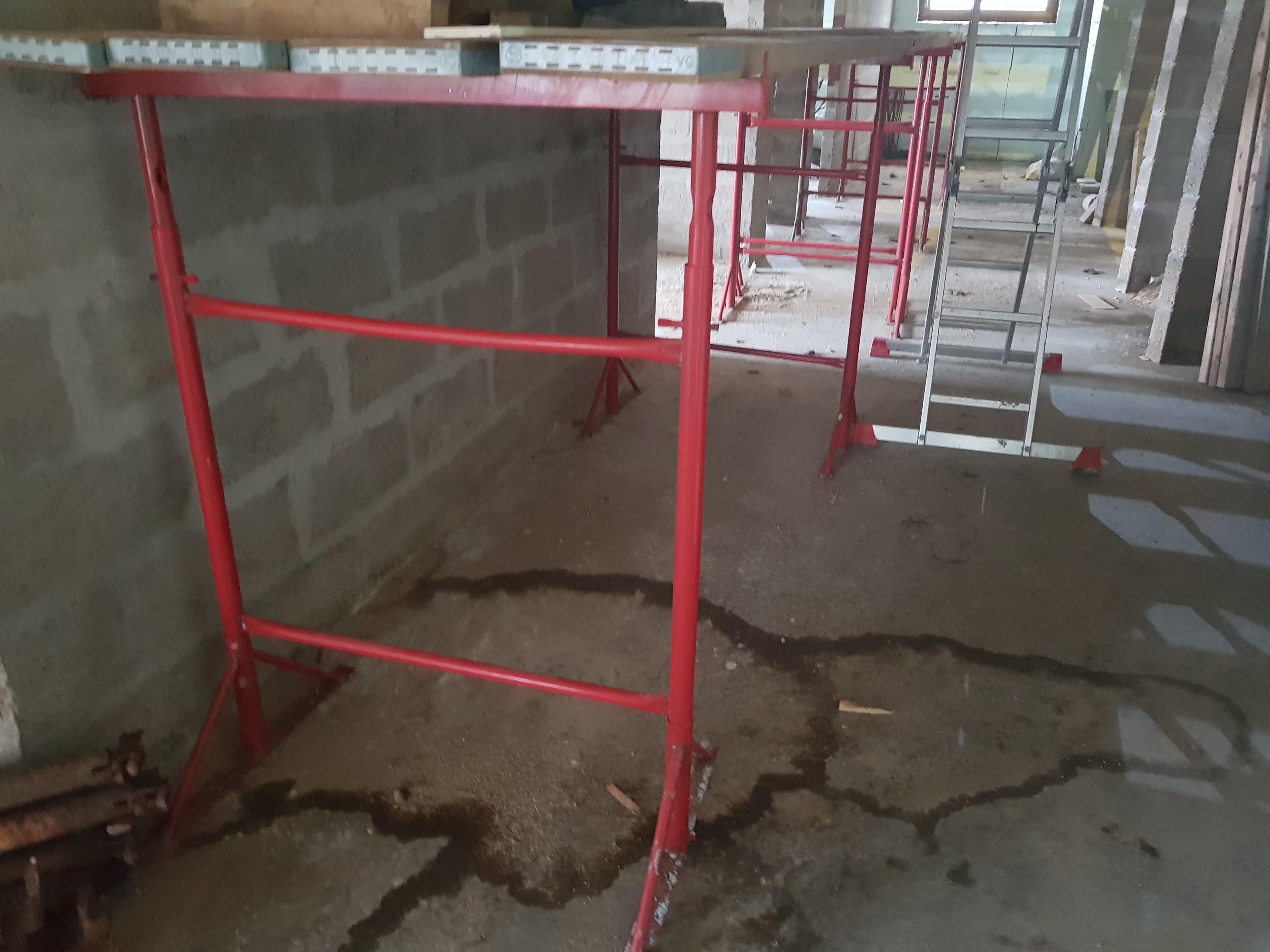

Alexphd1 Posted March 16, 2018 Share Posted March 16, 2018 Then we bought these lot more stable, robust. Cheaper but we picked up in Stafford. Link to comment Share on other sites More sharing options...
PeterW Posted March 16, 2018 Share Posted March 16, 2018 Not sure if trestles are allowed on site these days ..? Or is that a rumour ..?? I am not keen on them as they rock when they are more than 2ft high - much prefer Kwikstage as it’s more stable. Link to comment Share on other sites More sharing options...
Dudda Posted March 16, 2018 Share Posted March 16, 2018 5 minutes ago, PeterW said: Not sure if trestles are allowed on site these days ..? Or is that a rumour ..?? I am not keen on them as they rock when they are more than 2ft high - much prefer Kwikstage as it’s more stable. You can get side rails, toe rails and all sort of fancy bolt on features for trestles to make them compliant. Up to a meter the trestles are ok I think but agree anything higher they can be wobbly. The OP only wants them a meter so could be the cheaper and lighter solution. Will definitely need kiwi for the main house though. Link to comment Share on other sites More sharing options...
Alexphd1 Posted March 16, 2018 Share Posted March 16, 2018 (edited) Open trestles are not allowed on larger sites here locally, although lot of small 2 man team builders still use them. Kwik stage a far better solution esp on wheels. Edited March 16, 2018 by Alexphd1 Link to comment Share on other sites More sharing options...
Declan52 Posted March 16, 2018 Share Posted March 16, 2018 For a quick job and ease of movement around different points and the shere amount of different jobs that you can use them trestles are the winner. If they rock then the chances are not all of the legs are touching the ground maybe due to the legs being twisted. A bit of lath or a brick if they are really bad helps a lot. If you have them fully extended up you can wedge some masonry nails in the gap between the frame and the extendable bit to steady it up or tie blue rope from the top of one to the bottom of the other. Link to comment Share on other sites More sharing options...
