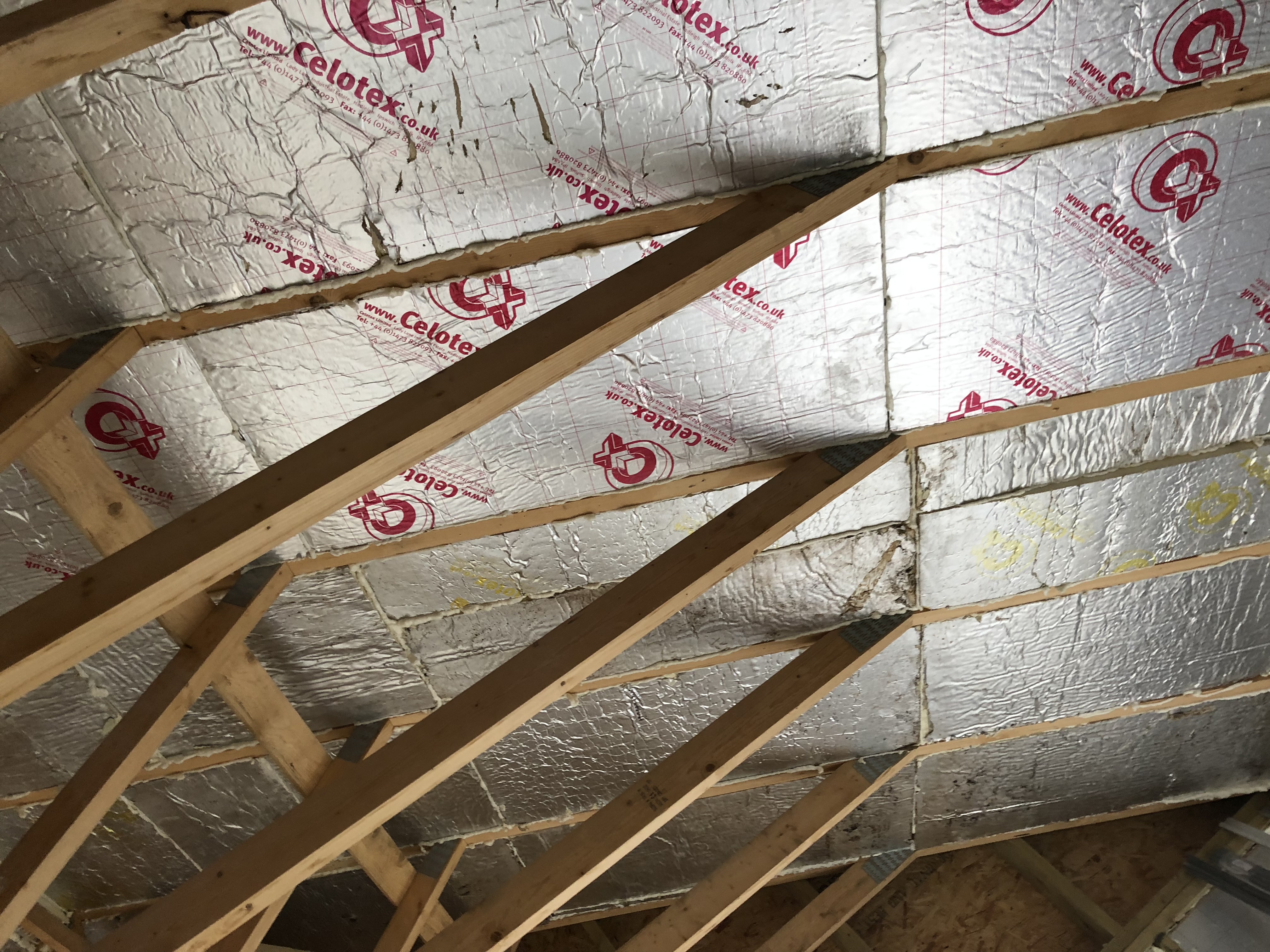

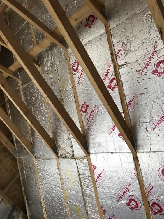

Pocster Posted March 10, 2018 Share Posted March 10, 2018 36 minutes ago, ProDave said: You should, with the correct insulation over the rafters, be able to make this a warm roof. BUT the complication you will have is all the bits of the truss sticking out into the roof space will make it very hard to seal and make the roof structure air tight. Expect to use a lot of air tightness tape sealing around every bit of the trusses structure. You mean like this ? then I’m going to put 50mm pir over the lot . Followed by aluminium foil tape on all the joints in the pir and around any protruding timber . It’s a lot of work ? Link to comment Share on other sites More sharing options...
ProDave Posted March 10, 2018 Share Posted March 10, 2018 ^^^ Yes that is the point. If you are trying to make the house truly air tight, hen there is a LOT of work sealing all that insulation and sealing around every timber that makes up the trusses. Link to comment Share on other sites More sharing options...
