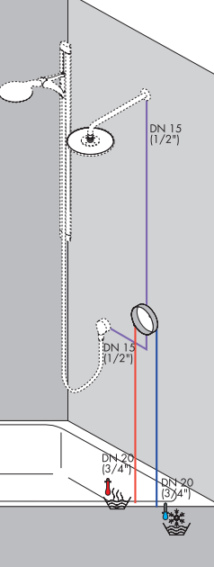

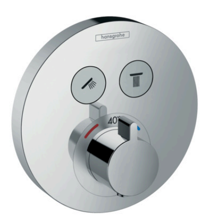

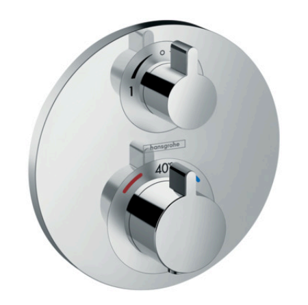

le-cerveau Posted March 7, 2018 Share Posted March 7, 2018 When you say flow, do you mean selection or variable flow rate? I ask as it makes a difference. Not cheap but the Hansgrohe range does what you want, put an ibox where you want the controls, with one output run to the overhead and the other to the output for the handshower. All this is within the wall and the controls go on top, it is fully serviceable. Then select you valve: For on off only control use a Shower Select (one and/or the other) For variable control use an Ecostat (only one at a time) Link to comment Share on other sites More sharing options...
le-cerveau Posted March 7, 2018 Share Posted March 7, 2018 Shower Select S (2 outlet) Ecostat S (2 outlet) iBox install for those valves, you can put the valve anywhere and run the purple outputs to where you want them (within reason) Link to comment Share on other sites More sharing options...

Barney12 Posted March 7, 2018 Share Posted March 7, 2018 1 hour ago, le-cerveau said: Shower Select S (2 outlet) Ecostat S (2 outlet) iBox install for those valves, you can put the valve anywhere and run the purple outputs to where you want them (within reason) The ecostat S is what I went for. Ibox install is excellent. My one criticism is that the chrome back plate is plastic!!! For a high end brand which is far from cheap that’s pretty crap imho. The joys of buying online, but they came from Megabad in Germany so I wasn’t sending them back. Link to comment Share on other sites More sharing options...
Nickfromwales Posted March 7, 2018 Share Posted March 7, 2018 My £80 3-way valve has a chrome over solid brass faceplate The plastic Grohe faceplate is a good 1/4" thick, and prob made of plastic to facilitate the click in sliding push-button receivers. The shower select 2 is a stop / start shower so again may not be everyone's cup of tea, but the valve is restricted by design, so no jetwash problems like you get with the Bristan / other sequential valves. Link to comment Share on other sites More sharing options...

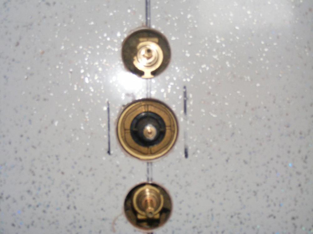

lizzie Posted March 7, 2018 Share Posted March 7, 2018 15 hours ago, Jude1234 said: 17 hours ago, lizzie said: Sounds just what I want, please can you post a photo? @Jude1234 this is mine I have tech spec if you want it......I had this in my last house too so I know it works for me. 1 1 Link to comment Share on other sites More sharing options...

Jude1234 Posted March 7, 2018 Share Posted March 7, 2018 5 hours ago, lizzie said: @Jude1234 this is mine I have tech spec if you want it......I had this in my last house too so I know it works for me. Looks really good @lizzie what makes are they and where are they from? Love your tiles as well, where are they from? Link to comment Share on other sites More sharing options...
