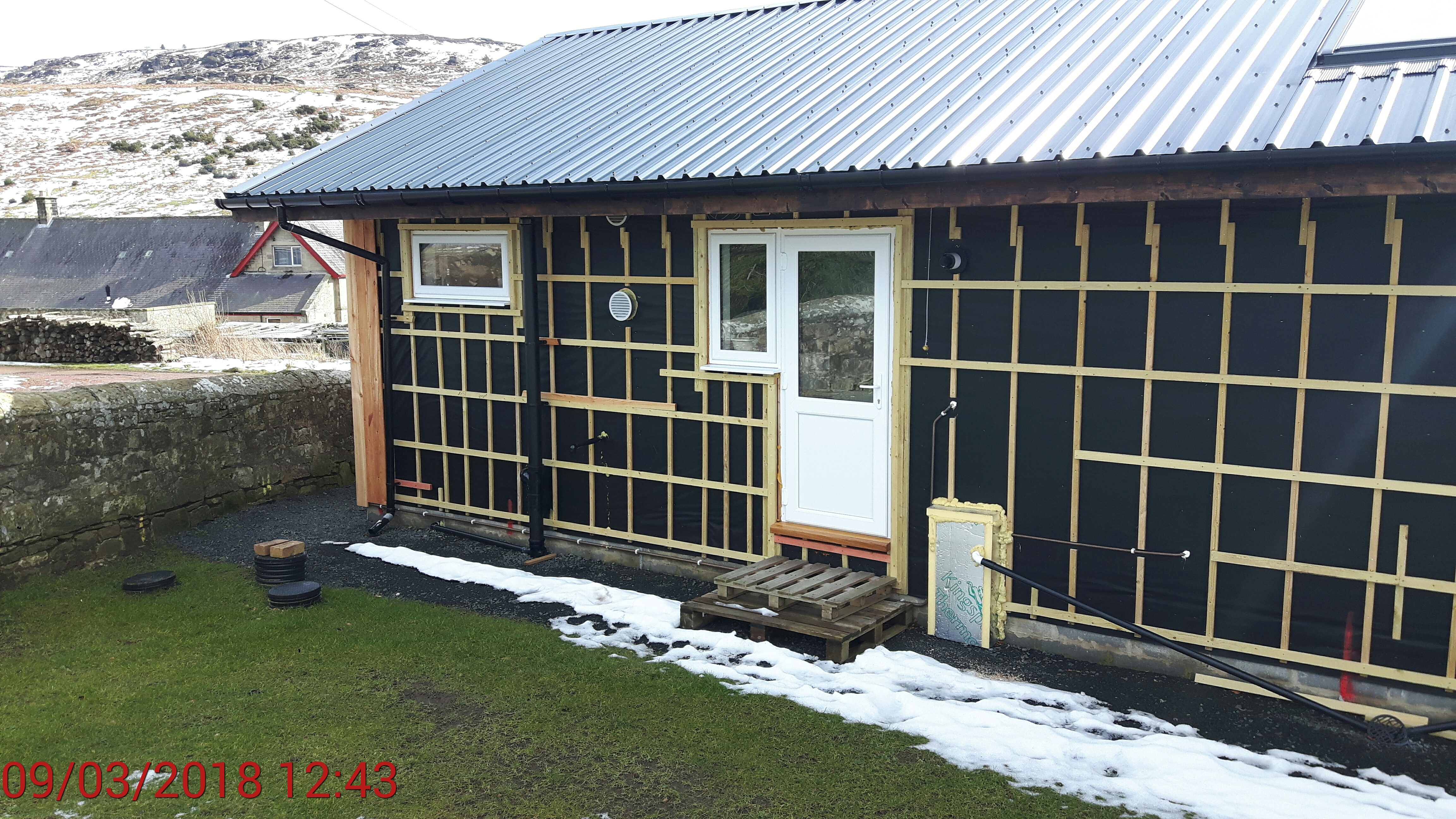

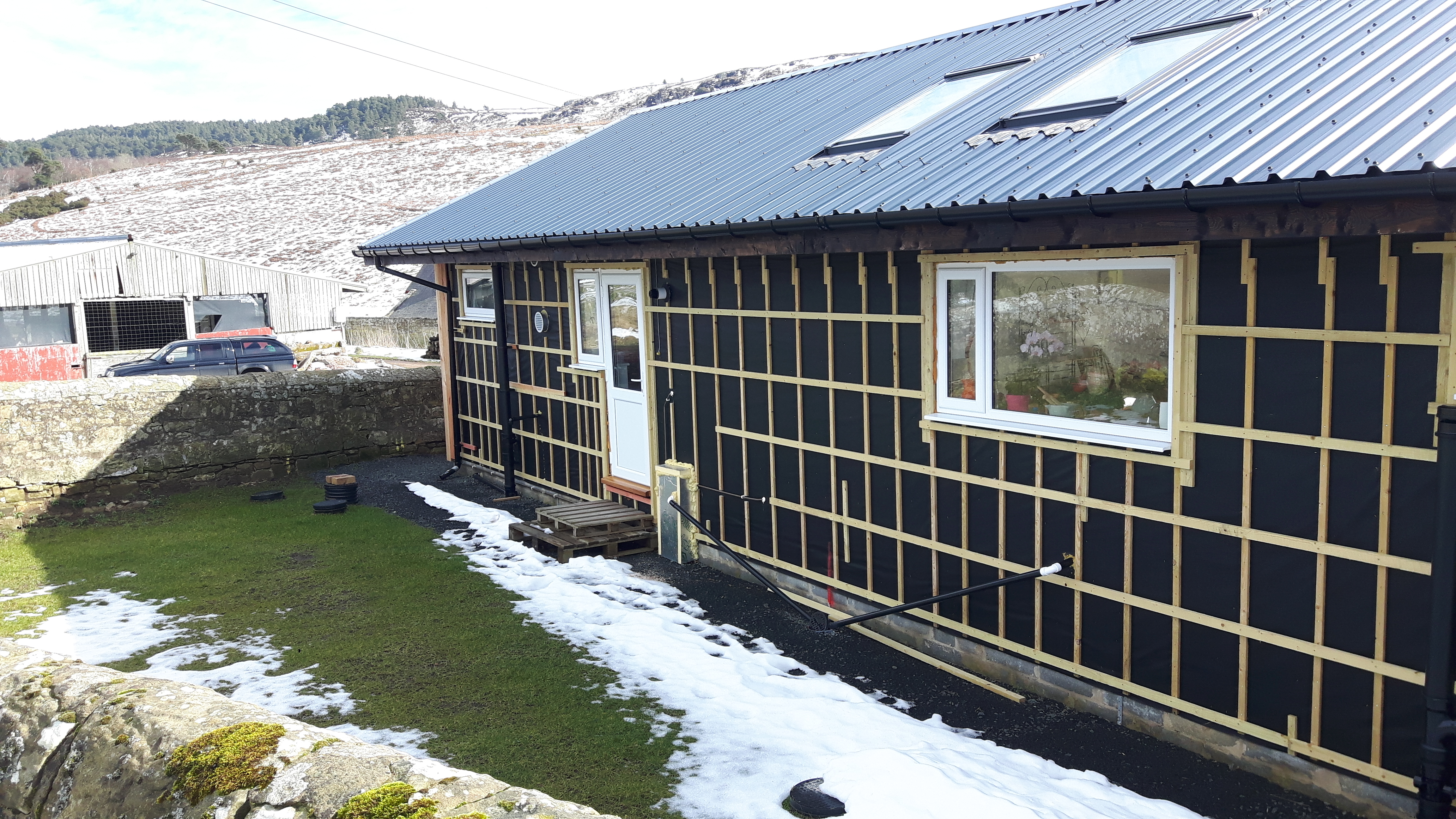

James H Posted March 9, 2018 Share Posted March 9, 2018 Sorry for delay in replying to jsharris and others. The MVHR system was designed by Green building store, in Yorkshire,they commissioned it, and I installed it. They had the posibility to put the in and out lets in other locations. I did ask them if they needed to be further apart, and they said not for my instillation. Which is for 110m2 with a PAUL Focus 200. The out side wall is not finished it still has to be clad (swan larch), the back of the building is facing North and open aspect as it is a straight wall, yes there are various pipes there none of which interfere with the ventilation. Both pipes have a fall to the outside so that any condensation will drip out side and not build up inside. There is a lot of space around the pipes and in this case I think there is no real risk of air mixing. I went for a system designed by t Green building store because: 1. I knew not much about it. 2. it had to be done right first time. 3. the price was not a problem as I have spent around £200 on the heating (one panel heater) for the whole house (which is working up to now since mid December) 4.Other company's when talked to were a little bit vague about every thing as though they only wanted the sale. 5. Having the system commissioned by a professional meant all the figures could be passed on for SAP cert. We are very happy with the system as it makes the house very agreeable to live in, our main living area 19-20c and the other rooms all above 18c most of the time. Drying cloths takes no time in the utility room and no damp or musty smells on our cloths, as we used to have in our last house (200 year old stone cottage). I will post a photo of the back of the house which I will hope makes it clearer (in another post as it will be from my phone). Link to comment Share on other sites More sharing options...
James H Posted March 11, 2018 Share Posted March 11, 2018 Link to comment Share on other sites More sharing options...
Jeremy Harris Posted March 11, 2018 Share Posted March 11, 2018 They do look very, very close together in those photos, far closer than any guidance I've ever read anywhere suggests. There's bound to be a degree of cross contamination with them arranged like that, I think, the question really is how much that may be and whether it will prove to be a nuisance at times. The worst case will probably be a still day, when the extract is dealing with smells from the kitchen (or worse) which then get partially sucked back in to the fresh air intake and distributed around the whole house. If you rarely get still days you might get away with it, but it's not really an example of good practice, and I would have thought that the designer should have known a lot better than to place them that close together. Mind you, if you're in an area where there is always a breeze it may not matter too much. Link to comment Share on other sites More sharing options...
Moira Niedzwiecka Posted March 12, 2018 Author Share Posted March 12, 2018 The recent quote I had from CVC shows the vents very close together. NIEDZWIECKA_MOIRA_MVHR+INST-RE180-AE48-REVA.pdfNIEDZWIECKA_MOIRA_MVHR+INST-RE180-AE48-REVA.pdf Link to comment Share on other sites More sharing options...
Jeremy Harris Posted March 12, 2018 Share Posted March 12, 2018 That's just ludicrously close together, the figures that @PeterStarck gave in this post are a pretty good guide: Link to comment Share on other sites More sharing options...
Moira Niedzwiecka Posted March 12, 2018 Author Share Posted March 12, 2018 @JSHarris That's what I thought. I prefer this from BPC HRVMN130717Q_MOIRA_REV04-A3_GF FF.pdfHRVMN130717Q_MOIRA_REV04-A3_GF FF.pdf Link to comment Share on other sites More sharing options...
Jeremy Harris Posted March 12, 2018 Share Posted March 12, 2018 38 minutes ago, Moira Niedzwiecka said: @JSHarris That's what I thought. I prefer this from BPC HRVMN130717Q_MOIRA_REV04-A3_GF FF.pdfHRVMN130717Q_MOIRA_REV04-A3_GF FF.pdf Definitely looks to be a better arrangement to me! Link to comment Share on other sites More sharing options...
Moira Niedzwiecka Posted March 12, 2018 Author Share Posted March 12, 2018 Thanks for the confirmation Jeremy, glad to know I am on the right lines. It conforms much more to Peter's post that was so helpful. Link to comment Share on other sites More sharing options...
