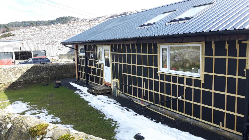

My house is 210m2. Anyone else have a similar m2 and if so what diameter of pipe did you use for the external piping. Zhender have a pipe that is pre insulated I think it is 160 internal and around 250mm external.
im also going for wood cladding. It’s open rainscreen so I need to make sure I’m weather tight coming through the membrane. What did you use here, I’m thinking an epdm grommet if they come big enough or possible just tape but I think that is always harder than a grommet.
Posted
You need to do the pressure drop calculation really. Depends on flow rate, length and number of bends in the duct. But would suspect 160mm is fine and 250mm overkill.
I just taped between membrane and duct (foam ducts)
Posted
160mm insulated is 250mm finished, external dia, as above. Not a 250mm duct ;)
