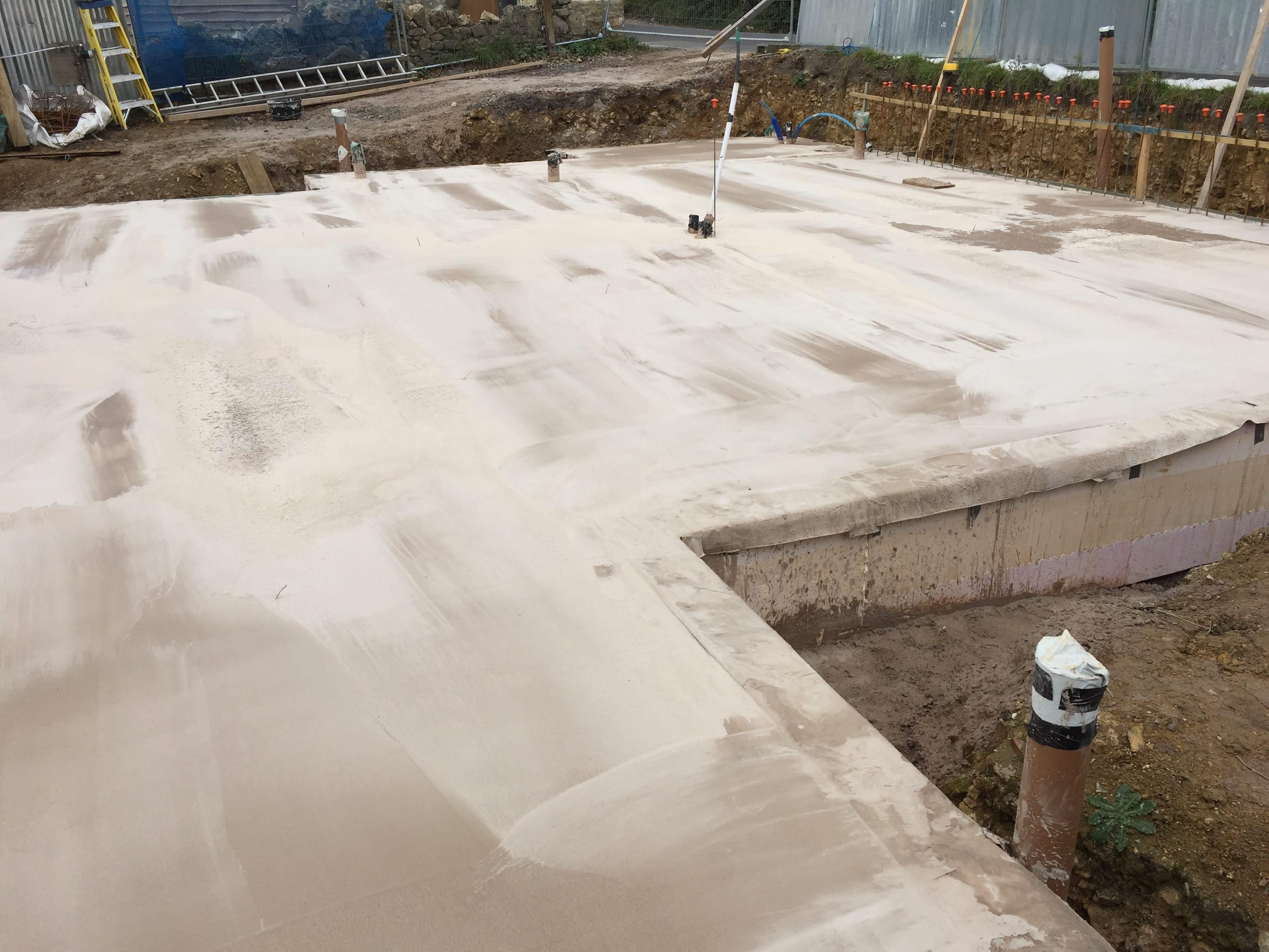

SuperJohnG Posted January 25, 2021 Posted January 25, 2021 Due to do this next week and my groundworks guy had mentioned self levelling concrete today, but I knew I had read a bad story. He was actually mentioning that to make it easier to get flat, I thought we could power float it but he seems to think that would help? I have my DPM laid under the full EPS system hence I will not have on in the formwork to help. Hence should I just stick to C25/C30 as normal (thr groundworks guy seems to think this was quite weak too...normally they always used c35) albeit...some people just go with what they know. Any input appreciated. 1
Russell griffiths Posted January 26, 2021 Posted January 26, 2021 Hasn’t this been specified by the engineer. I would go c35 more cement, creamier finish.
Gone West Posted January 26, 2021 Posted January 26, 2021 As I said earlier in the thread we had C35 power floated for our slab but now I would use self levelling concrete and not bother with power floating. 1
willbish Posted January 26, 2021 Posted January 26, 2021 What floor covering are you having @SuperJohnG? A bull float finish could be sufficient. C35 here 1 1
SuperJohnG Posted January 26, 2021 Posted January 26, 2021 9 hours ago, Russell griffiths said: Hasn’t this been specified by the engineer. I would go c35 more cement, creamier finish. Its specified as C25/C30 (not clear probably from above). What's the deal with creamier finish? Is that better? 8 hours ago, willbish said: What floor covering are you having @SuperJohnG? A bull float finish could be sufficient. C35 here I'm having LVT which is only 4mm thick with 2mm adhesive so not much to it. I do have 8mm spare if I really need it at door thresholds to do a latex screed if required but was hoping to avoid it. I've set the rebates in the slab so I can lift the sliders up after I know what the slab surface looks like. 8 hours ago, PeterStarck said: As I said earlier in the thread we had C35 power floated for our slab but now I would use self levelling concrete and not bother with power floating. Is this just for ease peter? Think its a better finish? Also can you just choose whatever grade of concrete but to be self compacting?. I was worried about it floating everything if I have self compacting but seems to be that was just because it went in the ring beams first?. I dont have a DPM in the formwork so it was coming concerning me.
willbish Posted January 26, 2021 Posted January 26, 2021 No reason why you couldn't get it right with just a bull float. Smoothing my slab with the float was the best part of the day. Rest of the team had gone home, just me and my Old man, it was strangely relaxing after the preceding mayhem and nerves. From the video you can see we just did one pass, a second pass would've taken out even more imperfections but wasn't really necessary in my case 1 1
Russell griffiths Posted January 26, 2021 Posted January 26, 2021 More cement, creamier consistency, easier to work, gives a nice fatty surface like melted ice cream. C35 minimum. As will did, no need to powerfloat really, if a slab is out of level it isn’t a miracle cure, it will remove small humps and bumps but it won’t alter poorly levelled concrete.
SuperJohnG Posted January 26, 2021 Posted January 26, 2021 3 hours ago, Russell griffiths said: More cement, creamier consistency, easier to work, gives a nice fatty surface like melted ice cream. C35 minimum. As will did, no need to powerfloat really, if a slab is out of level it isn’t a miracle cure, it will remove small humps and bumps but it won’t alter poorly levelled concrete. Thanks @Russell griffiths think I'll just go with C35 then, maybe need to think more whether to use self compacting for it. @willbish that's a great video, very helpful and looks like it was pretty chilled at the end. Weather like that would be nice!
Gone West Posted January 27, 2021 Posted January 27, 2021 14 hours ago, SuperJohnG said: Is this just for ease peter? Think its a better finish? Also can you just choose whatever grade of concrete but to be self compacting?. I was worried about it floating everything if I have self compacting but seems to be that was just because it went in the ring beams first?. I dont have a DPM in the formwork so it was coming concerning me. You have to wait for the concrete to go off and then getting a good finish with power floating is weather dependent. It started to rain towards the end of ours being power floated and so we have an area which is less smooth than the rest. It would have been easier for us if we had used self leveling concrete and a bull float.
