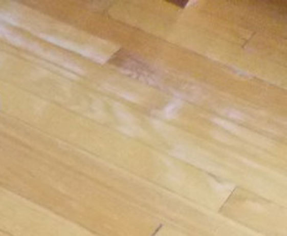

Marie Turner Posted March 2, 2018 Share Posted March 2, 2018 Hello folks, As I've recently said I'm really impressed by the comprehensive answers to other topics in the forum. This is the reason why I'm sure someone of you will have the knowledge to help me. My problem: The oak wood floor in my bedroom is suffering from some kind of hazy buildup. I'm not sure what exactly caused this but it looks very much like a cloud. I think that a service like a floor sanding can solve this problem but I don’t have such budget at the moment. So I'm wondering if any of you can share experience in dealing with such problem. I've found a possible solution online (with ammonia) on this website but I'm not sure if this is the right thing to do in my case. I would appreciate if someone says if it's adequate option, because I don’t want to do more damage to the surface Thanks in advance. Link to comment Share on other sites More sharing options...

Marie Turner Posted March 2, 2018 Author Share Posted March 2, 2018 (edited) On this photo, it looks like outworn, but that's the best quality I can provide with my camera. From other angles, it's barely noticeable. Edited March 2, 2018 by Marie Turner Link to comment Share on other sites More sharing options...
lizzie Posted March 2, 2018 Share Posted March 2, 2018 Is your wood sealed? Is it solid or engineered oak? Link to comment Share on other sites More sharing options...
Marie Turner Posted March 2, 2018 Author Share Posted March 2, 2018 I'm almost sure it's solid, it has been here already long before us, to be honest. We've got it sealed with lacquer few years ago. Link to comment Share on other sites More sharing options...
Russell griffiths Posted March 2, 2018 Share Posted March 2, 2018 Will you try something just to humour me? use your hairdryer gently and warm up an area, just see if it goes away. We get clouding under lacquer on a different material and it is normally moisture. Link to comment Share on other sites More sharing options...

Marie Turner Posted March 2, 2018 Author Share Posted March 2, 2018 Nope, it didn't worked out It would've been great to find such a fast and easy solution (definitely worth trying) . 1 Link to comment Share on other sites More sharing options...
lizzie Posted March 2, 2018 Share Posted March 2, 2018 What do you use to clean it? Link to comment Share on other sites More sharing options...
Marie Turner Posted March 2, 2018 Author Share Posted March 2, 2018 A cleaner designed for wood with neutral pH it should not be the problem. Link to comment Share on other sites More sharing options...
lizzie Posted March 2, 2018 Share Posted March 2, 2018 Ok. I too always used specialist cleaners on my engineered oak. I had a problem appear in one area with clouding - eventually it turned out that my cleaning lady had been leaving mops standing on the floor and moisture had penetrated and got under the lacquer finish. She had also been using the steam mop on it without my knowledge. On advice I got a special product that stripped off all residue and took it right back to the base lacquer that cleared the clouding and I refinished the floor. I did not sand it. If you have a flooring company that supplies wood floors near to you then I would go and see them and ask them for help. You need to be careful not to make it worse. 1 Link to comment Share on other sites More sharing options...

Russell griffiths Posted March 2, 2018 Share Posted March 2, 2018 28 minutes ago, lizzie said: Ok. I too always used specialist cleaners on my engineered oak. I had a problem appear in one area with clouding - eventually it turned out that my cleaning lady had been leaving mops standing on the floor and moisture had penetrated and got under the lacquer finish. She had also been using the steam mop on it without my knowledge. On advice I got a special product that stripped off all residue and took it right back to the base lacquer that cleared the clouding and I refinished the floor. I did not sand it. If you have a flooring company that supplies wood floors near to you then I would go and see them and ask them for help. You need to be careful not to make it worse. This is the problem we get, that’s why I thought the hairdryer might work. Ho hum. Think again. 1 Link to comment Share on other sites More sharing options...
Triassic Posted March 2, 2018 Share Posted March 2, 2018 Try a fan heater blowing warm air, it should get rid of the blooming in the varnish. Link to comment Share on other sites More sharing options...
