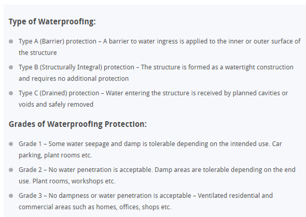

Triassic Posted February 27, 2018 Share Posted February 27, 2018 I’m just about to start construction of my basement, it’s basically an open fronted box set into a hillside. After much peckering and the removal of 1500 tonnes of limestone we have a flat space for the insulated slab, onto which will sit ICF (insulated concrete form) basement walls. As three different people have been involved in the basement design, architect, Structural Engineer and ICF supplier, I have three different waterproofing membranes (three different manufacturers) mentioned on the various drawings. Can anyone recommend an easy to use membrane suitable for sticking to the polystyrene ICF? In addition, I also need a protection sheet to protect the wall insulation and the waterproof membrane, Corex has been mentioned. Is it easy to fix? Link to comment Share on other sites More sharing options...

Mr Punter Posted March 1, 2018 Share Posted March 1, 2018 You can build a blockwork skin on the house side of the ICF. This would give you the required cavity. You will, in any case, need to finish the inside with something. You could do a bit like the second diagram, but with drainage under the slab instead of a sump / pump. Link to comment Share on other sites More sharing options...
le-cerveau Posted March 1, 2018 Share Posted March 1, 2018 18 minutes ago, Mr Punter said: You can build a blockwork skin on the house side of the ICF. This would give you the required cavity. You will, in any case, need to finish the inside with something. You could do a bit like the second diagram, but with drainage under the slab instead of a sump / pump. Is not the whole point of an ICF basement to eliminate thermal bridging and provide an insulated shell, by opting for a Type C you are introducing thermal bridges and allowing water inside to then pump out. Surely you want to opt for a Type A (Barrier Protection) and provide drainage externally to the basement! Link to comment Share on other sites More sharing options...
Triassic Posted March 1, 2018 Author Share Posted March 1, 2018 My design calls for a type1 waterproofing system, hence the question about which membrane is bst for ICF. So far the architect, the SE and the ICF supplier have each made suggestions, on doing a bit of research two out of the three aren’t suitable for ICF due to the adhesives used. Link to comment Share on other sites More sharing options...
le-cerveau Posted March 1, 2018 Share Posted March 1, 2018 12 minutes ago, Triassic said: My design calls for a type1 waterproofing system Do you mean Grade 1? I would have thought it should be Grade 3, or at least 2. If you have a Grade 1 system then you will need a Type C to deal with the seepage! Link to comment Share on other sites More sharing options...
mvincentd Posted March 1, 2018 Share Posted March 1, 2018 2 hours ago, Triassic said: Its solid limestone rock. So i'd imagine your geo survey states your excavations can sit near vertical in the temporary state....meaning you only have to over-dig a metre to create space that can be made viably safe to work in. I was on chalk and lined the vertical excavation with hessian under chicken wire which proved effective at containing the small surface crumblings and gave a (possibly faux) sense of confidence to the concrete contractors such that the boss was happy to take the job.....his workers were more circumspect but reading between their lines I think they never feel theres enough safety in place for them and it's more common than not that they find themselves woking in compromised positions. Its a balance of viable risk and viable economics. Even if you plan on actually doing the work yourself, get a tanking co' to quote.....if they're saying yeah we'll get in there and do that, then you can probably consider it a viable risk for yourself to do. I had a visit from HSE shortly after we'd backfilled. He intimated that he'd not have liked what he'd seen had he visited at an earlier stage.....that could have been properly expensive for me. I'm not trying to divert you from the main question of what membrane technology you'd prefer....just saying you should consider its real life constructibility in your specific site. Maybe you have the space to batter back your excavations 45 degrees and the money to muck away that extra 700 tonnes, and then backfill it later. Link to comment Share on other sites More sharing options...
Triassic Posted March 1, 2018 Author Share Posted March 1, 2018 (edited) 34 minutes ago, le-cerveau said: Do you mean Grade 1? I meant Type A Grade 3. i’d just received a phone call cancelling the delivery of the MOT type1 as I was typing my last post. Can’t multi task, The rock face is solid, no need to batter back. Edited March 1, 2018 by Triassic Link to comment Share on other sites More sharing options...
