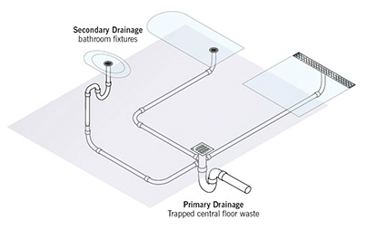

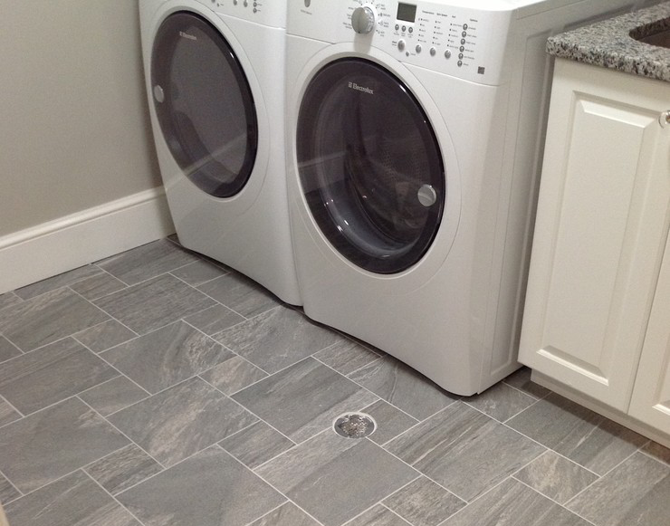

Russell griffiths Posted February 21, 2018 Posted February 21, 2018 May find this hard to explain as it’s not something I’ve ever seen in a house in England When we lived in oz and built our last place all the rooms with any wet area had a central floor drain, when I first lived over there I thought it was a silly idea but after having a couple of houses and building our last one I really liked the idea. so has anybody installed floor drains in their wet areas and has anybody got thoughts on how to achieve this using the uk spec drainage pipe. Will try to find a pic.

Russell griffiths Posted February 21, 2018 Author Posted February 21, 2018 Basically it’s very similar looking to a wet room or shower drain but a bit different, from the top it looks identical, its the bits below the floor that are different the ozzy, American version has a large trap built into it to prevent smells coming back up into the room. Ar ha you say thats the same as all the normal ones, the difference is a central floor drain will not have any water down it as it doesn’t function until there is a flood, so what happens is the trap dries out and smells come in, so what Jonny foreigner has done is install a connection on the side of the floor drain so another waste water outlet passes through it every time it is used, say the sink the water from the sink passes through the central floor drain and flushes the trap and fills it with new water keeping the smells out.
ProDave Posted February 21, 2018 Posted February 21, 2018 This sounds like a prime candidate for the hepvo waterless trap (which has another local nickname) Don't go getting Aussie ideas and put your WM in the bathroom next to the shower, complete with a handy socket for the hairdryer. You know us Brits are too stupid and we would all kill ourselves if we were allowed to do that, unlike our more sensible friends down under.

Russell griffiths Posted February 21, 2018 Author Posted February 21, 2018 This is how it’s fitted up.
