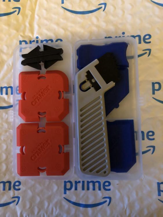

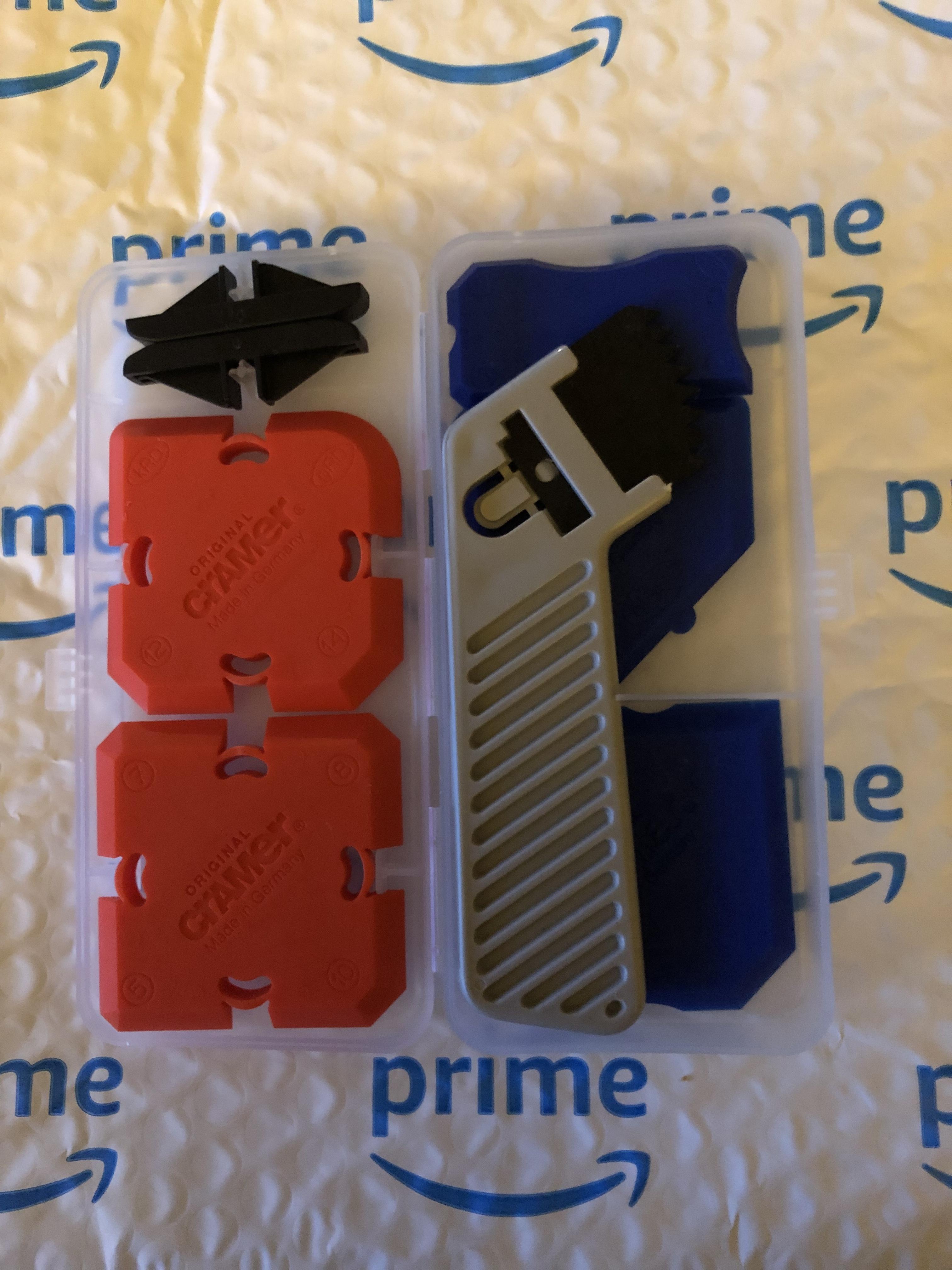

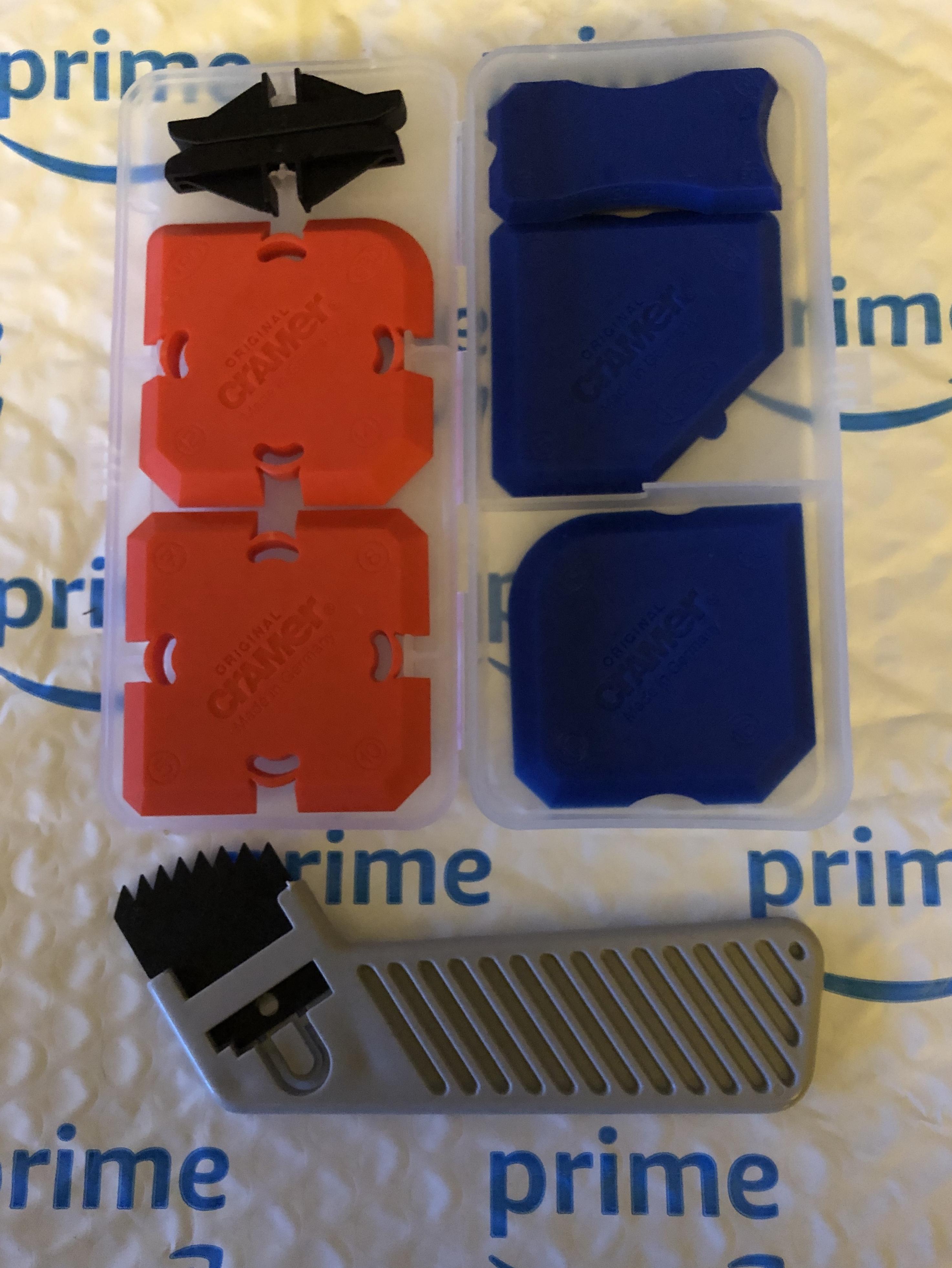

newhome Posted February 15, 2019 Share Posted February 15, 2019 My kit arrived and came with these instructions. Doesn’t say Fugi anywhere in the instructions but it says ‘Cramer Fugi’ in the description on Amazon so I hope it’s the same thing. Link to comment Share on other sites More sharing options...
Onoff Posted February 15, 2019 Author Share Posted February 15, 2019 11 minutes ago, newhome said: My kit arrived and came with these instructions. Doesn’t say Fugi anywhere in the instructions but it says ‘Cramer Fugi’ in the description on Amazon so I hope it’s the same thing. It's the same one as mine. 2 Link to comment Share on other sites More sharing options...
