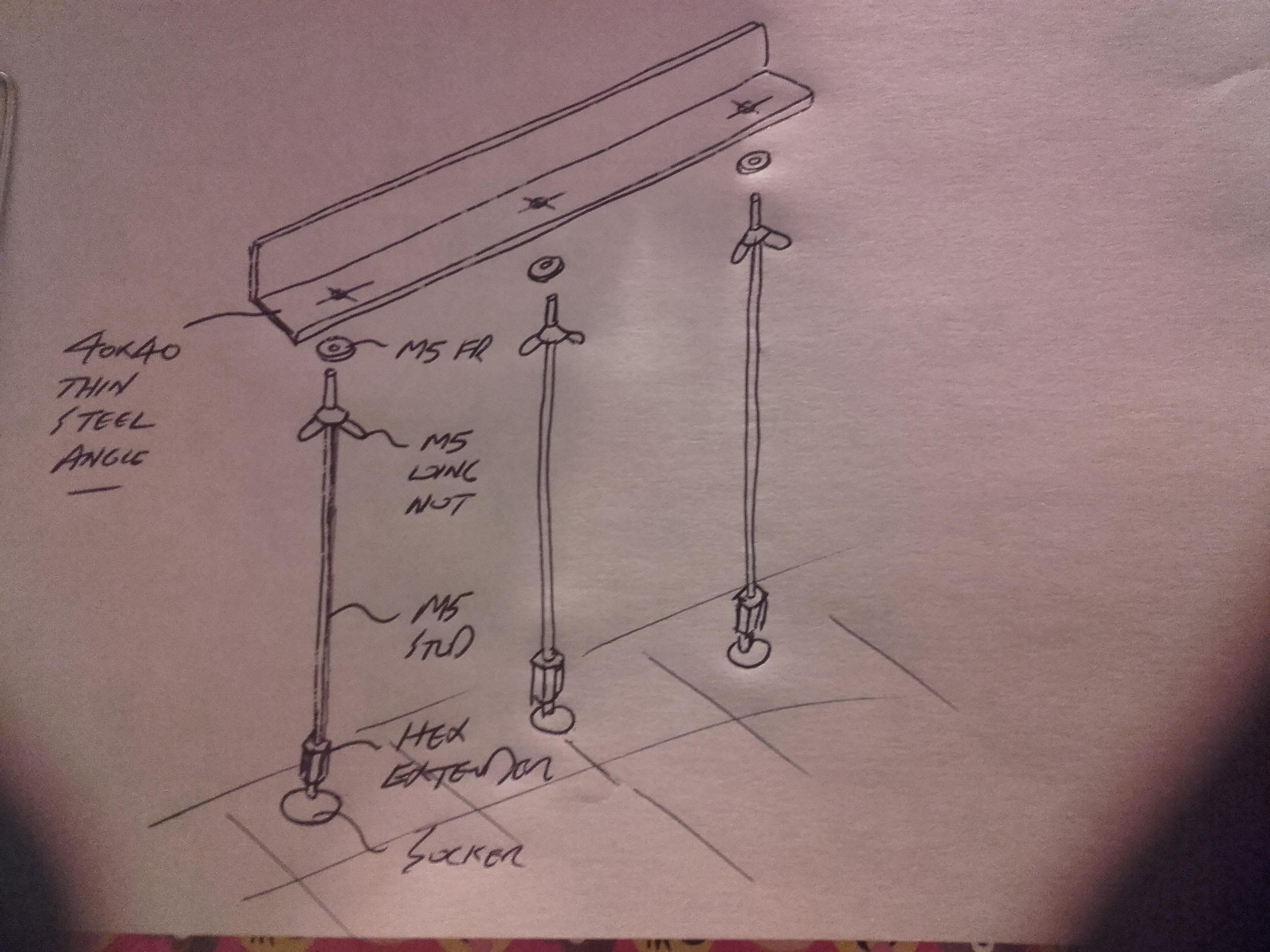

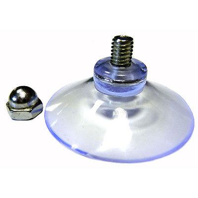

Onoff Posted August 14, 2018 Author Posted August 14, 2018 8 hours ago, Onoff said: This is where we're heading: I was thinking pop rivets, maybe two lines and quite well spaced out, in the face of the angle where it sits against the wall. This to provide some clearance and hopefully allow only minimal contact against the wall. But is that enough? With a 6mm bed & 8mm tile then that angle wants to be nom 10mm off the wall. So now I'm veering towards rivnuts in the angle and some wind in/out screws to set the distance off the wall. Maybe pan head machine screws? Other "worry" is how much the floor suckers will compress under the weight... Watch this space!
dpmiller Posted August 14, 2018 Posted August 14, 2018 put a screw up through the middle of each sucker instead of the bonded-in stud and that'll give a hard stop?

Tennentslager Posted August 14, 2018 Posted August 14, 2018 What about this... thinking ahead for the tool loan scheme ? Why do you need the upstand under the tile? Might it get stuck...or as you mentioned, stick to the tanking. No upstand equals less contact with the wall?
Onoff Posted August 14, 2018 Author Posted August 14, 2018 6 minutes ago, Tennentslager said: What about this... thinking ahead for the tool loan scheme ? Why do you need the upstand under the tile? Might it get stuck...or as you mentioned, stick to the tanking. No upstand equals less contact with the wall? I did think of adapting a spirit level but it won't achieve the same accuracy as the laser. Plan is only the very edge of the angle will support the bottom of the tile.

Nickfromwales Posted August 14, 2018 Posted August 14, 2018 7 hours ago, Onoff said: I was thinking pop rivets, maybe two lines and quite well spaced out, in the face of the angle where it sits against the wall. This to provide some clearance and hopefully allow only minimal contact against the wall. But is that enough? With a 6mm bed & 8mm tile then that angle wants to be nom 10mm off the wall. So now I'm veering towards rivnuts in the angle and some wind in/out screws to set the distance off the wall. Maybe pan head machine screws? Other "worry" is how much the floor suckers will compress under the weight... Watch this space! How about a piece of PB like I said? By now I'd have had 3 walls 4 courses up !!!!!! 1
Onoff Posted August 14, 2018 Author Posted August 14, 2018 4 hours ago, Nickfromwales said: How about a piece of PB like I said? By now I'd have had 3 walls 4 courses up !!!!!! And with the time saved I could spend quality time with SWMBO! You know talk about how she's feeling, is anything wrong, what she bought shopping, our collective elderly parents etc. Thanks for reminding me I need to get some M5 studding! 2

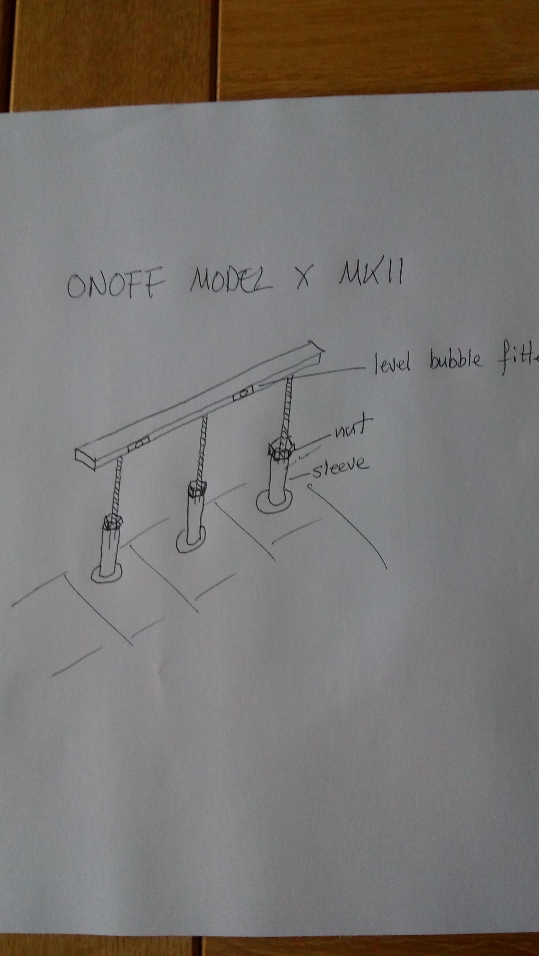

Onoff Posted August 15, 2018 Author Posted August 15, 2018 T'station messed up with the M5 studding! It's being delivered tomorrow now. Anxious to get on with this I've a new plan. I'm ditching M5 and have a new plan involving CT1 and these: Hopefully get the bones of it lashed together this evening!
Onoff Posted August 15, 2018 Author Posted August 15, 2018 Free angle, free nuts & washers! A bit of chopping later, you can just see the rivnuts. Kissed it with the wire brush to derust: A 1.8m one, a random one a bit shorter and a nom 400mm one. And a coat of zinc rich as I couldn't be ar$ed waiting for etch to dry: Amazed I got this far without a) A drink and 2) The boredom fairy showing up! Must crack on, off to dig out bolts, more later!
