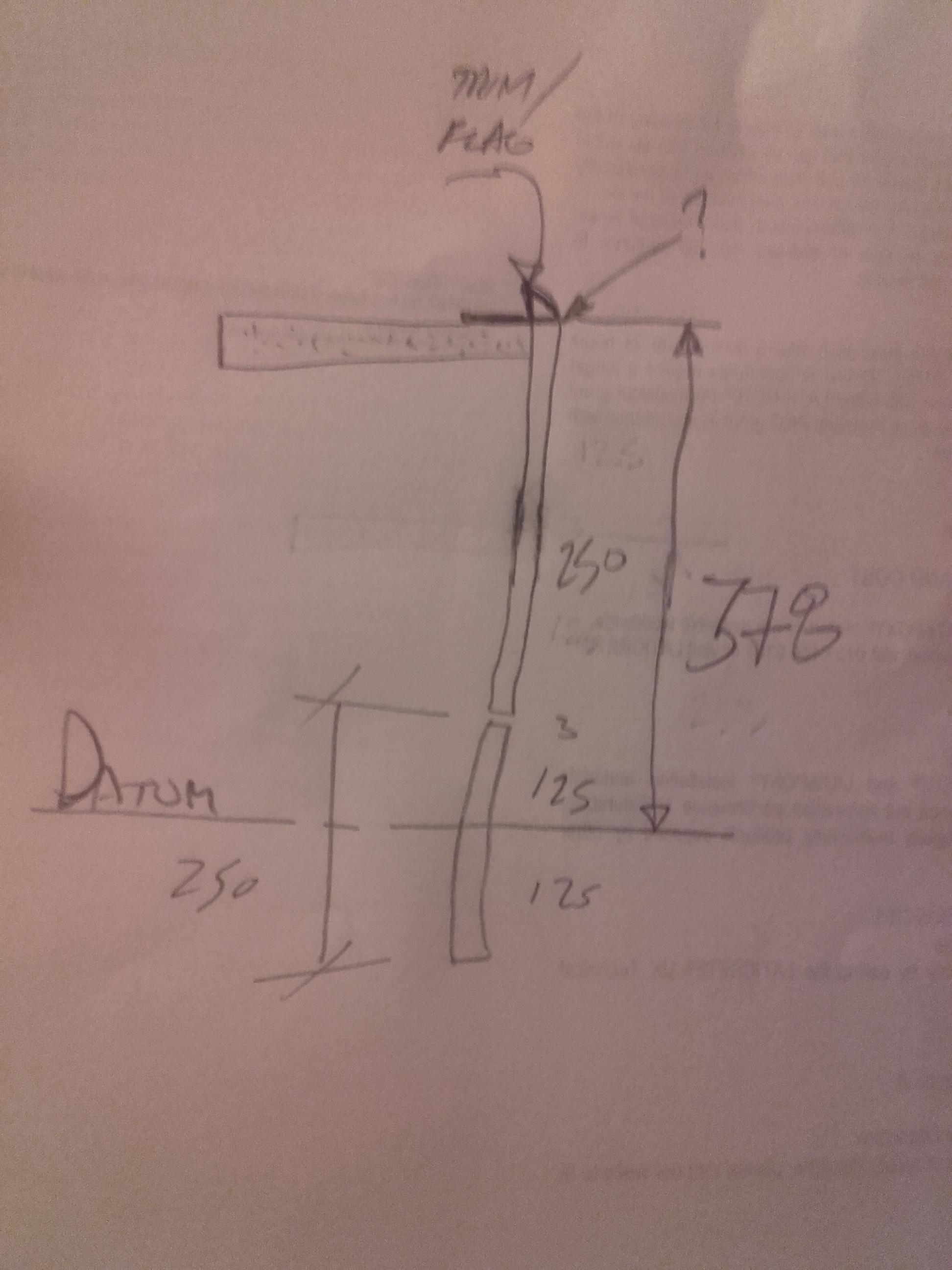

Onoff Posted August 9, 2018 Author Share Posted August 9, 2018 @Nickfromwales, excuse the proper fag packet sketch! I'd wrongly maybe, envisaged not having a 3mm grout line between the top of the tile and trim around the pockets, "?" on the sketch. It was deliberate, I just think it looks better. Would clear CT1 do at that interface? Ta. Link to comment Share on other sites More sharing options...
Nickfromwales Posted August 9, 2018 Share Posted August 9, 2018 No need for CT1, just washing the grout off willl do the job. You grout as normal packing every little nook and cranny, and then when sponging off you just rub it into the gap between the trim and the tile. Youll see as you grout that it's all you need. Just make sure the 3 degree benched tile is slightly proud of the top of the trim and set back away by about 1mm so you can get grout into the void of the trim / tile and you'll be fine. 1 Link to comment Share on other sites More sharing options...
