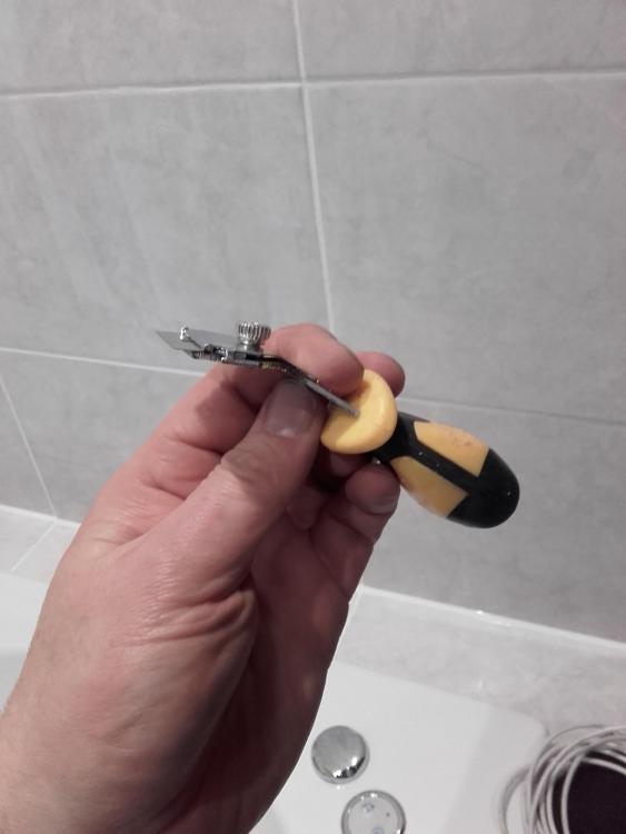

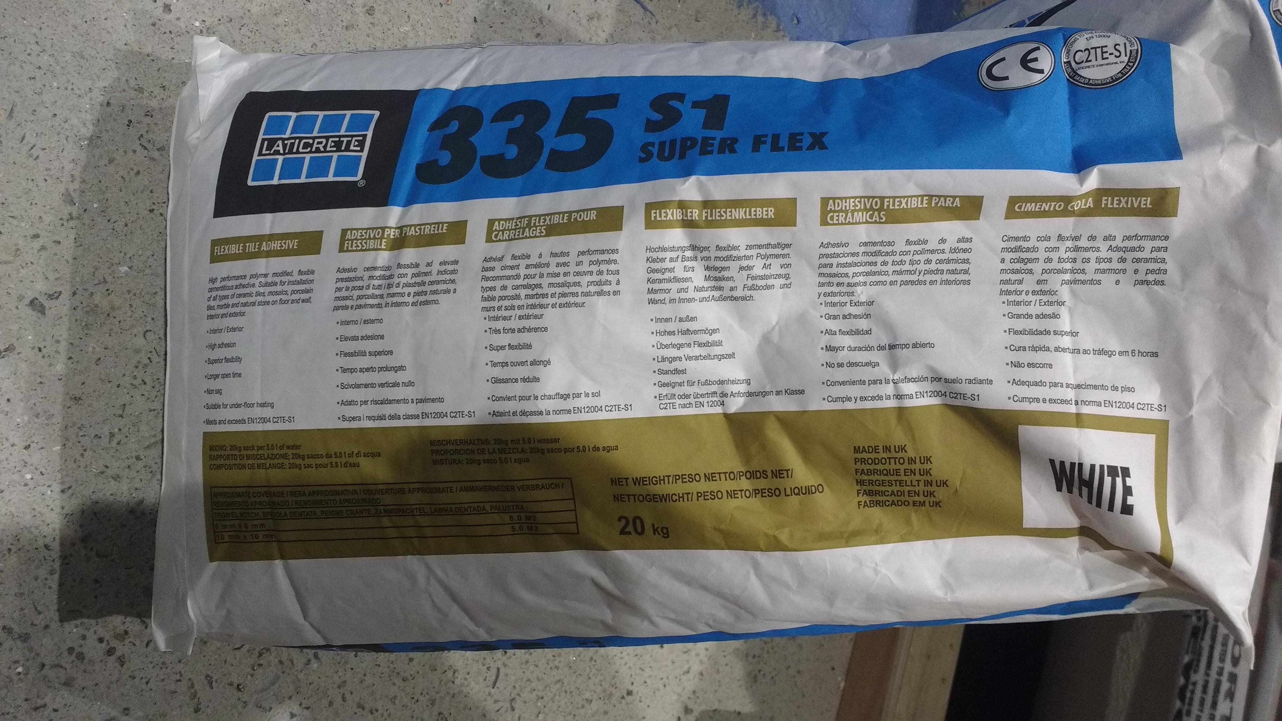

Onoff Posted August 7, 2018 Author Posted August 7, 2018 I'm getting there I think. Looked this morning at the bit I did last night and happy enough. Interesting how a tap on the setting tiles last night rang a little "hollow" but this morning they seem rock solid. Like the adhesive has sucked them down or something? One bit tonight then out the door Weds night hopefully. GROUT Grouting Thursday night so what do I need? I have buckets & sponges. Think I've a grout float in the shed though God knows where it came from or how old it is. Must have been from my last foray 30 years ago! I've been looking at it for years trying to figure what it is, photo later. Any tools, rubber spreaders etc that'll make this easier? I have time to get anything. Mop head. Came across an abandoned, dusty, traditional mop head. If I can sneak it through the washing machine I wonder if it'll be of any use? WALLS Probably popping to the tile place later this afternoon. Figuring to get another primer and a couple or 4 bags of adhesive and maybe one grout. The Laticrete 335 is seemingly OK for the walls. Not sure if I trust their data sheets tbh, coverage seems more like half that stated. Maybe it's if you don't back butter is the figures they're giving? Whereas previous stuff I read termed a large format tile as >300x300 I came across this on their site: "Back butter large tile >200 mm x 200 mm to provide full bedding and firm support if required". My wall tiles are 400x250 and will be laid horizontally. The 335 has a 30 minute open time. Loads of questions keep popping into my head! I presume to start "one tile up" or maybe even just under the pockets to ensure they look spot on then cut the bottom tile against the floor... Got a 6mm and 10mm trowel, which is better? How many rows can I lay without it slipping? Drilling big holes in them...for pan inlet/outlet... Sorry Nick, it ain't over yet!
