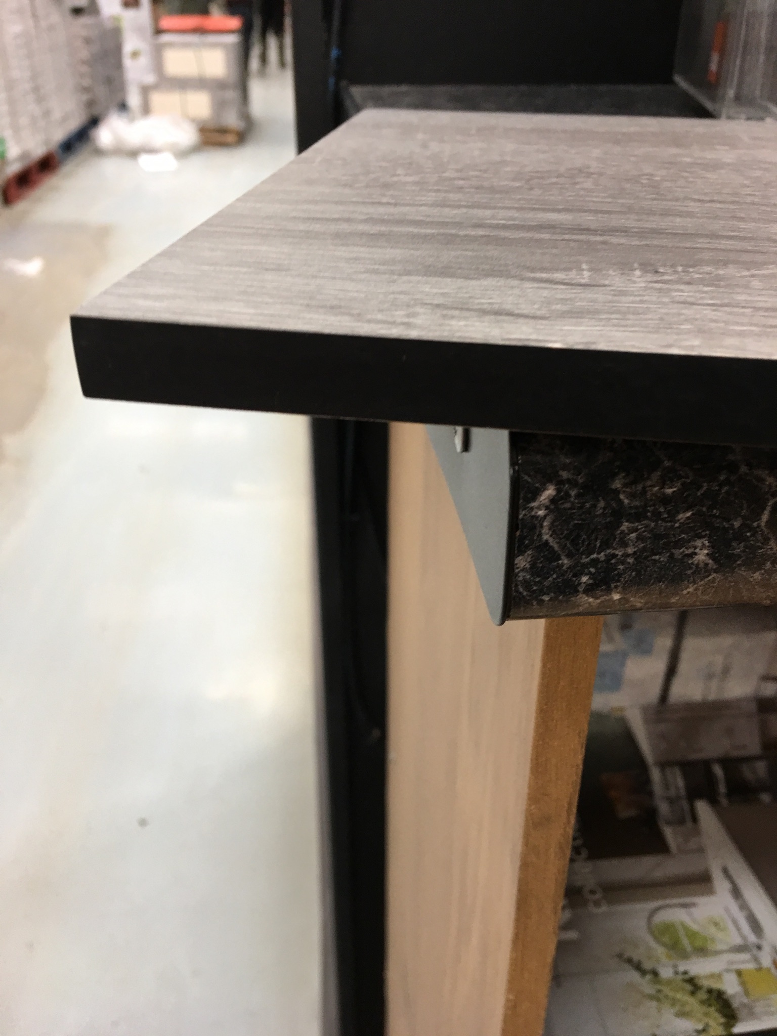

Nickfromwales Posted February 8, 2018 Share Posted February 8, 2018 1 hour ago, lizzie said: I have splashed out on my beautiful kitchen with honed granite and now I need to save a few bob doing the utility so Howdens units but not having had a laminate worktop in more than 20 years (and dont have fond memories) I have been looking around at whats available. I have seen the Wilson art Zenith 12.5mm (b&q, wickes, magnet etc), looks good and sounds just the thing 100% waterproof etc. Good prices on line too. Anyone any experience of these? link The 20mm worktops are bloody flimsy imo ( laminate over chipboard ). Just fitted my mates as a favour and not great for the 960mm brekky bar tbh. Ok if supported by units but a bridge to far if unsupported imo. Had to bond 5mm SS plates to the underside with Sikaflex to beef the brekky bar up. A PITA. Looked nice though. My only concern with the 12,5mm stuff is how do you do the joints in the corners? Link to comment Share on other sites More sharing options...

ryder72 Posted February 8, 2018 Share Posted February 8, 2018 Solid laminate at 10/12mm will be OK but anything with a chipboard core I am not sure can be left unsupported over 60cm Neither of these are cheap (in comparison to 38mm laminate tops) so you may as well ask at your local granite yard. They will very likely have a 3m offcut of something 20mm that they can let you have if you are prepared to provide the template and fit it yourself. 1 Link to comment Share on other sites More sharing options...

lizzie Posted February 9, 2018 Author Share Posted February 9, 2018 This is the stuff I have been looking at - this one is in B&Q Link to comment Share on other sites More sharing options...
