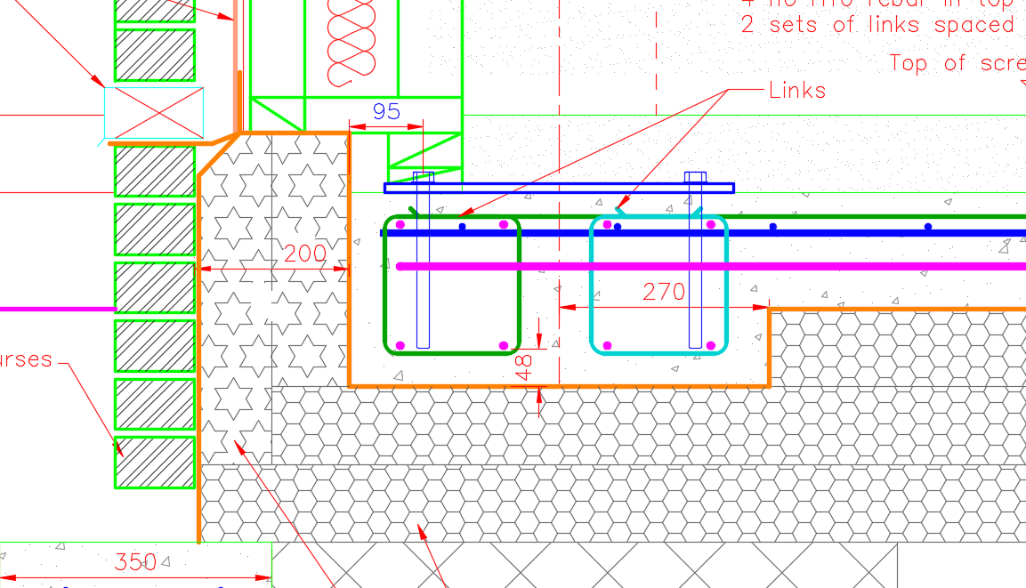

If you put up a drawing showing the cross section and location, then we can maybe advise on the method.

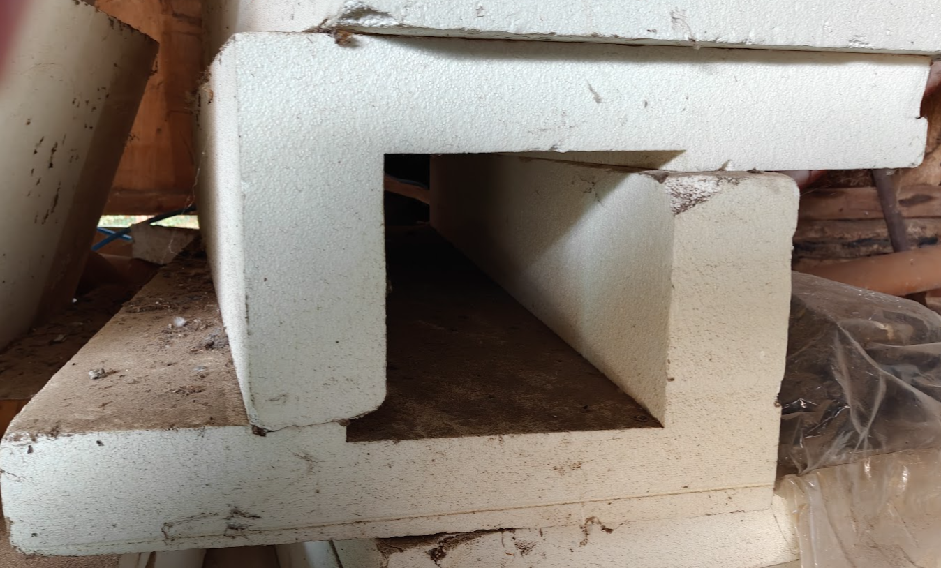

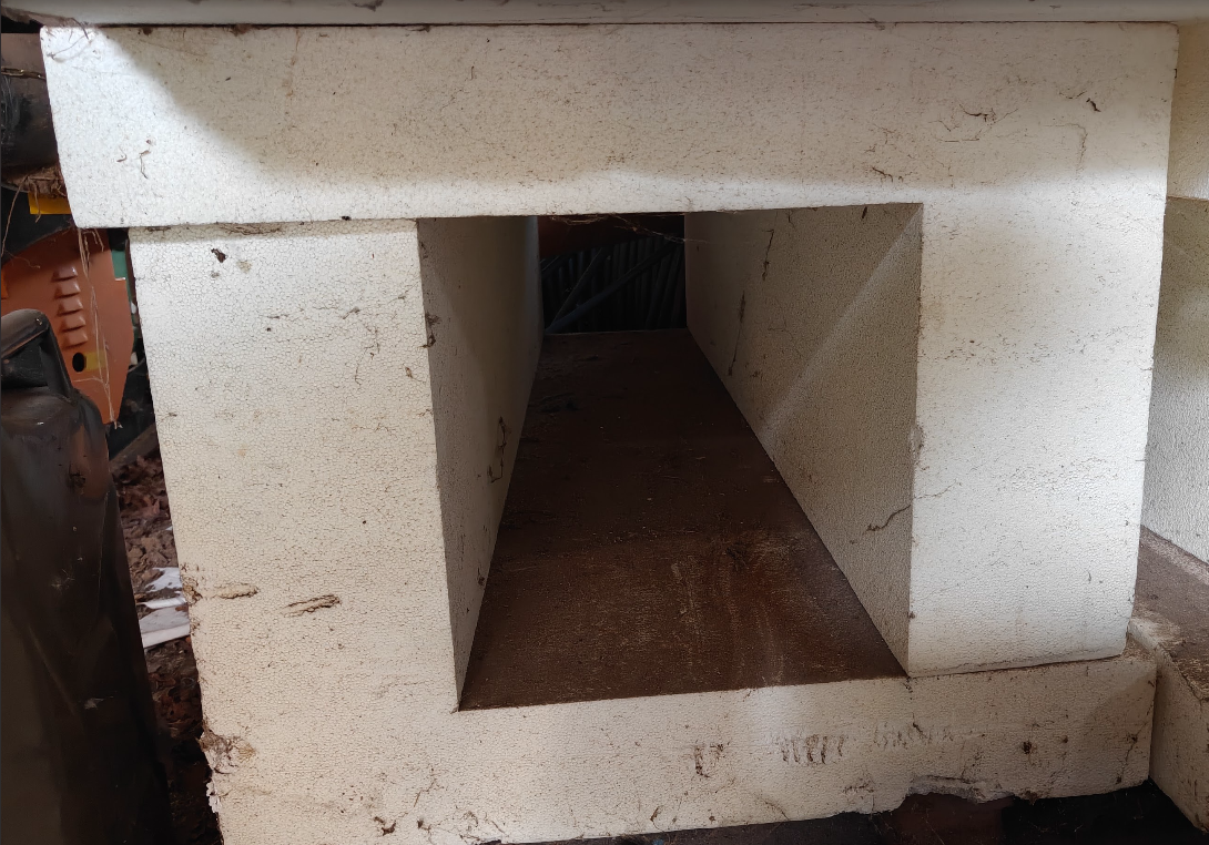

I ended up with some left over, but believe they are EPS200. If the form is correct I can check the spec. I had two different profiles:
and
The two different profiles were used on mine to create and integral ring beam, and then a seperate outer ring beam.
If either appear to be a similar shape to what you need, let me know the dimensions and I will check and confirm the EPS Spec.

Post the AFD detail you have and let us all have a look. My gut feeling is that there is a simple and justifiable fix available to you without any drama.
