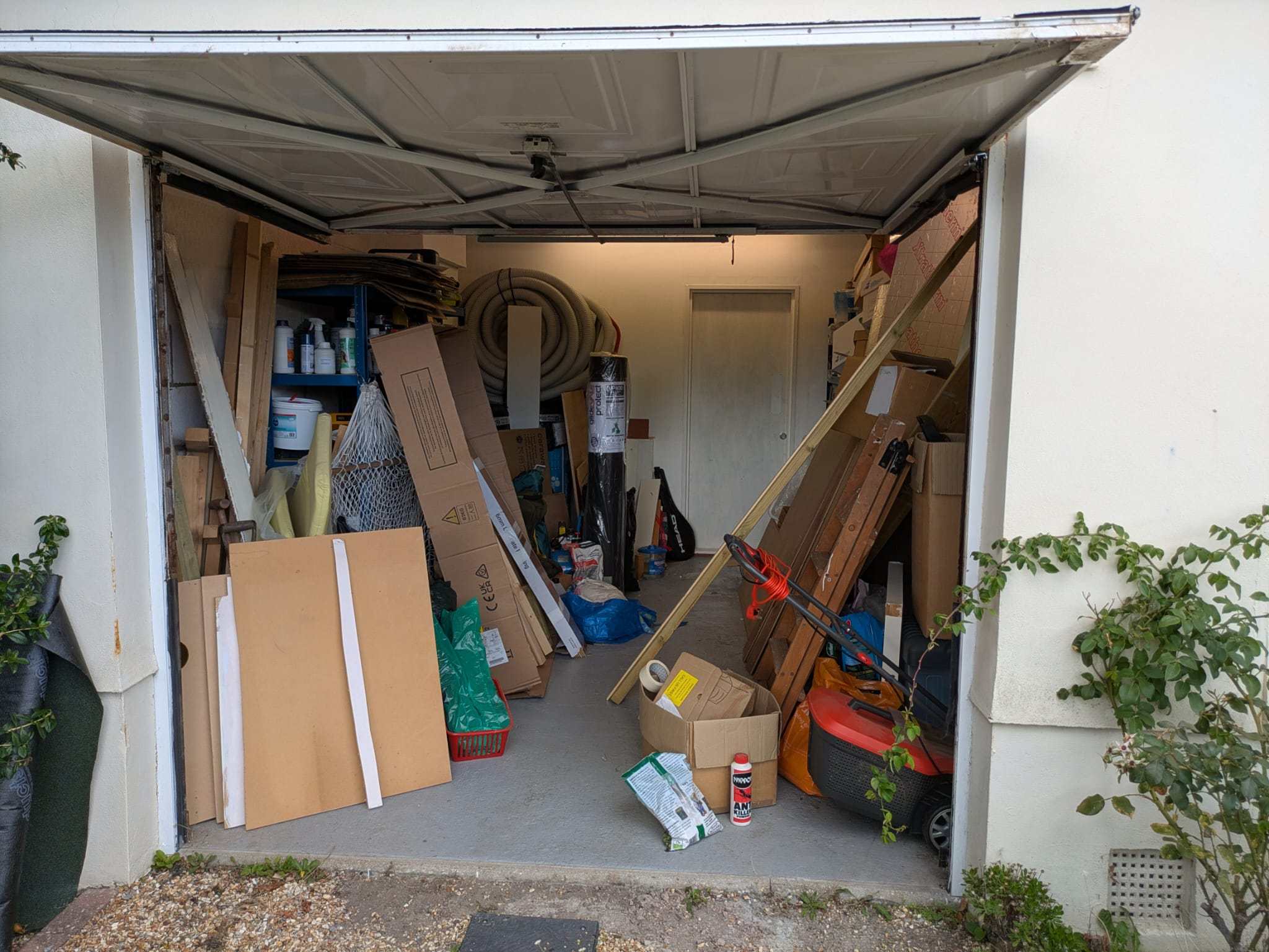

Keeping stuff mould and rust free in integral garage
Quick recap:
  • 300m from sea (south coast)
  • Garage faces the sea
I want to use my garage as a workshop but, having just cleaned mould off a bunch of pine timber (stacked with spacers in between), and selected more MDF to take to the tip as it's mouldy, it's not in a fit state yet.
Normally I'd think "ventilation" but:
  • even with brush strips added the up-and-over garage door is nowhere near draughtproof
  • there's a 12"x12" air brick next to the door
So then I thought "damp":
  • no damp is coming up through the floor - I've done the paper-on-floor check
    • I also painted the floor with single pack garage paint when we moved in
  • but I do wonder if driving rain / general mist and damp air gets in via the air brick and around the garage door
And if damp, salt-laden air gets in and leaves the salt behind, that keeps everything a bit moist.
The metal garage door means big temperature swings inside on sunny days, as it heats up.
My thinking is that replacing the garage door, with a wall and door or anything more airtight, would improve things.
But before I do anything, what's BuildHub's diagnosis? Am I chasing the wrong problem?

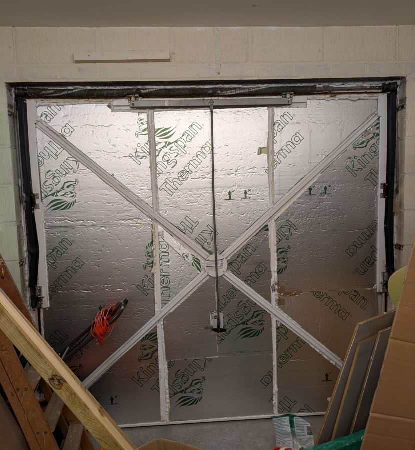

Thanks all, so I either want more or less ventilation, a larger or smaller temperature differential, but we all agree on more insulation :)
To get me through the winter, I think the starting point is sticking PIR on the garage door, and trying to improve how the door seals without jamming it (any ideas?). Then to figure out a longer term solution (conversion or replacement door).
The garage has heated spaces above, to the side and back, and the remaining wall is double skin with partial fill insulation, so this may even reduce heat loss from the rest of the house. We run a dehumidifier in the house from autumn to spring, so if I get the garage airtight enough I'll run another in there.

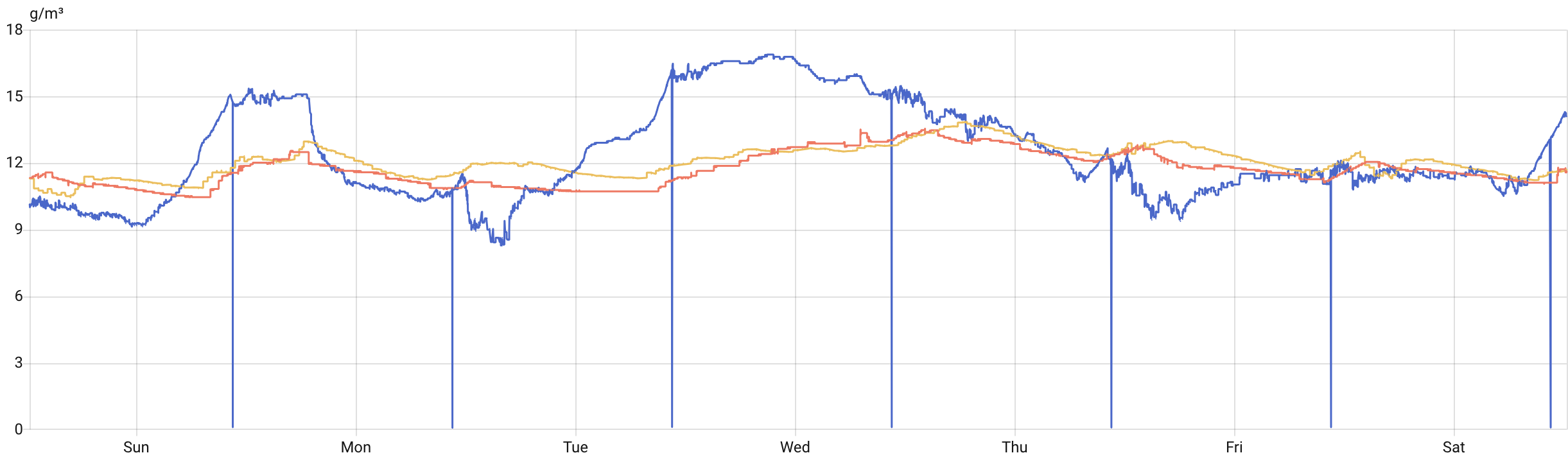

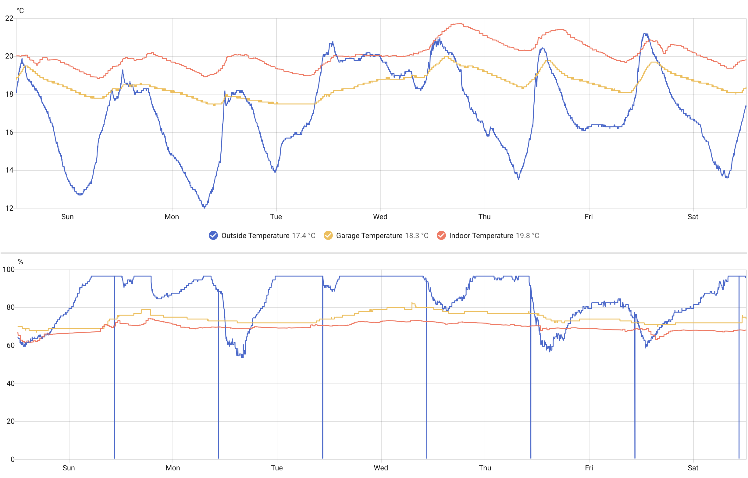

Update: the door is insulated and I've added new EPDM seals to the sides and bottom from Seals Direct, who were very helpful. Foil tape is still to do.
The bottom of the door had an aged weatherstrip which no longer touched the concrete, and there's 15-20mm from the bottom of the door to the somewhat pitted concrete. The EPDM 'D' strip I bought wasn't thick enough, is the goal to get one that compresses into the concrete or is there something (cement? Something from a tube?) that I can use to fill the texture in the concrete so there's a properly smooth surface to seal against?
Top of the door and the frame at the top need a bit of work too - junk in the garage hides the bottom of the door shining across the whole width of the photo, but shine it does:
I haven't got data going back before the day I added the insulation, but I'm pleased with how the temperature and humidity are now performing. This is the past week and it's noticeable going into the garage that we're not getting the heat by afternoon or the cold early morning. Temperature on the top chart, relative humidity below.

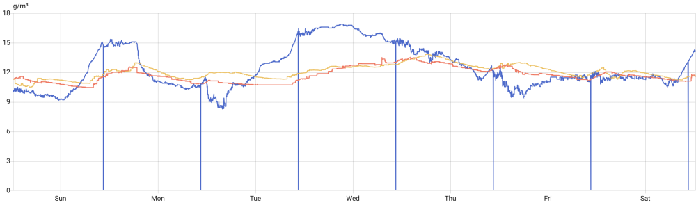

And because I find it useful to track, absolute humidity too
