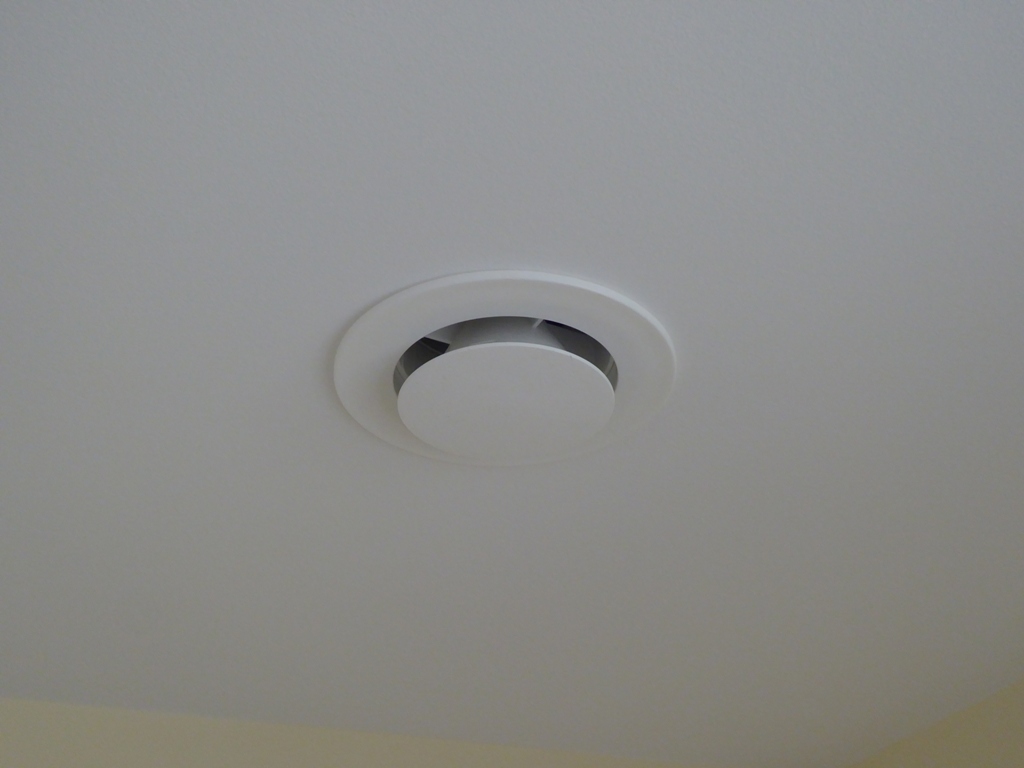

Jeremy Harris Posted February 5, 2018 Share Posted February 5, 2018 Welcome. Using any of the 75mm OD duct systems pretty much locks you in to a limited range of terminals. We used these terminals which are pretty discreet looking and have the advantage that they can be just unplugged by hand and put in the dishwasher to clean them. The rear unit that takes a single duct is this one: https://cvcdirect.myshopify.com/collections/radial-ducting/products/airvalve-90-fitting-92duct-125mm-valve and the terminal that plugs into it is this one: https://cvcdirect.myshopify.com/collections/radial-ducting/products/conus-airvalve-125mm Where we had to fit fresh air vents into a vertical wall, we went for these directional ones, that can be turned to direct the airflow: https://cvcdirect.myshopify.com/collections/radial-ducting/products/turn-airvalve-125mm One consideration is whether you are using the HB+ system where the flow adjustment is at the plenum chamber, using restrictor rings, or one of the other systems where the flow adjustment is at the terminal. The former is quieter, has neater looking pretty flush looking terminals, but is trickier to initially balance and set up, the latter is easier to set up but does mean that you need to be careful when cleaning the adjustable terminals to not upset the set position (and you need to remember where each one has come from so it goes back in the same place!). Link to comment Share on other sites More sharing options...
lizzie Posted February 5, 2018 Share Posted February 5, 2018 Depends a bit on what you want spend really. I have lovely milky glass fittings for my ceiling holes (tech term LOL)but they cost a lot, I figured they were going to be there and visible for a long time so they had to look good. I just couldnt find any others I liked. Various different shapes and sizes available. https://www.fraenkische.com/en/Ventilation/Building-ventilation-for-installers/Systems/profi-air-starline-design-grill/profi-air-starline-design-grill-7228.html Link to comment Share on other sites More sharing options...
Jeremy Harris Posted February 5, 2018 Share Posted February 5, 2018 9 minutes ago, lizzie said: Depends a bit on what you want spend really. I have lovely milky glass fittings for my ceiling holes (tech term LOL)but they cost a lot, I figured they were going to be there and visible for a long time so they had to look good. I just couldnt find any others I liked. Various different shapes and sizes available. https://www.fraenkische.com/en/Ventilation/Building-ventilation-for-installers/Systems/profi-air-starline-design-grill/profi-air-starline-design-grill-7228.html Are they adjustable to balance the system, though, or do you have to adapt them to fit a system that has balancing valves/restrictors fitted elsewhere? I spent a fair bit of time looking around and found a fair bit of incompatibility between different manufacturers fittings, which could be tricky to get a work around for. I found that all our ducts needed some form of flow regulation to get the rates to comply with the regs and to ensure that the MVHR worked at best efficiency, and it was a pretty tedious task! Link to comment Share on other sites More sharing options...
lizzie Posted February 5, 2018 Share Posted February 5, 2018 We have the Robbens Frankishe system and they are part of that although they will fit the same size pipes on any system. We have some flow things behind them inside the pipes that regulate the air. These covers are so easy to take on and off they are magnetic just pull on and off really well for easy access and cleaning we also have filters behind the covers on the intakes. Thats about the extent of my technical knowledge sorry! Link to comment Share on other sites More sharing options...
Jeremy Harris Posted February 5, 2018 Share Posted February 5, 2018 54 minutes ago, lizzie said: We have the Robbens Frankishe system and they are part of that although they will fit the same size pipes on any system. We have some flow things behind them inside the pipes that regulate the air. These covers are so easy to take on and off they are magnetic just pull on and off really well for easy access and cleaning we also have filters behind the covers on the intakes. Thats about the extent of my technical knowledge sorry! Sounds like a neat solution. Most of the flow adjustment systems are either clunky (like running around changing restrictor plates) or mean screwing the actual terminal in and out on the thread, so they all end up looking slightly different if there's a lot of adjustment. For a budget solution I think it's hard to beat the ones I linked to, as they are very unobtrusive, especially as so few people gaze up at the ceiling all the time, where 90% of them are fitted. Here's a view of one in the corner of one of our rooms, The outer ring that sits flush with the ceiling is around 150mm diameter: 4 Link to comment Share on other sites More sharing options...

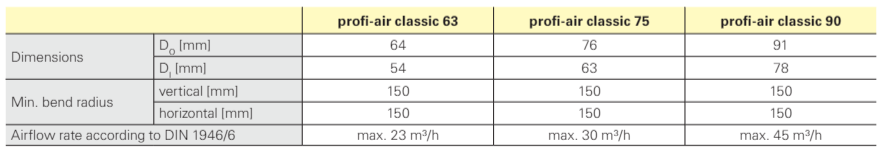

Adsibob Posted February 5, 2021 Share Posted February 5, 2021 On 05/02/2018 at 17:52, lizzie said: We have the Robbens Frankishe system and they are part of that although they will fit the same size pipes on any system. We have some flow things behind them inside the pipes that regulate the air. These covers are so easy to take on and off they are magnetic just pull on and off really well for easy access and cleaning we also have filters behind the covers on the intakes. Thats about the extent of my technical knowledge sorry! I'm interested in the Robbens Frankishe terminals that @lizzie has, as I think they will work really well with our interior decor in some rooms. I see from their website that these pretty terminals are compatible with the following size radial ducts: I think the difference between those two diameters must be internal and external diameters, but that would mean the duct is between 10mm and 13mm thick. My question is what airflow rate do I need? Or will i need different sizes for different rooms given it depends on the volume of the room it is extracting or supplying from? Maybe it's a silly question, but I note that airflow rate is hardly mentioned when choosing ducting, only when discussing the actual MVHR unit - surely the airflow of the ducts is just as important? Link to comment Share on other sites More sharing options...
dpmiller Posted February 5, 2021 Share Posted February 5, 2021 generally one 75mm duct will flow enough to the average room, running two ducts to each plenum offers increased flow or reduced noise, as required. Link to comment Share on other sites More sharing options...
