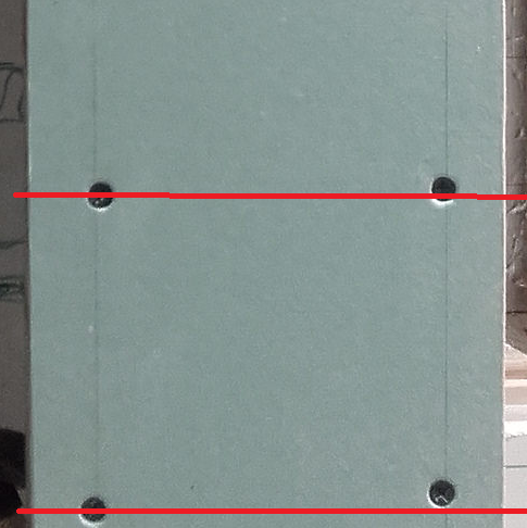

Onoff Posted February 13, 2018 Posted February 13, 2018 21 minutes ago, Nickfromwales said: Clive....some of those screws are a few mm difference on centres. Best take them out and do it agin I think. Don't want standards slipping eh? PS, what length are those screws ? I'll try and do better on the bit underneath! 41mm..'coz they were CHEAP in Lidl. Got boxes of 'em. 1

Construction Channel Posted February 13, 2018 Posted February 13, 2018 8 minutes ago, Onoff said: Another glass and I'm getting into this: Now the ceiling screws look too far apart.
Onoff Posted February 13, 2018 Posted February 13, 2018 9 minutes ago, Construction Channel said: Now the ceiling screws look too far apart. Yeah, I've slowly come round to the @Nickfromwales idea that more is better and screws are cheap. I'm doing 100mm centres now. Can always add more!
PeterW Posted February 13, 2018 Posted February 13, 2018 2 minutes ago, Onoff said: Yeah, I've slowly come round to the @Nickfromwales idea that more is better and screws are cheap. I'm doing 100mm centres now. Can always add more! No that’s the centres for ordinary boards - you’re using MR board and it’s 87.5mm centres unless you use screws longer than 40mm where you can go to 112.5mm.... 1
nod Posted February 13, 2018 Posted February 13, 2018 34 minutes ago, Construction Channel said: Now the ceiling screws look too far apart. 150 centres will hold any board Just be careful not to sink your screws in to far Exspecially on ceiling They will pop when wet 1 mil into the paper is fine 1
nod Posted February 13, 2018 Posted February 13, 2018 40 minutes ago, Construction Channel said: Now the ceiling screws look too far apart. I’ve just noticed the plain board It looks like machine gun fire No need to put so many in Definately ajust your depth

jamiehamy Posted February 13, 2018 Posted February 13, 2018 48 minutes ago, Construction Channel said: Now the ceiling screws look too far apart. Lucky he doesn't have @curlewhouse 's BCO - instant fail 1 2
PeterW Posted February 13, 2018 Posted February 13, 2018 @jamiehamy don’t look too close - he’s not even making all the crosses in the heads in line with each other.... 1
Onoff Posted February 13, 2018 Posted February 13, 2018 Barstewards the lot of you! 42 minutes ago, PeterW said: No that’s the centres for ordinary boards - you’re using MR board and it’s 87.5mm centres unless you use screws longer than 40mm where you can go to 112.5mm.... Don't jest, I'm new at this. I'll blindly do as I'm told like @recoveringacademic! 3
Onoff Posted February 13, 2018 Posted February 13, 2018 17 minutes ago, nod said: I’ve just noticed the plain board It looks like machine gun fire No need to put so many in Definately ajust your depth Cheers. You wait until I start trying to plaster, you'll feel like @Nickfromwales when I ask about plumbing!
nod Posted February 13, 2018 Posted February 13, 2018 20 minutes ago, Onoff said: Barstewards the lot of you! Don't jest, I'm new at this. I'll blindly do as I'm told like @recoveringacademic! They will be fine Just watch the depth
