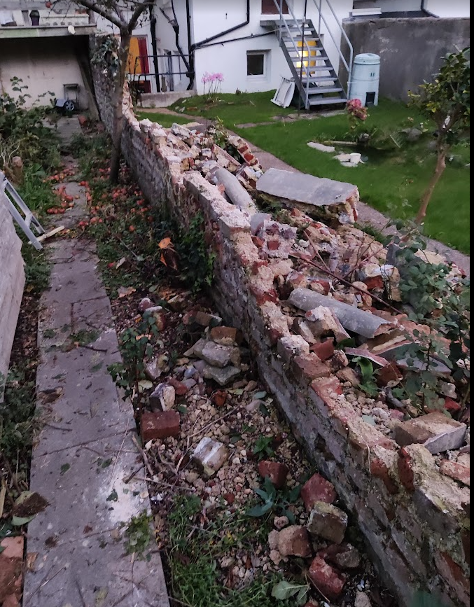

This old garden wall had ivy growing in / on it.  It did not do it much good!
+1 for not ivy, there are plenty of less problematic alternatives. I'm still trying to remove one the previous owner planted and it's relentless.

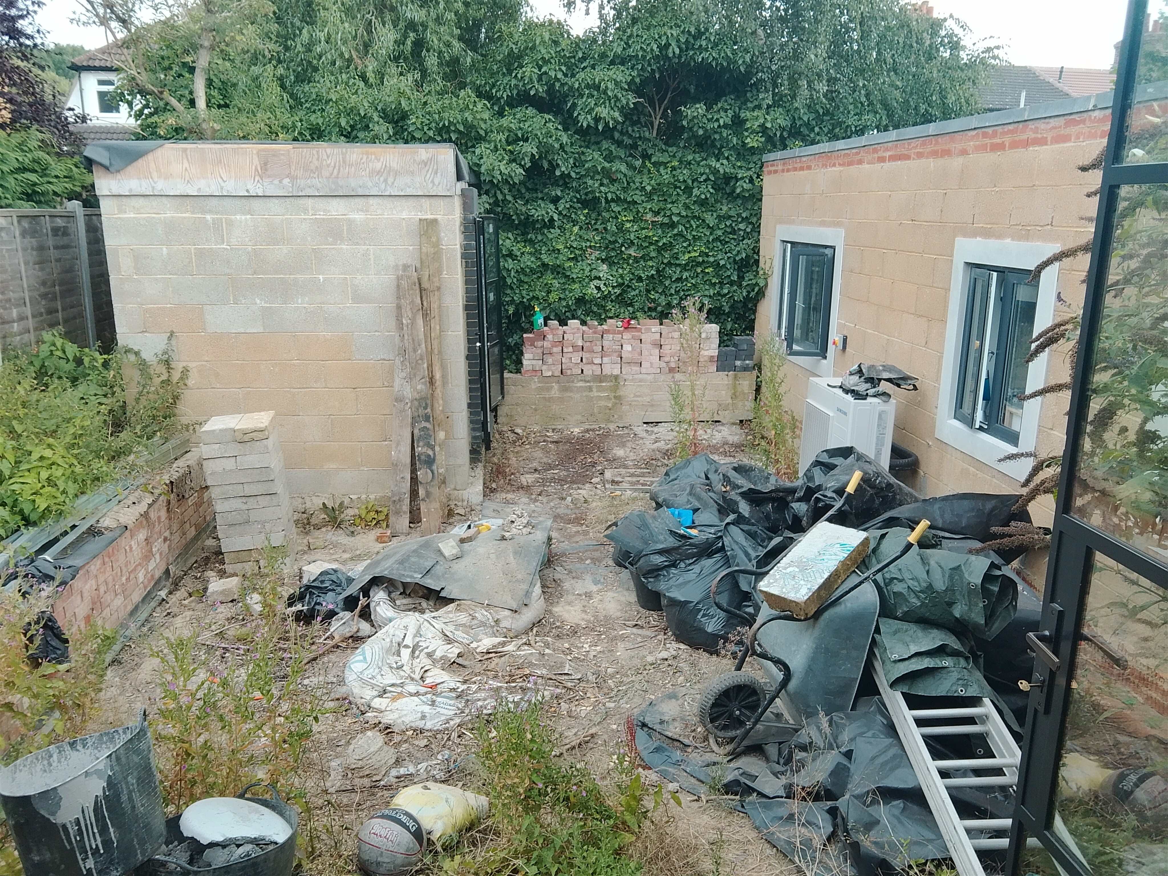

For context, this is the courtyard garden of my SB. The wall on the right is the one I am thinking of treating with the paint, mesh, and ivy. You can see that I've rendered around the windows so that the areas the mesh will not cover are presentable.
See you have an ASHP, that will be taken over by the ivy the first couple of months not trimming it back.
Any plants up the wall will have to cut back hard from time to time, you need your walls to look finished otherwise it will all look a mess.

I was going to build an enclosure around the ASHP and paint the walls black before applying the protective paint. One reason for thinking about ivy is that it gives such good coverage that the wall would barely be seen anyway. That's why I haven't rendered it.
That will be a big enclosure of all closed sides. Open sides makes maintenance even harder. My ASHP requires a metre either side and 500mm above, so you boxing in, looks like it would be across the windows.

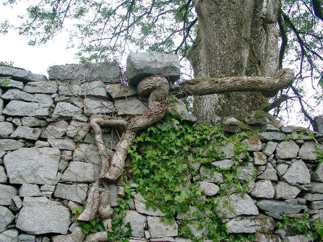

look at the picture it got under neath a top wall stone --which weighs approx 150kg  and just moved it  out of the way -- it could have grown over it --but didn,t
it then bridged the gap to the tree approx 10inches and then grew up the tree another 40ft
and pushed the other top stones off the wall
you can see where i cut it in many places main ivy will be approx 6inches in dia
there was a gap under the trunk and stone was in mid air before i chopped
you really want something with that strength growing into your wall
