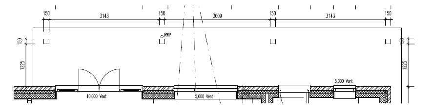

I need some beams under a loggia (veranda) with 3.1m spans. The drawing calls for 2no. 8x2 but I'm tempted to go with a Glulam instead for the following reasons:
  • Normal tanalised timber will twist / cup / bow as it dries. The two timbers being joined together would help that but still
  • The total length of the beam is almost 10m including its bearings (atop 150x150 oak posts) so there will need to be joins between sections if done in normal timber. I can have a single length of glulam.

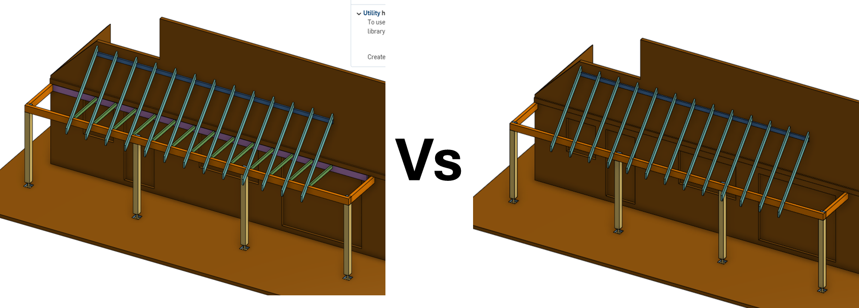

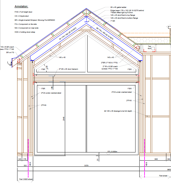

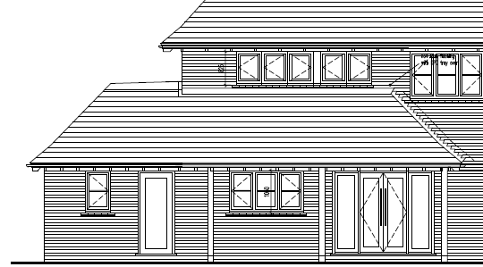

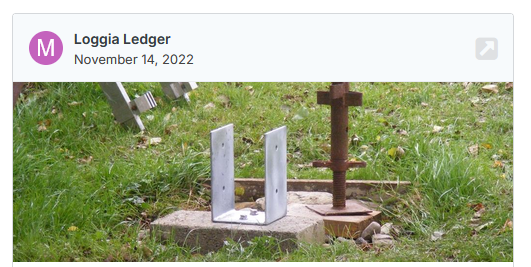

On 06/08/2026 at 07:06, MortarThePoint said:
Sorry, I should have shared more context and the other thread about the loggia which you have kindly contributed to. My last query there was whether I needed ceiling level ties to constrain the main beams laterally or whether the bracketry would achieve that on its own.
Hiya.
The base brackets you show act as pins, they are just intended to carry vertical load only. They do have a minimal shear load capacity, but it is minimal. That (shear) is the load horizontal to the plane of the ground surface. The brackets you show are of minimal strength.
To stop it moving sideways there are a number of different options. We can do a flat portal type of frame, often with knee braces. But this is going to introduce shear load into the brackets you show, they are not big enough and likely neither are the pads they rest on by the looks of things. The pads might be able to carry vertical load but not horizontal loading.
Or you can fit a stiff floor and roof. These then act as a diaphragm and transfer the sideways loads back to the main house. But you have to check the main house can carry this extra load.
To give you a better answer, with more explanation on how it works, need to see cross section drawings and a bit more of the house you are going to add load to if you use the diaphragm method.

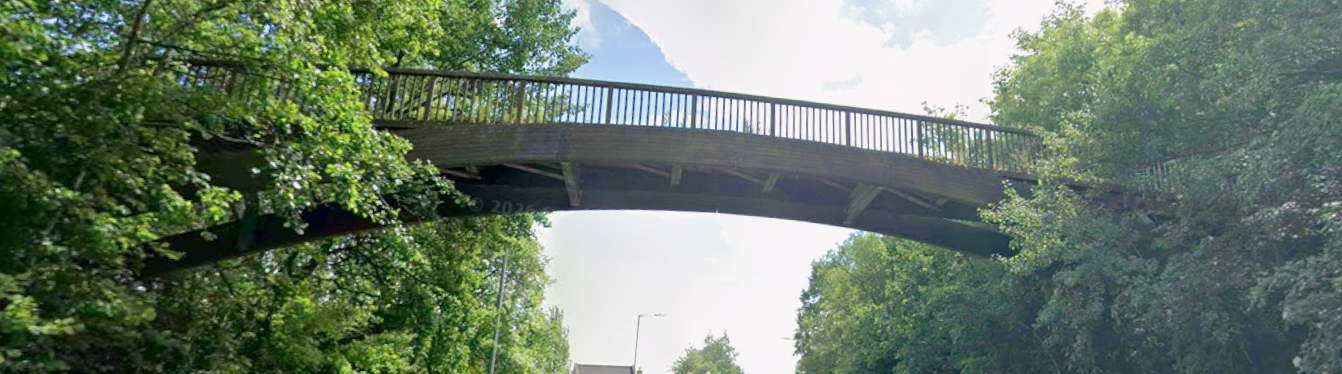

Here is a bridge near where I live.
The photo, near where I live is not that good of a laminated bridge. There are bolts going down from the top to the bottom of the beam. These transfer the shear loads between the laminations. Glue is more efficient.
On another thread I has detailed changing to using Staddle Stones and my rough calculations there suggest a lateral force capacity at the bottom of the post of at least 80kg (without pin and resin into concrete below stone) and I'd expect much more (with pin and resin into concrete).
The main structural question I am struggling with is whether I need ceiling level timber ties back to the house structure. I'd consider the coupling between the post and the staddle stone to be free to rotate, so just providing lateral and vertical constraint but not rotary.

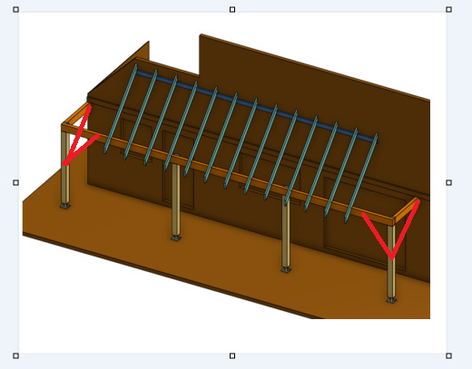

Technically you don't need ceiling ties if the roof is made stiff, like a big deep beam. This can be achieved by using say OSB / Ply / traditional timber sarking to the tops of the rafters. Lining the underside with ply makes it even stiffer.
In the round we want to:
1/ Stop the front of the logia moving sideways parallel to the main house wall. We can do this by making the roof stiff and connecting it back to the main house wall so the main house wall resists the basic sideways shear, but also what we call complimentary shear. Here is quick diagram I copied from the internet. You can test this at home using a cardboard box with one side cut away. If you want to understand what's going on try it yourself for a bit of fun. Tape the box down to a table in different places and experiment, you can learn a huge amount about structural behaviour by just having a glass of wine and mucking about.
2/ The front of the logia moving away from the main house wall, perpendicular movement.
The main thing here is to check the house can take these extra loads. Often you'll find that the external leaf, particularly masonry protests a lot if it is pulled outwards between the floor levels.
I think the best thing, and most probably less hassle is to allow the house to carry half the vertical loads roof, they will be small as any snow, snow drift or snow falling off the main house roof will just slide of as the roof is steep. Normally we design for a roof access load, this get reduced when the roof is steep.
Then look to see if it works along the front / sides Architecturally  with a knee braces shown in red. The base of the columns would have some beefy 6.0mm thick or so fabricated brackets. The corner columns well attached to say 600 x 600 x 600 deep concrete pad foundations.
I'll not explain here how / where the forces go in detail. But if you are thinking about laminating timbers up yourself it could be great fun to do and cost effective. The vaulting with no ceiling ties is attractive Architecturally to me.
Try the cardboard box thing! if you can live with knee braces then it's a very efficient way of doing it. Let us know your thought on the braces.
