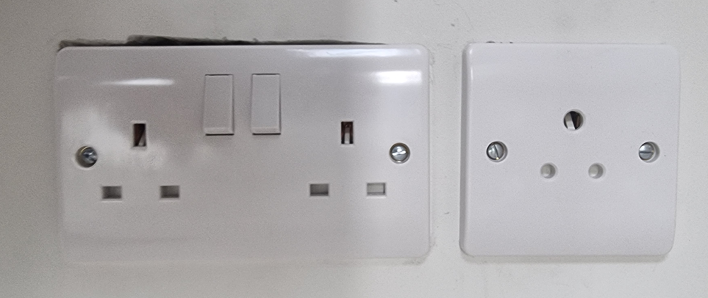

Plugs and plaster
What's the best way to fix this?
Time machine?
A dozen or so sockets are like this.  😕

This is down to detail.
Is this "plaster on the hard" or plasterboard?
If plaster to brick or block the back boxes need to be well fitted and deep enough to reach almost the finished level of the plaster.  If too deep the spread has to do his best forming an edge in free space.  One of the reasons I hate plaster direct to brick or block.
If you don't want surrounds as suggested above, you need to build up the gaps and form a corner with a good quality ready mixed plaster.
If you haven't decorated yet and it's something you plan to sub out then I expect many decorators will be used to doing this work and it might not be a huge deal just to get them to do the filling.
For future reference, these are a fantastic way of getting around bad edges. Several on the market, but these 'skim over' ones are loved by the plasterers I've fitted them with. As they can just go straight over. They even make downlighters ones

Lift the 5a one as much as possible, then same for the socket to see if you can hide this.

The ‘fix’ is to remove the outlets, PVA the openings, apply EasiFill and allow to dry fully, then sand and paint, then, repeat if necessary, and paint.

Where the backbox is deeper than the surface of the plaster, then what's the best way to fill out to a corner? 🤔  Insert a blank of some kind, or just do multi-layers?
potentially use a 2 gang socket extension to bring out the metal work form the backbox that you use to fill into and upto, then remove when all filler is dried.

Yes, the extenders are the way forward.  Shame they were not fitted pre-plaster, but at least it gives something to fill to.

So the filler won't stick to the extender?
Yes you will fill the gap between the rough edge and the extender.
The other way is just to fill proud i.e. across over the edge of the metal box. Then when it has dried use a stanley knife or utility knife to cut the excess filler off along the line of the metal box.
