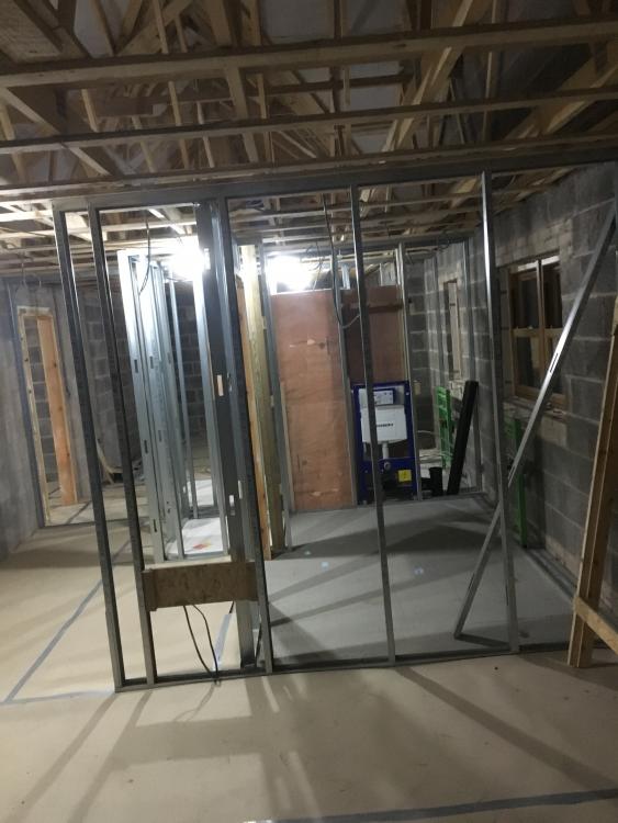

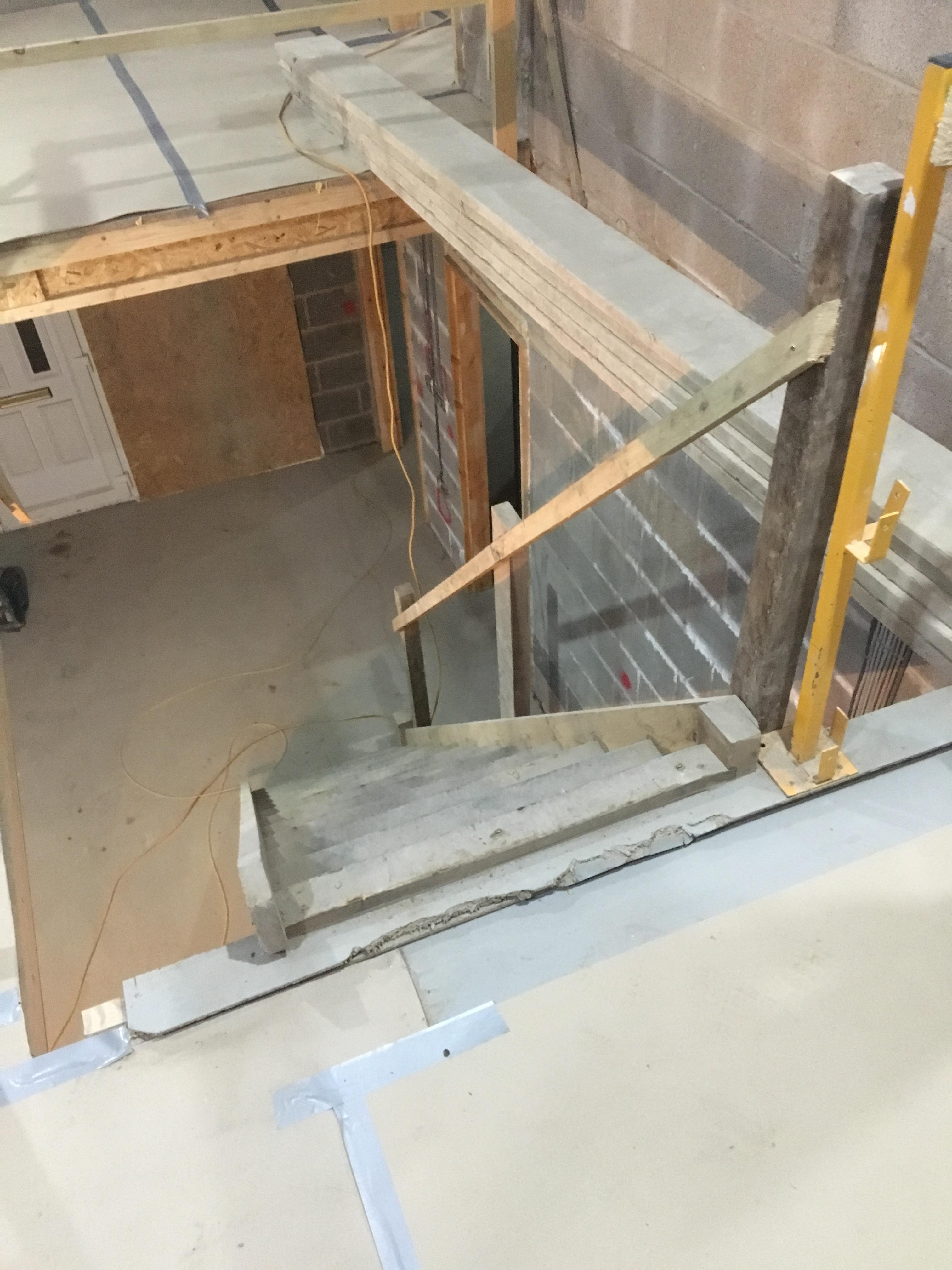

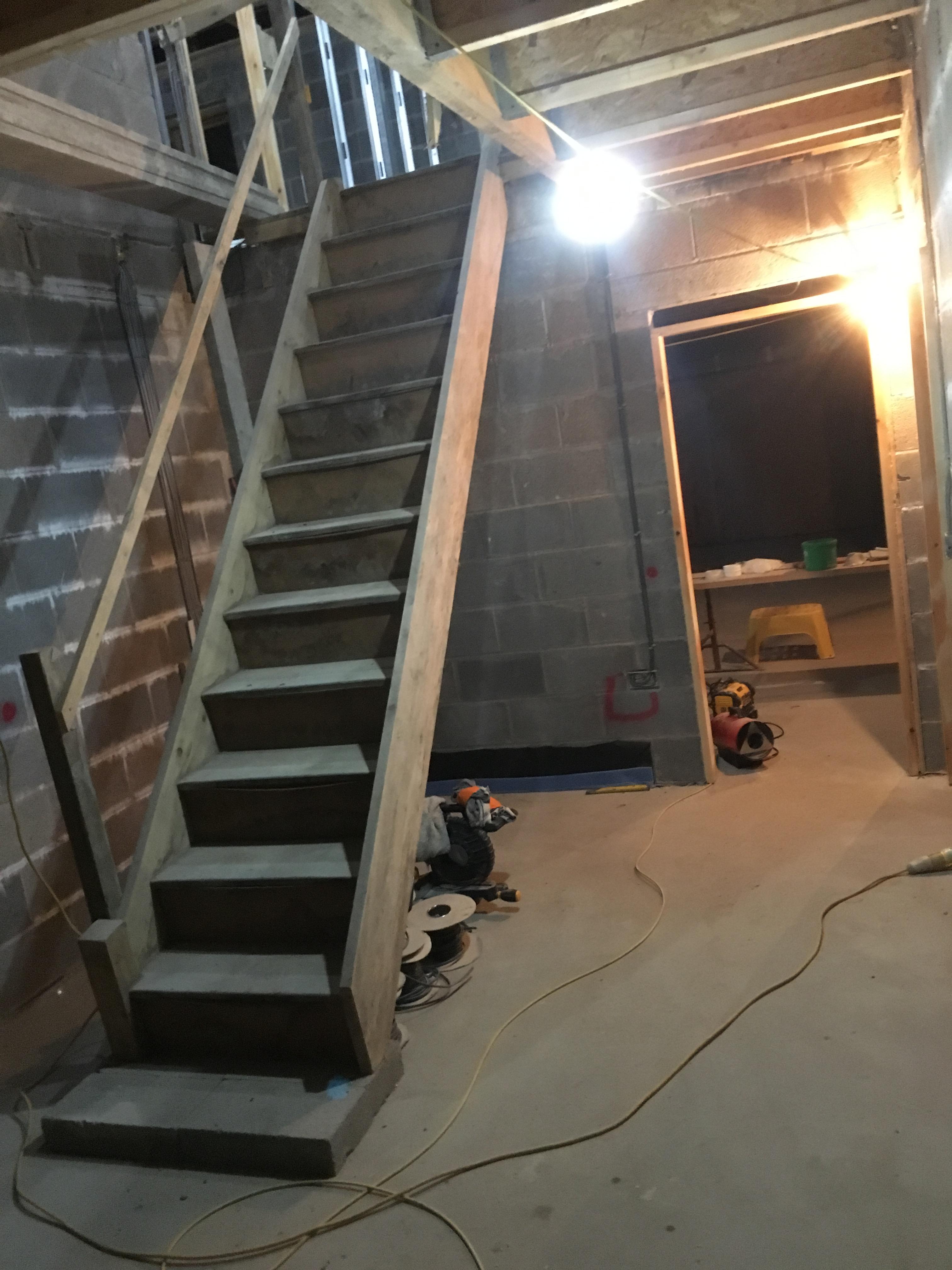

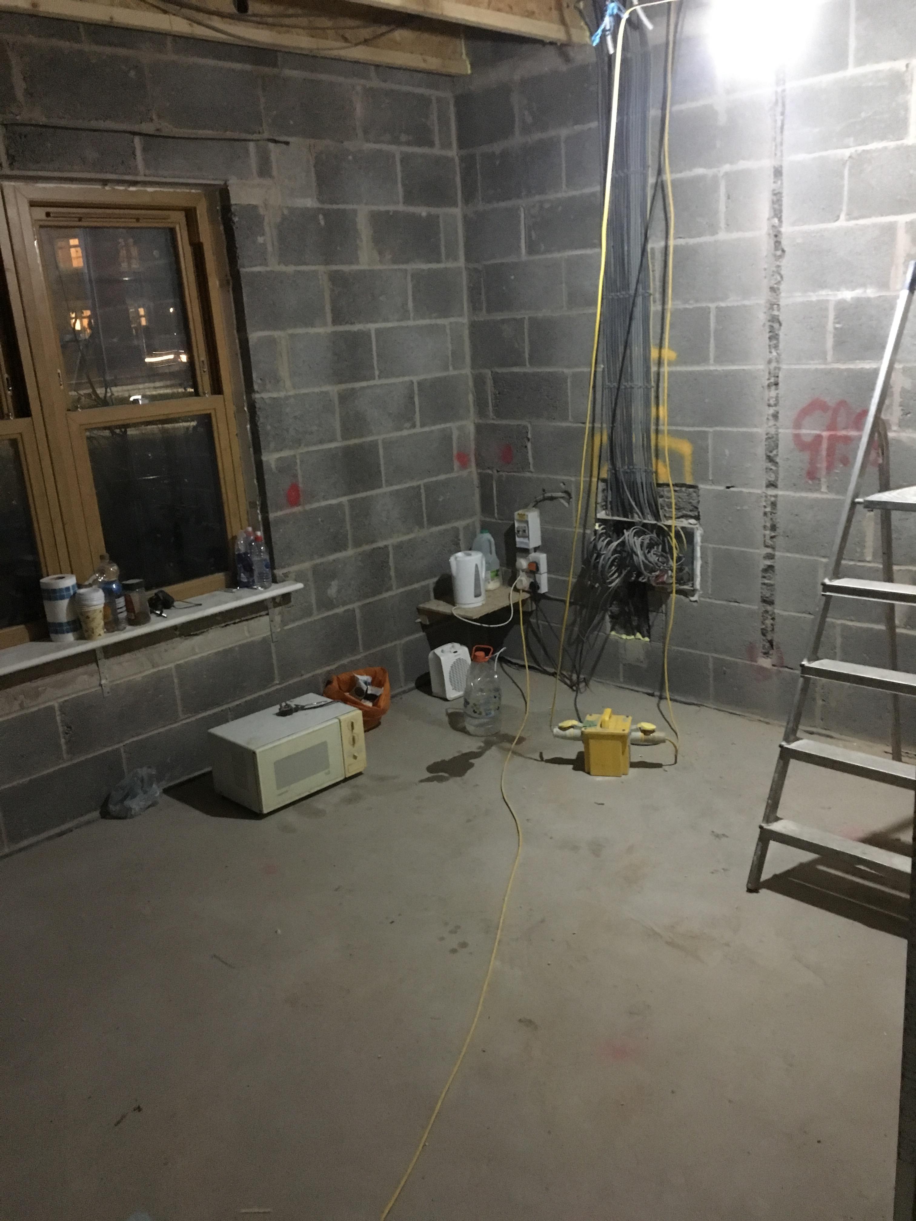

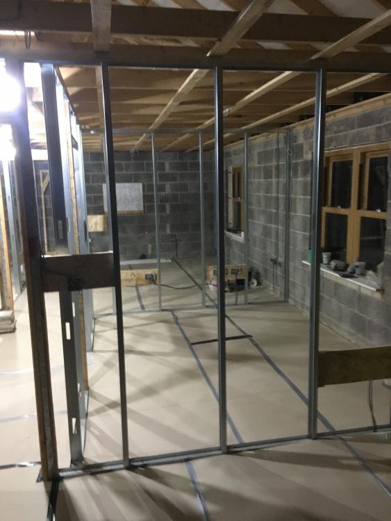

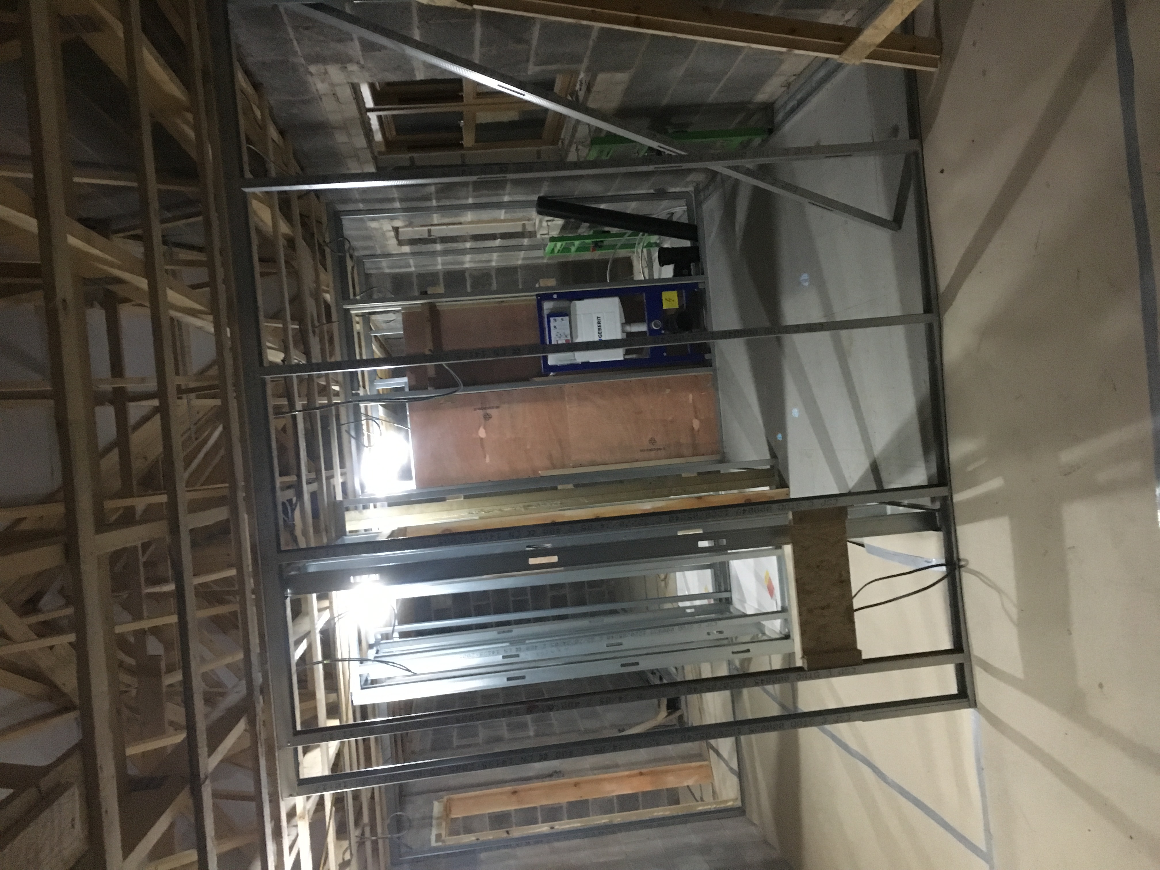

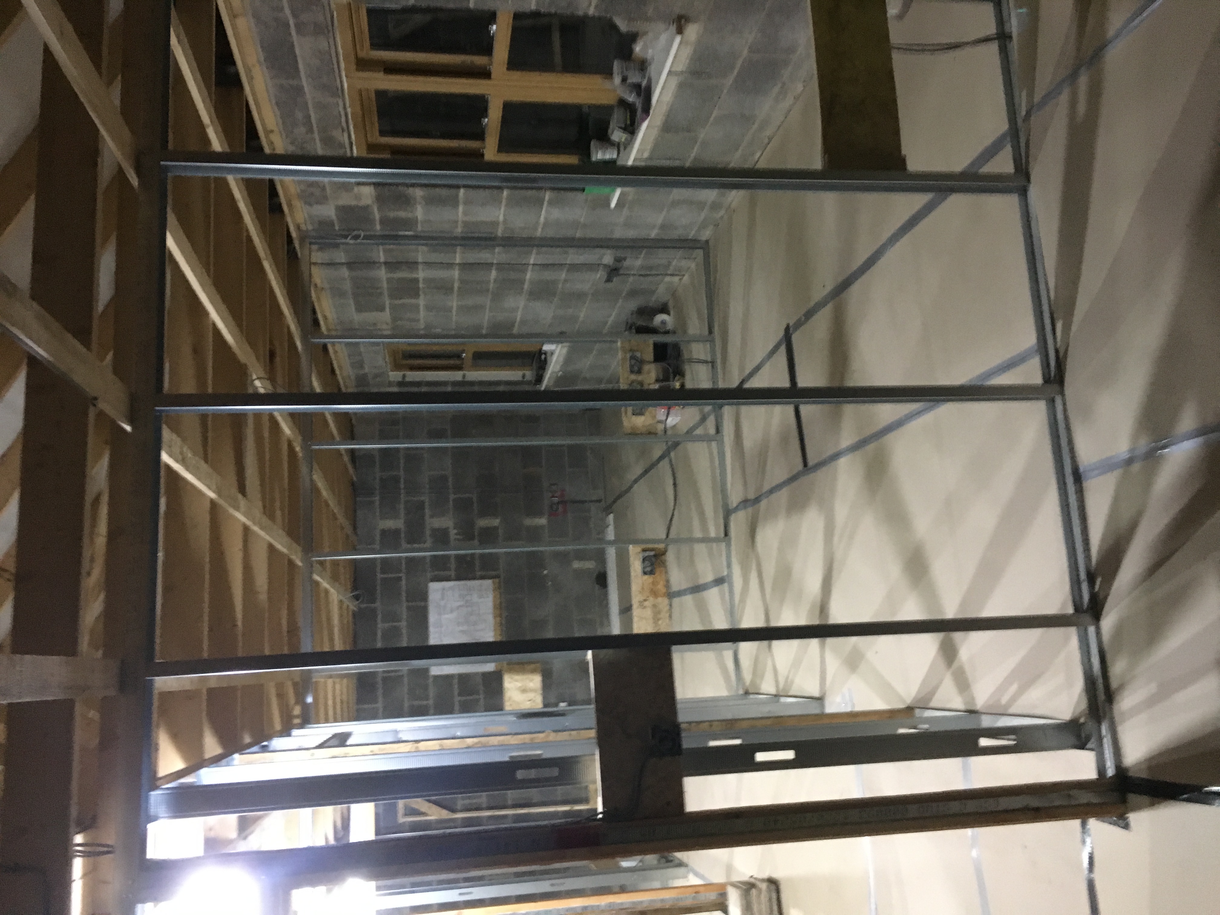

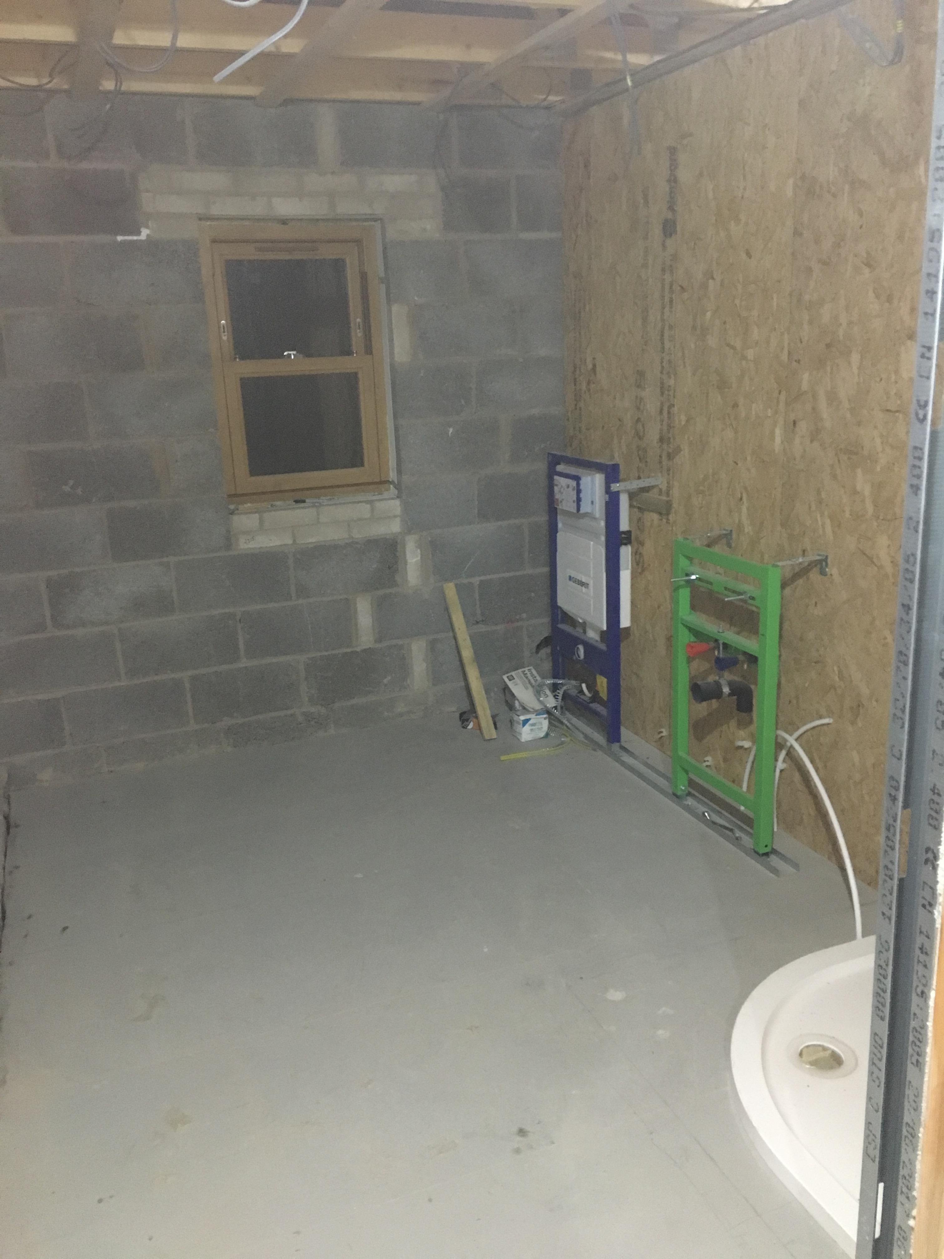

nod Posted February 3, 2018 Author Posted February 3, 2018 Thank you for your replies ive just walked in after another long day at the plot Unfortunately like many on here we are doing virtually all the work ourselfs whilst we are both working full time through the week This demand was the last thing we needed The letter stated that while they had taken note of what we had told them The inspected had deemed the property habitable Therefore Liable for counsel tax Please take a look at the pictures that I’ve taken an hour ago
Declan52 Posted February 3, 2018 Posted February 3, 2018 Definitely habitable for mice but for anyone else that would be no. Can you contact them and ask what exactly made him think it was habitable. 1
PeterW Posted February 3, 2018 Posted February 3, 2018 I’d start with asking who inspected it, on what day and at what time and who authorised them to enter the site - in a very strongly worded letter ..! And then send the photos ..!
Jeremy Harris Posted February 3, 2018 Posted February 3, 2018 I'd advise contacting them ASAP, with a list of points as to why it does not meet the rateable hereditament tests in the case law quoted in the links in this post: If you're methodical you should have no problem in making the case that it does not meet the legal requirements, but I suspect you will be dealing with people who are inflexible and not particularly well-versed in the law. Certainly the first person I spoke to at the council was pretty aggressive and bullying, and passed me on to her manager. The manager didn't understand the law at all, and I managed to get her to refer my points to their legal department, and quoted the relevant items of case law. The moment their legal eagle was made aware that there was no potable water on site, the whole thing just went away, with a request that I call them when the house met the legal requirements to be habitable. They will try it on, as these people have learned that being bullying and aggressive, with the authority of the council, makes most people back away. The hardest part for me was staying calm and civil when dealing with them, as I was steaming mad. I can clearly remember being on the phone to them at the top of our lane (there's no signal at the house), finishing the calm conversation with one of the morons and then shouting and swearing with pent up rage. The lady walking her dog that passed me at that moment just smiled at me and said "was that telephone call a little tiresome?". Calmed me down better than a bottle or two of wine......... 2 2
nod Posted February 3, 2018 Author Posted February 3, 2018 Thank you again i was going to get the water connected next month but I’m glad I didn’t If I was to get the water on Would that leave me vonuable In view of what has happened It's pretty obvious that there is no water on as we have a 10 mtr coil of alkathene just outside the site gate we are not there midweek and the site is Locked and fenced off Very unlikely that anyone has been upto the windows Let alone in there Thank you again It’s nice to have the forum to have a good moan and receive a sympathetic response My wife Deborah is very upset I pretending I’m not to bothered and a quick email will get things sorted out I think that I need to get someone down to inspect the the house Rather than just drive by
Jeremy Harris Posted February 3, 2018 Posted February 3, 2018 Point out there is no water supply connected, ask them to check with the water company if they don't believe you, and quote the relevant bit of case law that says that a building without a water supply cannot be lawfully classed as a rateable hereditament. I'd delay getting the water connected if you can, until you've resolved this. If you agree to notify them when you feel that you've met the requirements for habitability, then the chances are you may get the same reaction I did. They backed right off when I did this, we had no more snoopers coming around, and they didn't even use the statutory powers they have to issue us with a notice of intended completion date. I think they thought that I was likely to give them pain and grief (which was spot on) if they tried to get us to pay up before we were ready, so just backed off. A few weeks after completion I wrote a letter to the VOA, requesting that our new build be valued and put on the register. If you want to delay things further, you can, as you can appeal the banding, and that adds a few weeks delay. The Council cannot charge you Council Tax until the VOA have put the house on the register. My guess is that your house has been put on the Council Tax register now and that the VOA have done the external inspection (done from the roadside, or even just the plans). You need to get it off the register ASAP, by highlighting that it is is on there by error with the VOA (not the council). No building that is not a rateable hereditament should be on the register, as by definition the register only holds details of buildings that are - it goes back to the old Rating Act again. 1
